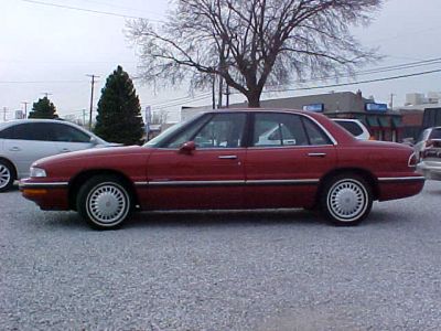

JAMIEFREEBUICK
  • 1998 BUICK LESABRE
  • 6 CYL
  • FWD
  • 82,000 MILES
I dont no wats wrong wiht my car it is a 98 buick lesabre costom the battery is good but wont start and autozone said its the starer or a solenod but i dont no for sure
https://www.2carpros.com/forum/automotive_pictures/276765_buick_1.jpg
Thursday, August 6th, 2020 AT 9:36 AM (Merged)
  • 109,747 POSTS
Hi:
What happens when you turn the key? Do you hear a click?
