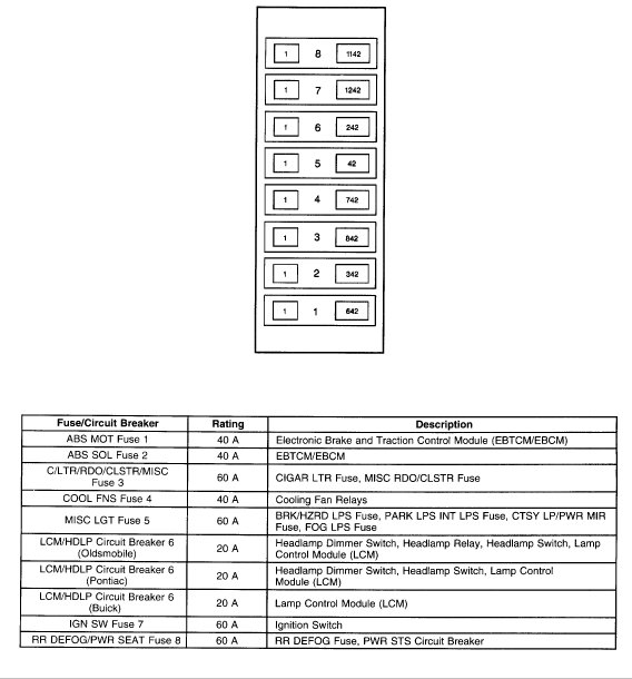

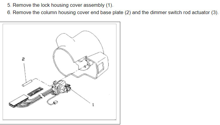

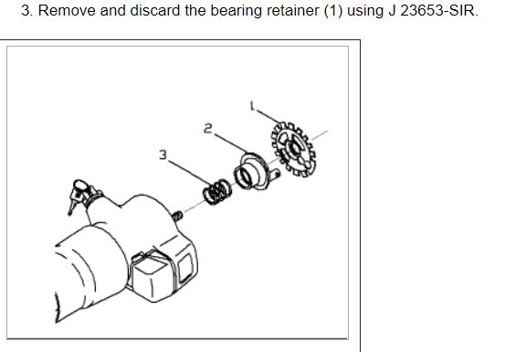

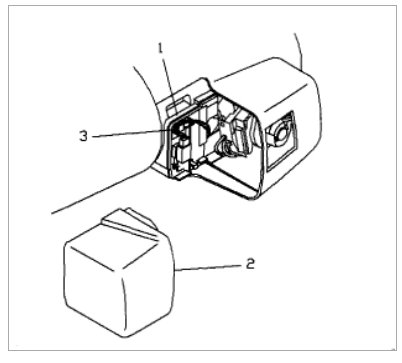

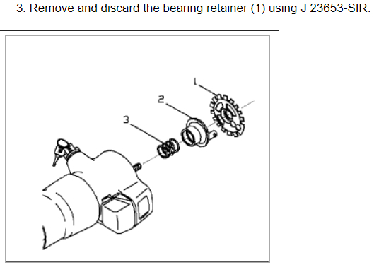

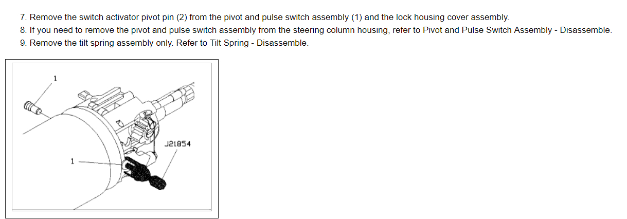

HMAC300
  • 48,601 POSTS

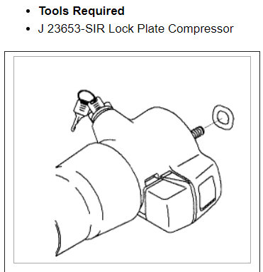

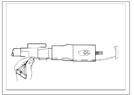

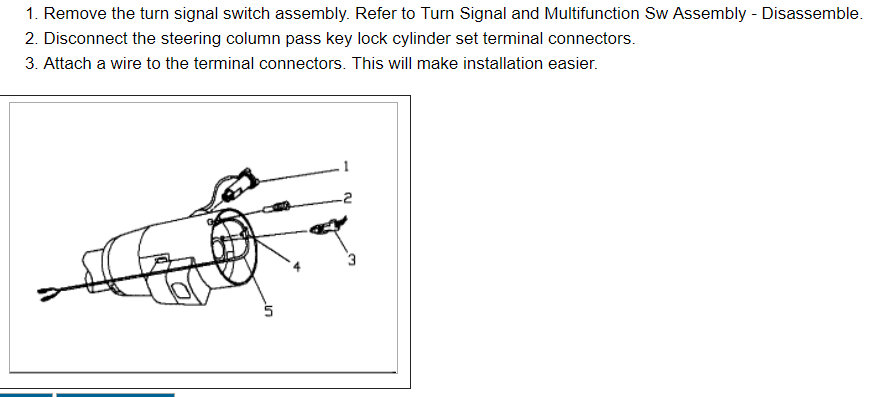

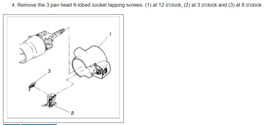

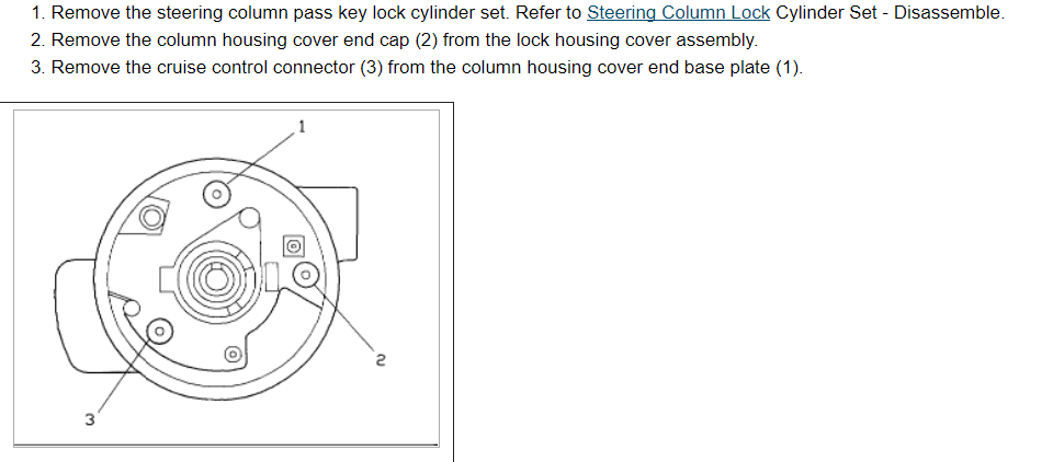

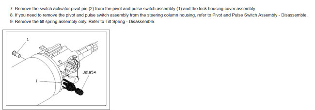

These cars had a problem with two small wires at the ignition switch that break and need to be fixed for the starter to work here are guides to help you fix the problem.
Check out the diagrams (Below). Let us know what happens and please upload pictures or videos of the problem.

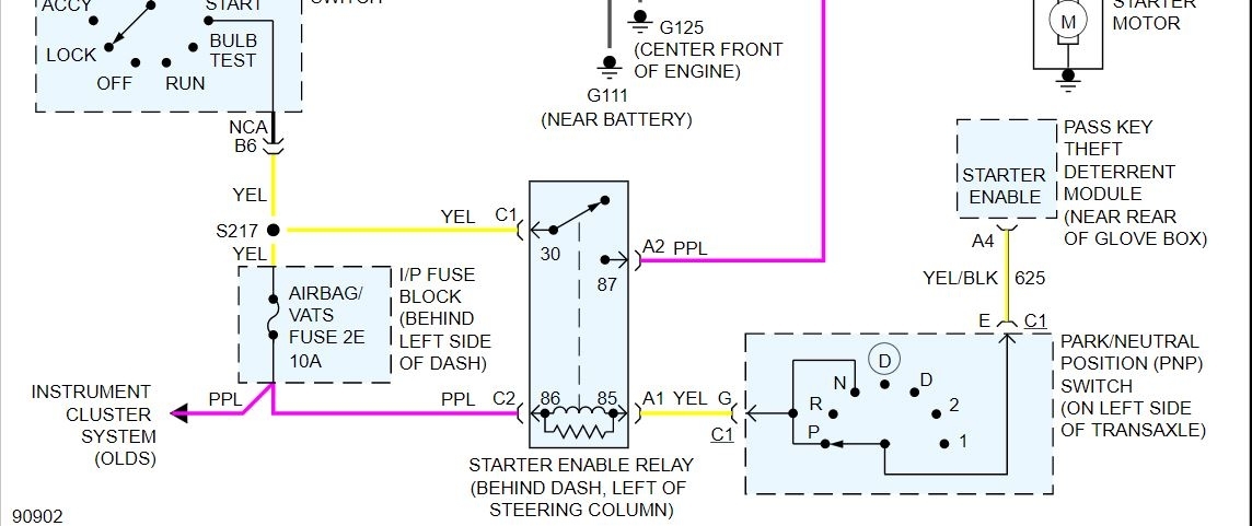

LILGUY23
Car was working fine but I wanted to change the brake pads. I then tried to start the car and it wouldn't start. Cleaned the battery cables, checked all fuses, checked battery voltage, and the neutral start switch is fine. Fuel pump will run for 15 seconds. Decided to replace the starter. Starter will crank when you jump it at the starter, car still won't start. Installed reader and no codes show up. I suspect it's one of the relays under the firewall, but I don't know which one as I can't find a schematic that shows what they are. Any help would be much appreciated. Thank you.
Aug 6, 2020 at 2:35 AM (Merged)

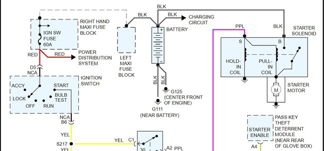

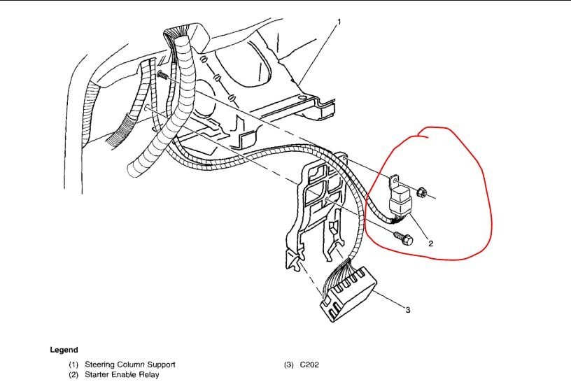

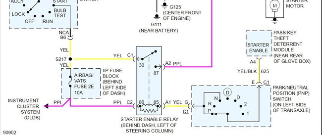

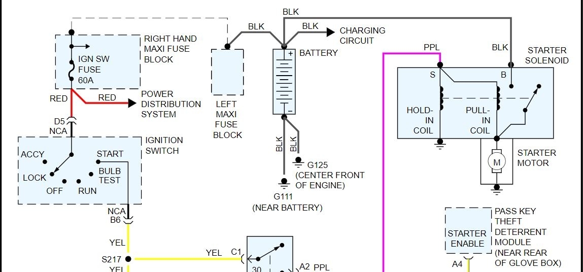

  • 110,248 POSTS
Welcome to 2CarPros.
First, I attached the entire starting system schematic for you. I had to cut it into two parts so it was readable, but I did overlap them so you could follow it. Also, there is a starter enable relay under the dash that should be checked. Picture 3 shows what I am referring to.
Here is a link that explains how to test a relay. I noted you are a mechanic, but thought it may be helpful.

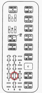

Check the voltage on both sides at INJECTOR fuse #7, 10amp in the dash fuse box.
TERRYS10
  • 6 POSTS
There are 2 - #7 fuses in my dash box; 1 is 7D which is labeled '10A TCC' and the other is 7E labeled '10A NON-OBDII MISC ENGINE' (no fuses in 7A - 7C).
I measured 12 volts on both sides of both fuses.
Oh, thank you by the way.
WRENCHTECH
  • 20,758 POSTS
I think your in the wrong box It's right here
https://images.2carpros.com/forum/automotive_pictures/561653_Fuse_box_98_Lesabre_1.jpg
TERRYS10
  • 6 POSTS
Man, they could have made that fuse box harder to find.
I measured 12 VDC on both sides.
