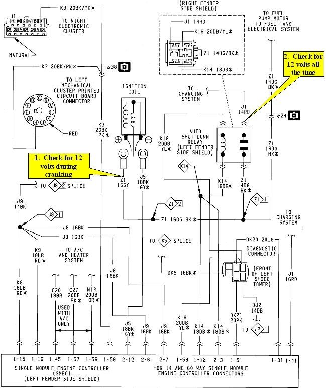

Hi, I have the car listed above premium coupe with the 2.5l non turbo. my car won't start unless I jumper the positive side of the coil to the positive side of the battery. But the fuel pump also is running all the time if I do that. Had the car running but starts chugging then shuts off and if I give it gas it shuts off. Battery also drains if I get the car running unless I have a jump pack on it all the time. Any information would help greatly. It has newer timing belt, new ignition coil, plugs, wires, electronic distributor, cap, rotor, the hall effect.

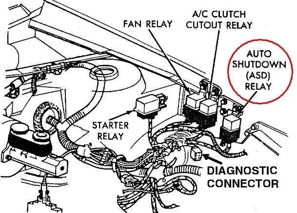

To start with, the Hall Effect pickup assembly has to be working if you have spark and injector pulses. When signal pulses show up at the Engine Computer from that sensor, that tells it the engine is rotating, and that means it is time to turn on the automatic shutdown, (ASD) relay. That relay sends current to the ignition coil, injector(s), fuel pump or pump relay, and the alternator field circuit. It's that circuit you're applying the 12 volts to with your jumper wire. This suggests the 12 volts isn't coming from the ASD relay, so we have to determine if that relay is defective or if the computer is failing to turn it on.
The place to start is by monitoring the voltage in the circuit you're applying 12 volts to. Leave that jumper wire off, then connect a test light there. You might be able to use a digital voltmeter too, but they usually don't respond fast enough. You should see the test light turn on for one second when you turn on the ignition switch, then it will turn off again. You might hear the hum of the fuel pump for that one second too. If you see that, the ASD relay is okay and the computer has control over it. If you do not see that, check for 12 volts on the red wire in that relay's socket. It's not common for that to be missing so we'll address that later if necessary.
Due to the location of the ASD relay, it is susceptible to moisture and corrosion. Check the terminals in the connector for corrosion. If you see any sign of that, a good suspect is a buildup of corrosion between the contacts inside the relay. You might want to pop the cover off the relay and look inside for that damage.

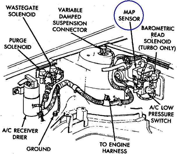

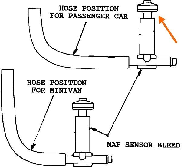

The running problem you described sounds like a failing MAP sensor, but also check for a cracked vacuum hose going to it. Check to see if the recall has been performed that added the bleed valve shown in the fourth drawing.
