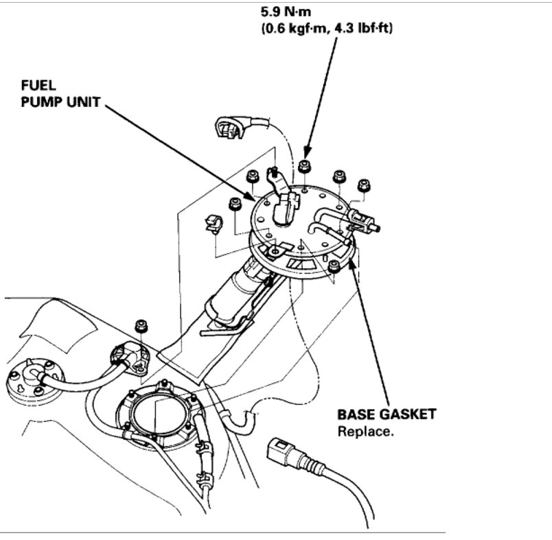

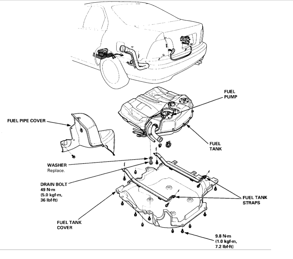

I have seen this problem before and a new fuel pump fixed it. Here is a guide that will help you get an idea on what you are in for when doing the job and some diagrams (Below) of what it will be like on your car.
https://www.2carpros.com/articles/how-to-replace-an-electric-fuel-pump
you will need to jack the car up.

Hi Ken, I replaced the fuel pump and the car is still having problems starting periodically both on an incline and parked on a level surface. Do you have any other suggestions on what it could be?

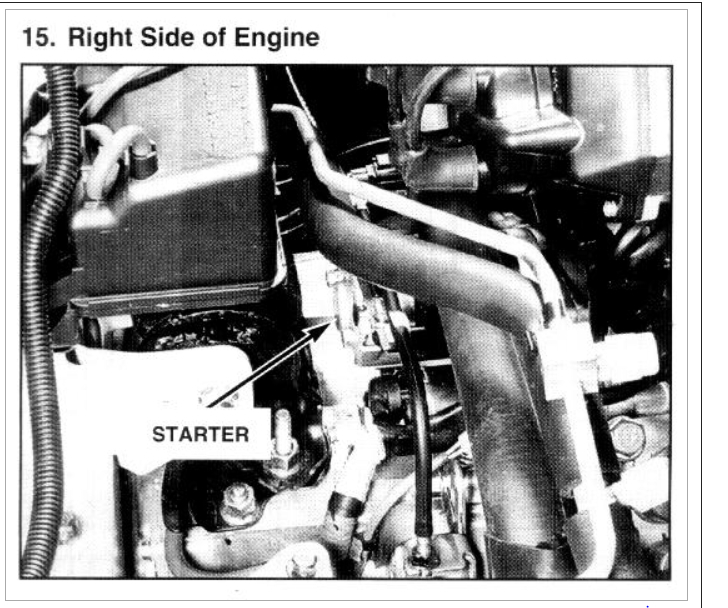

Sorry, I misunderstood. This should be a starter issue but to be sure use a test light to check the trigger wire at the starter when the engine is being cranked over if it lights up the starter is bad. Here are two guides so you can see what I am talking about.
and look toward the bottom of the guide.
Here is the starter location (below) Please let us know what happens.
