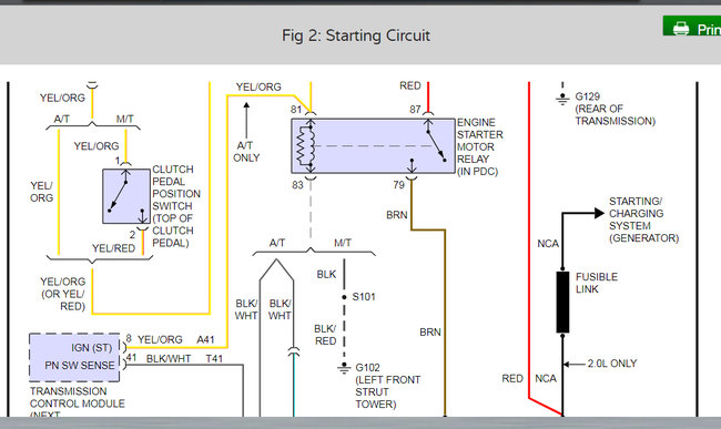

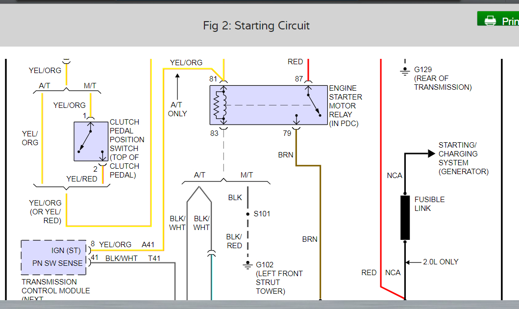

car worked fine last night no indications of anything wrong. turning the key I have dash lights and power windows work and dome light works but not the radio, which only makes me wonder why not; i.e. what link this might mean.
Fuses checked okay.
car will not turn over, or 'clicking' so either the security switch is bad or something else that I cannot figure out.
Thanks for any suggestions

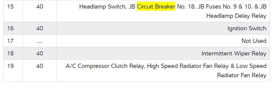

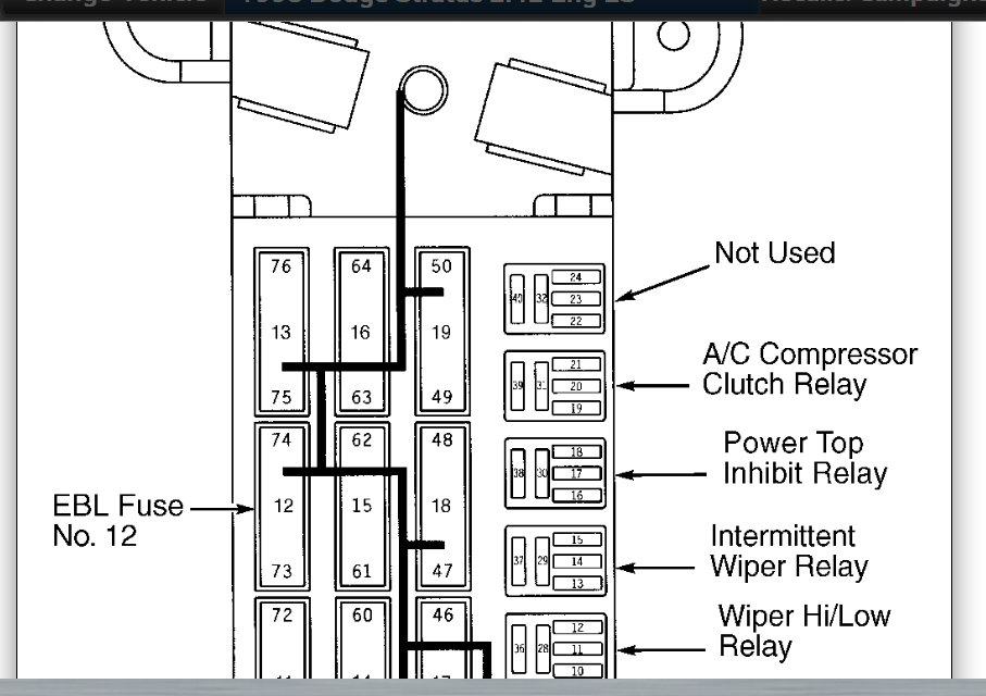

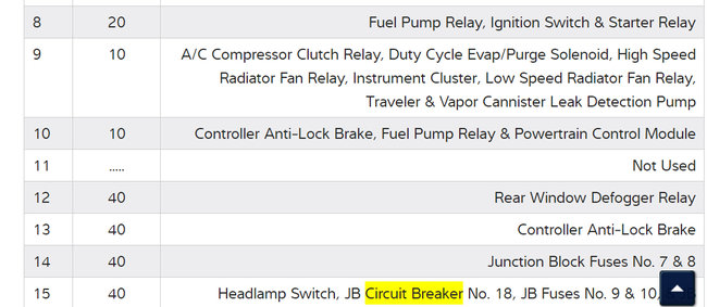

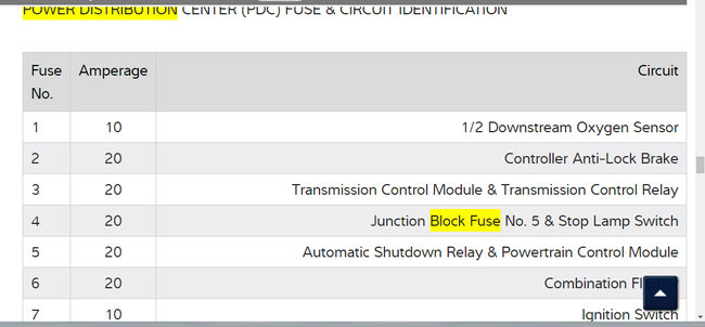

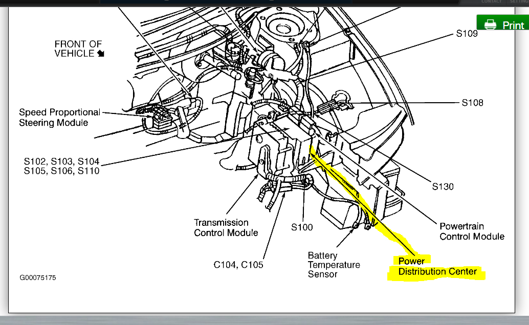

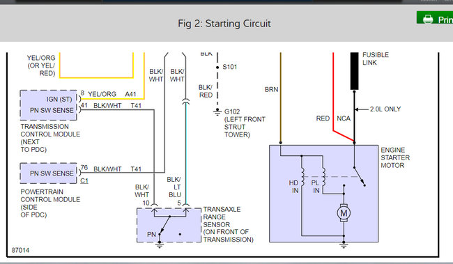

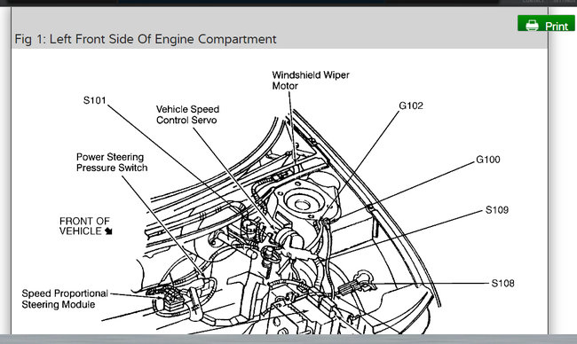

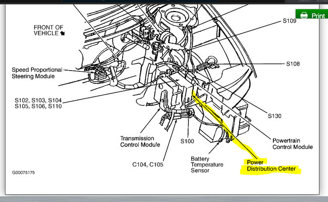

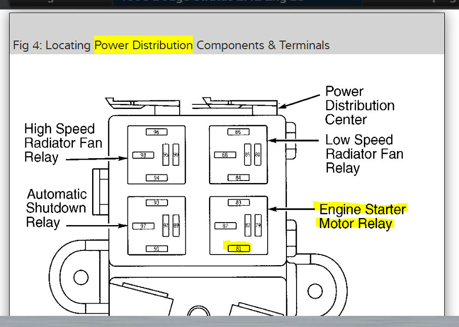

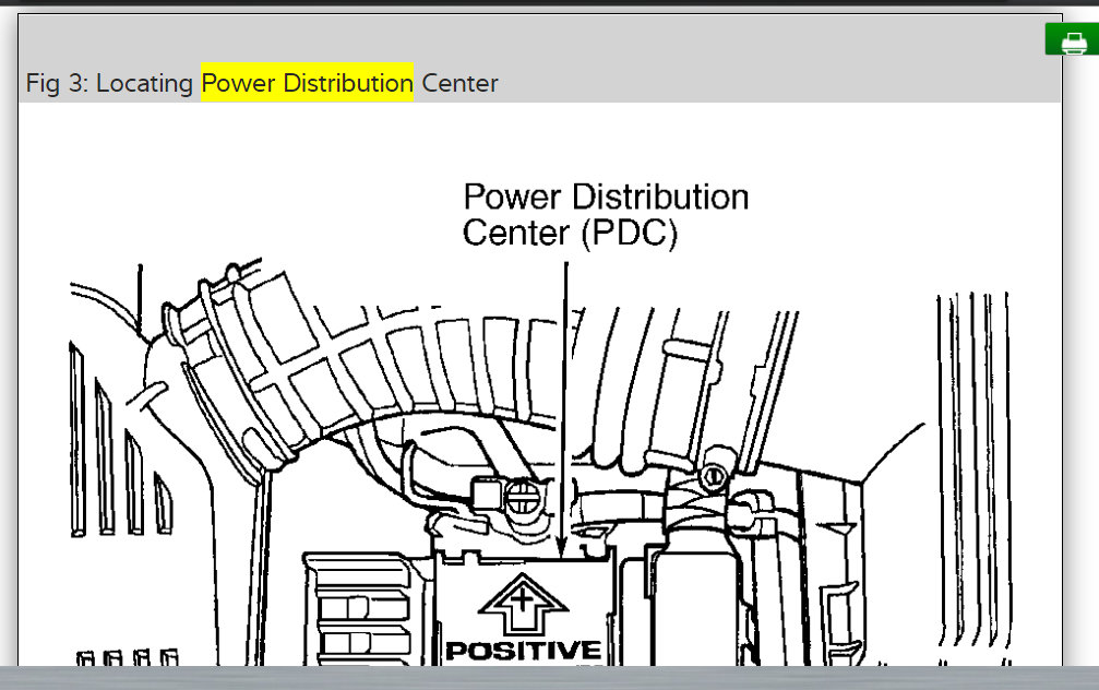

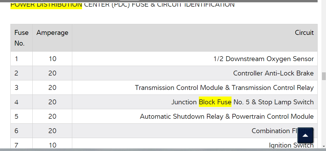

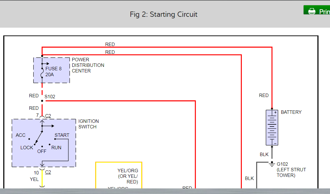

This could be a couple of different things, but let's start with the starter relay. With an assistant cranking the ignition switch, I am going to need you to get a voltage reading from pin #81 at the starter relay. I have included a link down below for you to go to if you are un familiar with how to use a multi-meter as you will need to use one to do this.
In the diagrams down below I have included a Starting System wiring diagram as well as a relay description for you. Please get the voltage reading and get back to us with what you are able to find out.

It turned out to be the ignition fuse. Of interest to note, we had checked all fuses, including the ignition fuse, and all checked out and then we (eventually) switched fuses and the car started right up. now learning that old cars have old fuses; fuses that corrode from wear and tear even though the fuses has not broken.
Lesson learned? To periodically change fuses, or at a minimum periodically simply pull each fuse to check for wear and tear corrode and to keep back up fuses in the trunk, along with 'needle nose' pliers for fuse pulling.

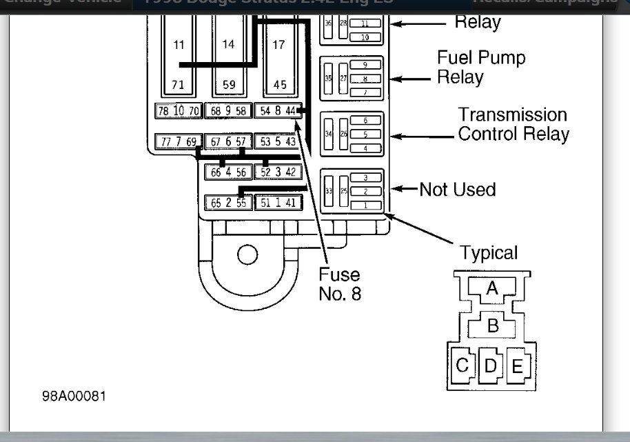

To add confusion to the story, your ASD relay is wired differently than in previous models so your service manual might be wrong. Below is my sad drawing of the typical relay layout and common terminal numbering with the numbers you're using. The next one shows the Stratus relay. Two terminals must have 12 volts all the time. The ignition switch is no longer involved in the relay's coil circuit. This would agree with what you found already.
To measure terminal 93 you must have the relay installed. Raise it up enough to fit the meter probe onto the terminal, or wrap a piece of wire around the relay's terminal to use as a test point. I don't like to stuff a wire in beside the terminal because it could stretch the terminal in the socket and cause an intermittent connection. You should see 12 volts there when the relay is turned off. The relay is turned on when terminal 93 gets grounded and the voltage goes close to 0 volts.
You can ground terminal 93 too, then test for 12 volts at the coil or injectors. If you have that, all that leaves is the Engine Computer is not grounding that terminal.
