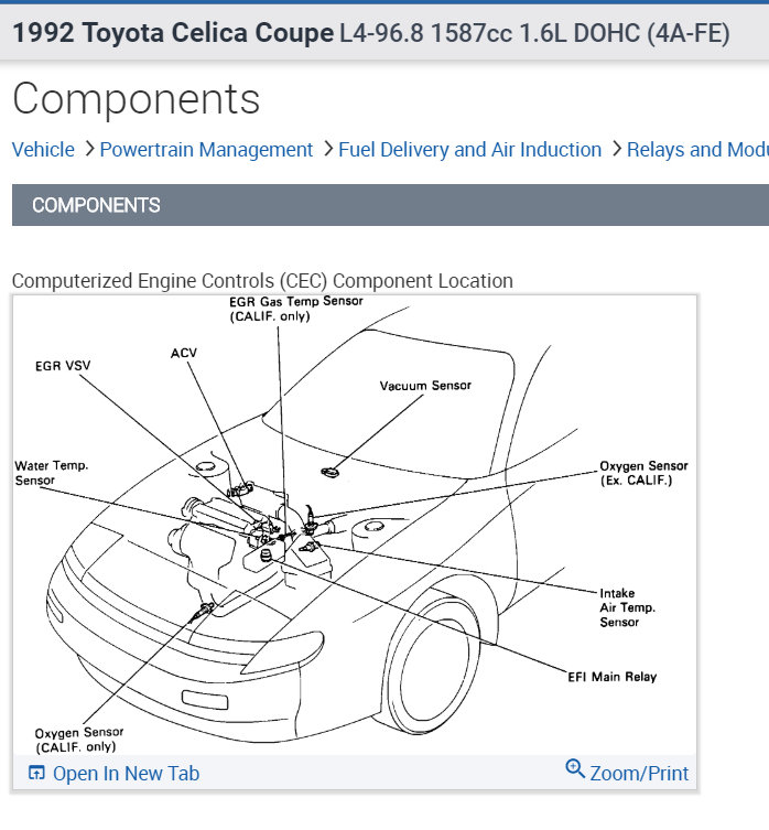

Was running then it would try to crank but wouldn't and now it is not getting any fire to the electronic distribution.
-1
Tuesday, December 29th, 2020 AT 9:26 AM (Merged)
KEN L
  • MASTER CERTIFIED MECHANIC
  • 48,363 POSTS
It sounds like the EFI relay has gone out. but to be sure here is a guide to help test the relay with the location of the relay in diagrams below:
