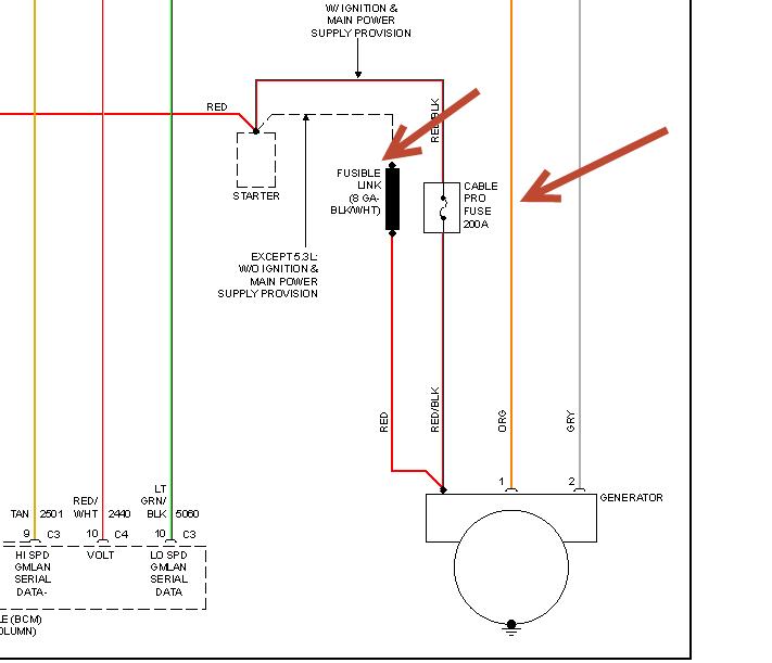

HMAC300
  • 48,601 POSTS
if you have a test light or voltmeter test the two things I've pointed out. you may have burnt the fusible link and or the maxi fuse as you are jumping the car beyond the maxi fuse. Your car will not charge if maxi fuse is out and may be the reason for the codes. once the fuse is found to be ok then clear codes and rdrive and then rescan if they come back. they should all have battery voltage on both side.s

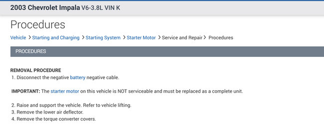

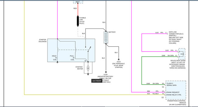

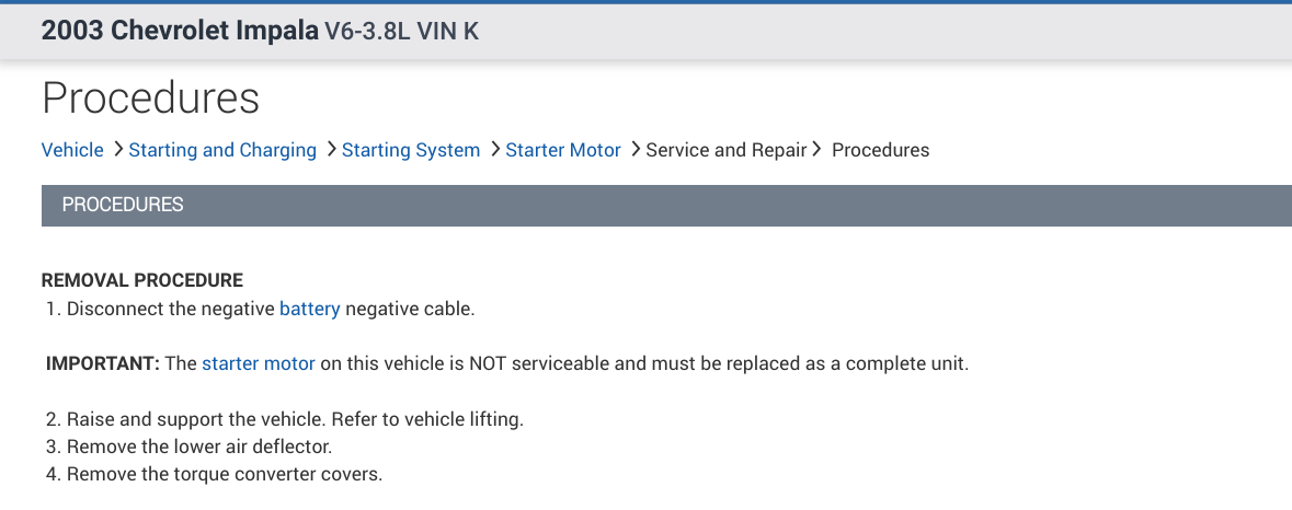

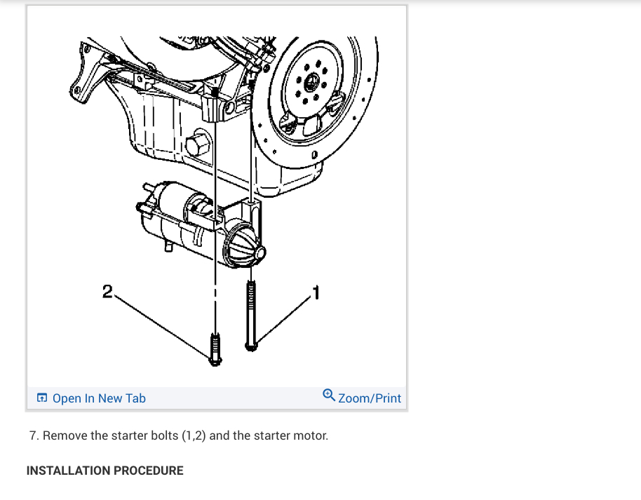

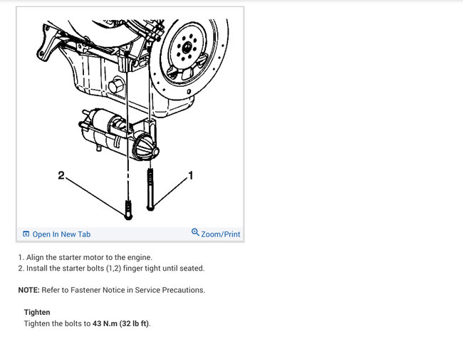

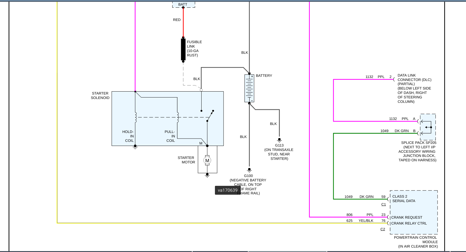

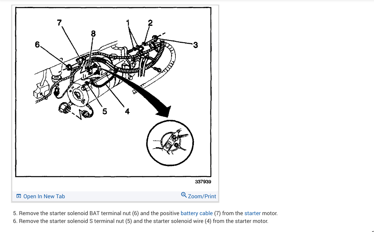

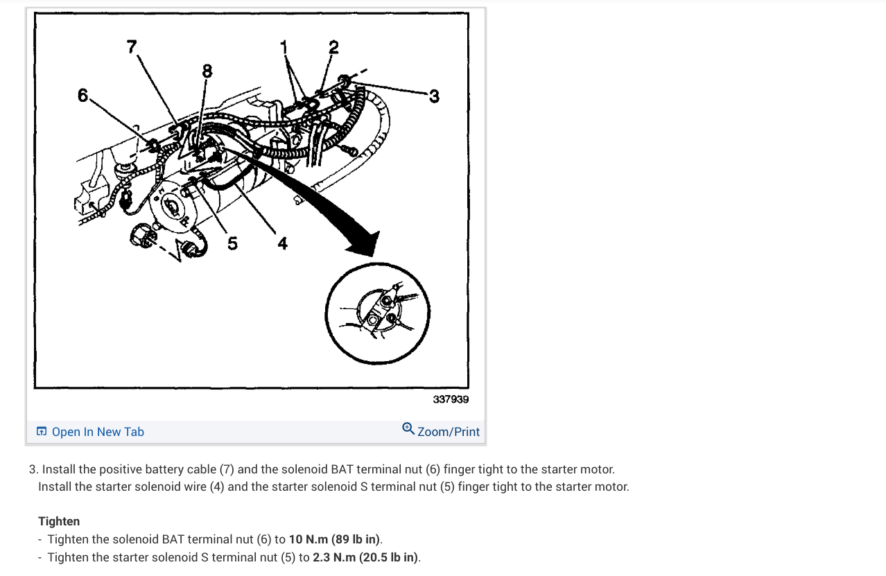

SCGRANTURISMO
  • 4,897 POSTS
This could be your starter dragging because it is failing. In the diagrams down below I have included the wiring diagram for your vehicle's starting circuit and the instructions for the removal and installation of the starter for your vehicle. Please go through the guides and get back to us with what you are able to find out.

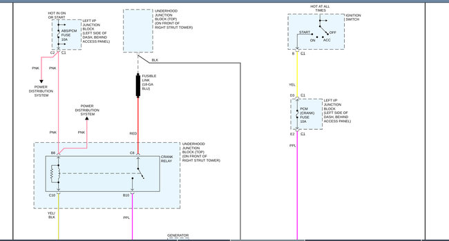

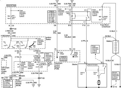

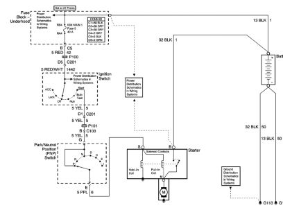

MICHAEL FRANKS
no power to pcm fuse & pcm crank fuse. fuses test good. Starter will not engage . No interior lights. windows work.battery and alternator test good also
Mar 6, 2021 at 10:07 AM (Merged)
MATHIASO

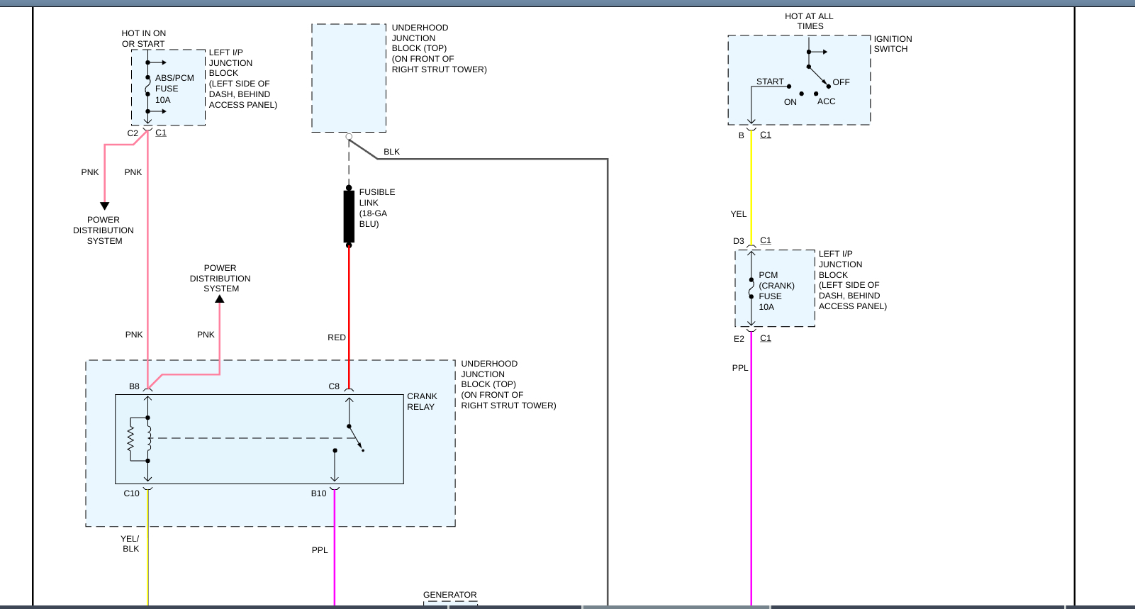

  • 1,209 POSTS
Hello michael franks Check the ignition main fuse#5 (40A)underhood, if fuse is ok, check power to the fuse. Check ignition fuse #5(30A)
https://images.2carpros.com/forum/automotive_pictures/46384_1_8.jpg
Check power to crank fuse,if there is no power, check for an open between Bat+ and fuse block.(see diagram)
https://images.2carpros.com/forum/automotive_pictures/46384_2_6.jpg
Check your email for the diagrams.
