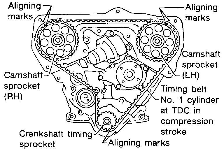

I just change the crank shaft seal and now car wont start. I forgot to align the crankshaft timing mark.
Dec 4, 2019 at 7:45 PM
  • 110,194 POSTS
Did you remove the timing belt for any reason?
Dec 4, 2019 at 9:05 PM
JULLIANB94
Yes, I moved the belt from the crankshaft sprocket. So today I went back in today after verifying TDC with the #1 plug. The cams were a little off so I adjusted them to line up with the timing dots for the cams. I then reinstalled the timing belt and it test started. After reassembling everything and adding oil, I started the engine. Sounded good at first but then I started hearing a knocking sound from the valve areas. A large amount of smoke also started coming from the tail pipe. Now I'm lost.
Dec 5, 2019 at 4:57 PM
  • 110,194 POSTS
Don't run the engine anymore until you confirm timing. This is an interference engine and internal damage can result if the timing is off. Let me know what color the smoke was. Here are the directions specific to your vehicle. The attached pics correlate with the directions.

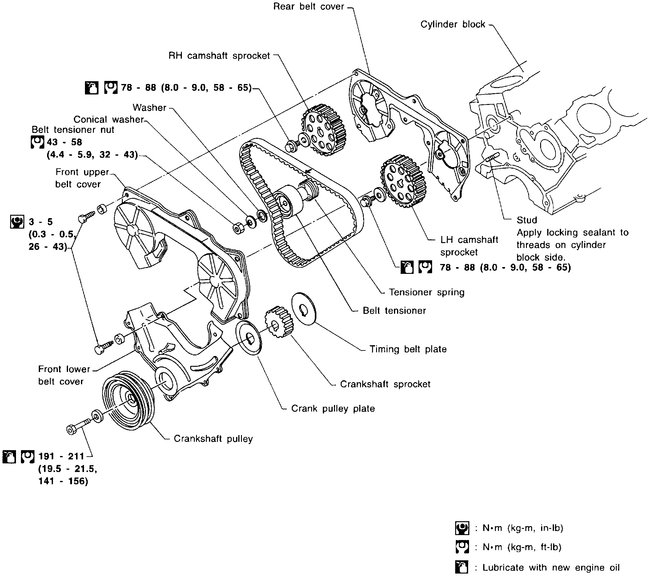

REMOVAL
1. Remove engine under cover.
2. Drain engine coolant from radiator.
Be careful not to spill coolant on drive belts.
3. Remove radiator.
4. Remove engine cooling fan and water pump pulley.
5. Remove the following belts.
- Power steering pump drive belt
- Compressor drive belt
- Alternator drive belt
6. Remove all spark plugs.
7. Remove distributor protector.
8. Remove compressor drive belt idler bracket.
9. Remove fresh-air intake tube for rocker cover.
10. Remove water hose for thermostat housing.

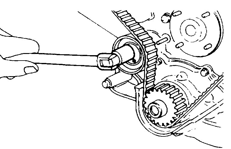

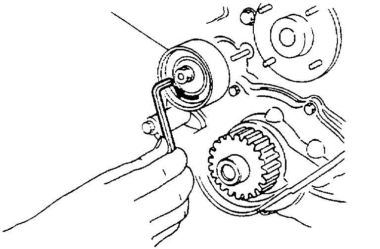

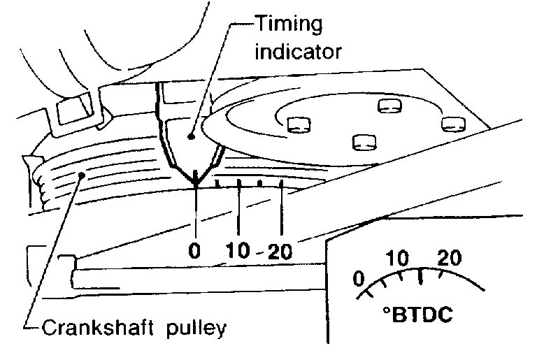

pic 2
pic 3

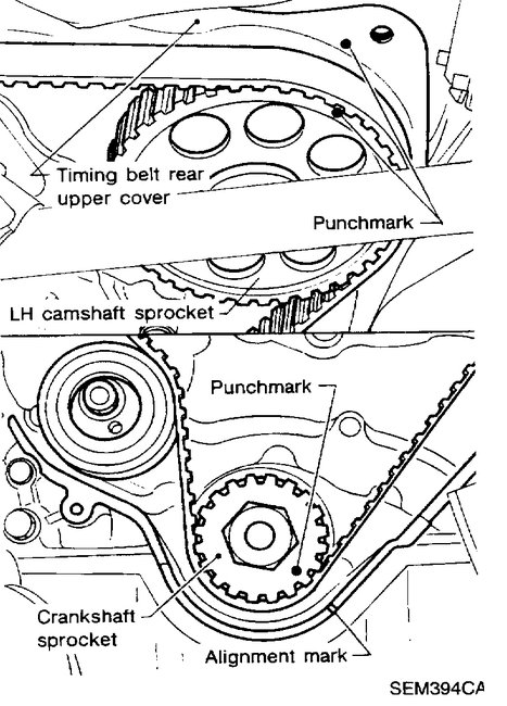

11. Set No. 1 piston at TDC on its compression stroke by rotating crankshaft.
12. Remove crankshaft pulley bolt.
13. Remove crankshaft pulley with a suitable puller.

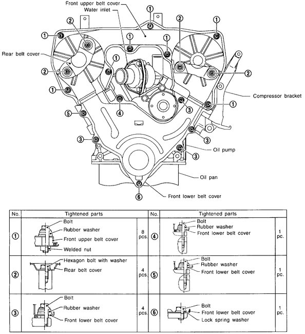

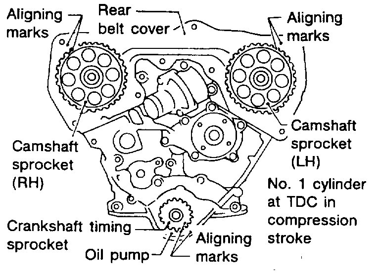

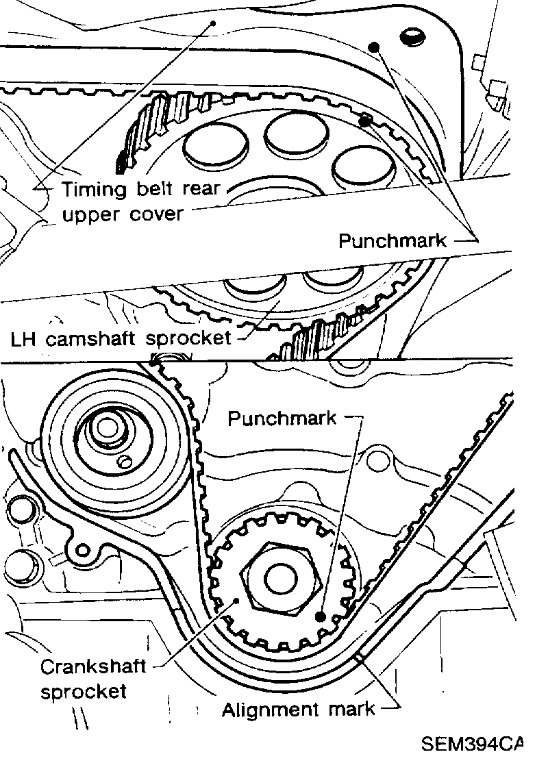

14. Remove front upper and lower belt covers.
- Align punch-mark on LH camshaft sprocket with punch-mark on timing belt upper rear cover.
- Align punch-mark on crankshaft sprocket with notch on oil pump housing.
- Temporarily install crank pulley bolt on crankshaft so that crankshaft can be rotated.
pic 4
15. Loosen timing belt tensioner nut, turn tensioner, then remove timing belt.

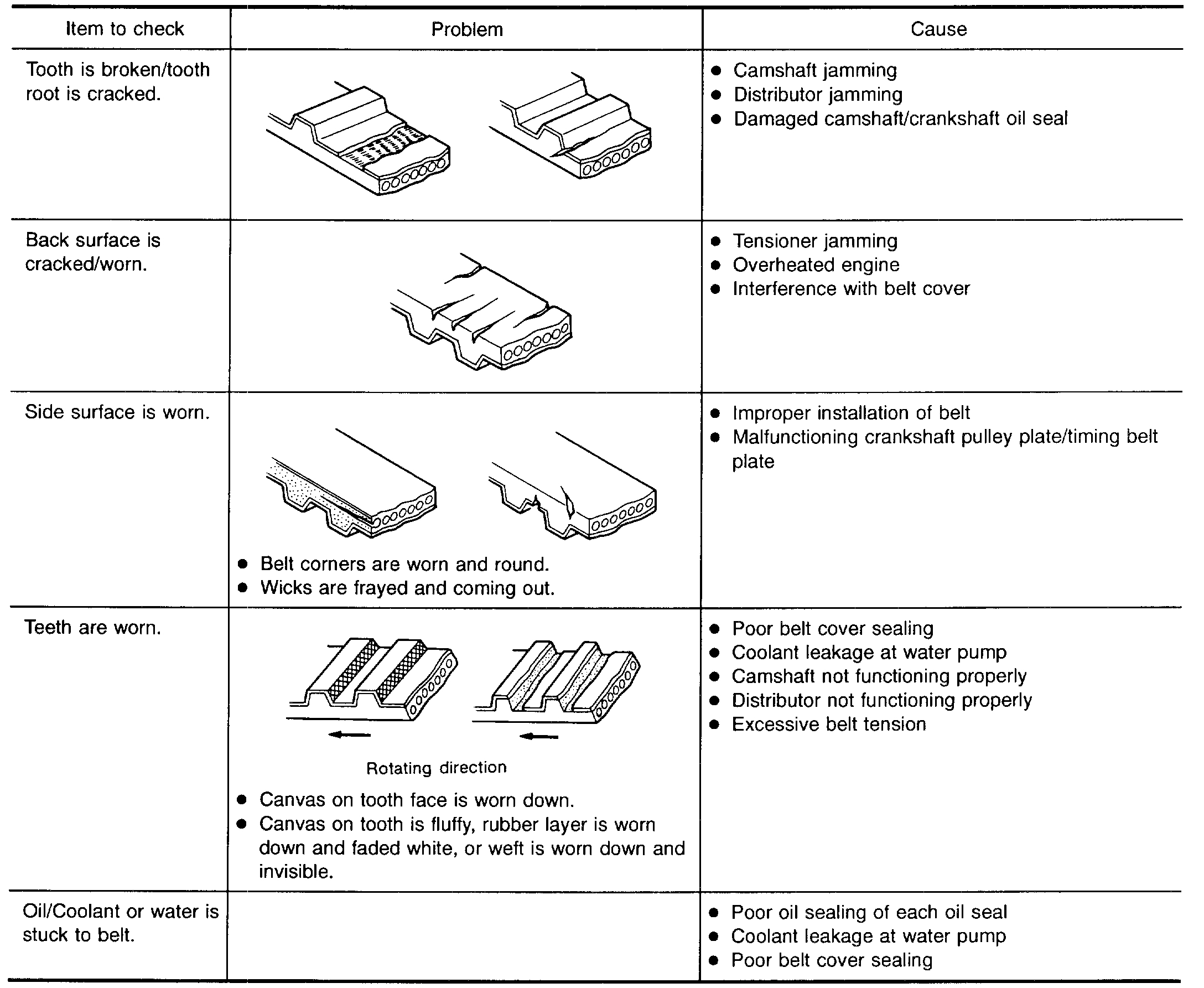

INSPECTION
pic 5
Visually check the condition of timing belt. Replace if any abnormality is found.

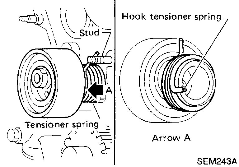

BELT TENSIONER AND TENSIONER SPRING
pic 6

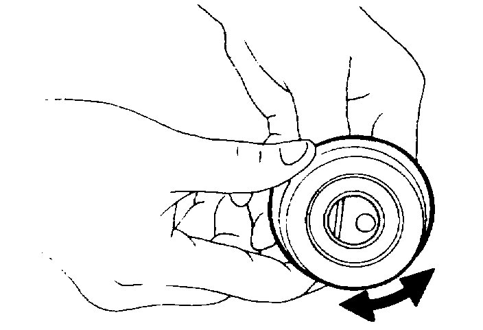

1. Check belt tensioner for smooth turning.
2. Check condition of tensioner spring.

1. Confirm that No. 1 piston is set at TDC on its compression stroke.
pic 8
2. Install tensioner and tensioner spring.
If stud is once removed, apply locking sealant to threads of stud on cylinder block side before installing.
pic 9
3. Turn tensioner fully outward with hexagon wrench, and temporarily tighten lock nut.
pic 10
pic 11

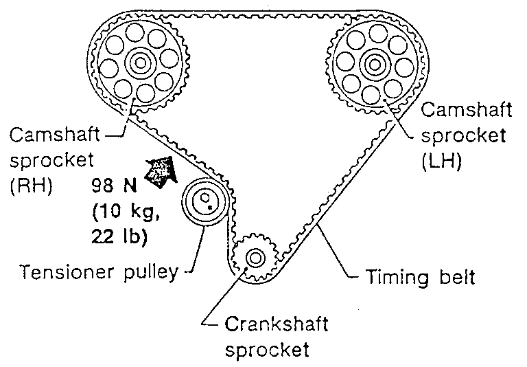

4. Set timing belt when engine is cold.
1. Align white lines on timing belt with punch-marks on camshaft sprockets and crankshaft sprocket.
2. Point arrow on timing belt toward front belt cover.
pic 12

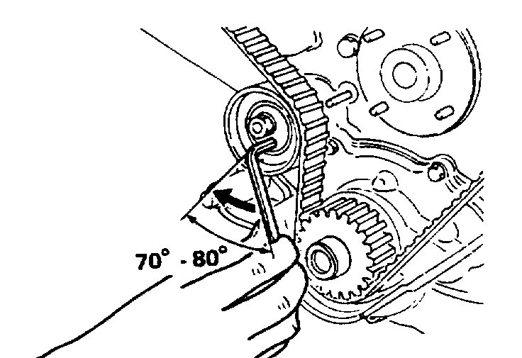

5. Loosen tensioner lock nut, keeping tensioner steady with hexagon wrench.
6. Turn tensioner 70 to 80 degrees clockwise with hexagon wrench, and temporarily tighten lock nut.
7. Turn crankshaft clockwise at least 2 times, then slowly set No. 1 piston at TDC on its compression stroke.
pic 13

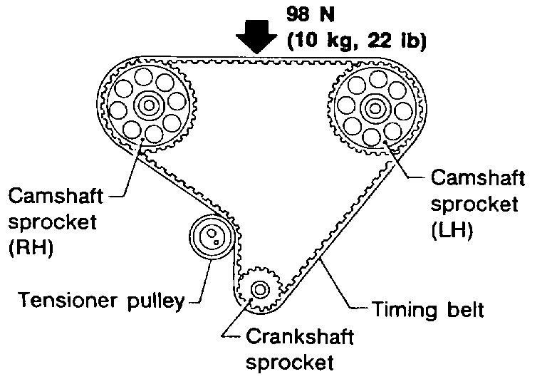

8. Push middle of timing belt between RH camshaft sprocket and tensioner pulley with force of 98 N (10 kg, 22 lb).

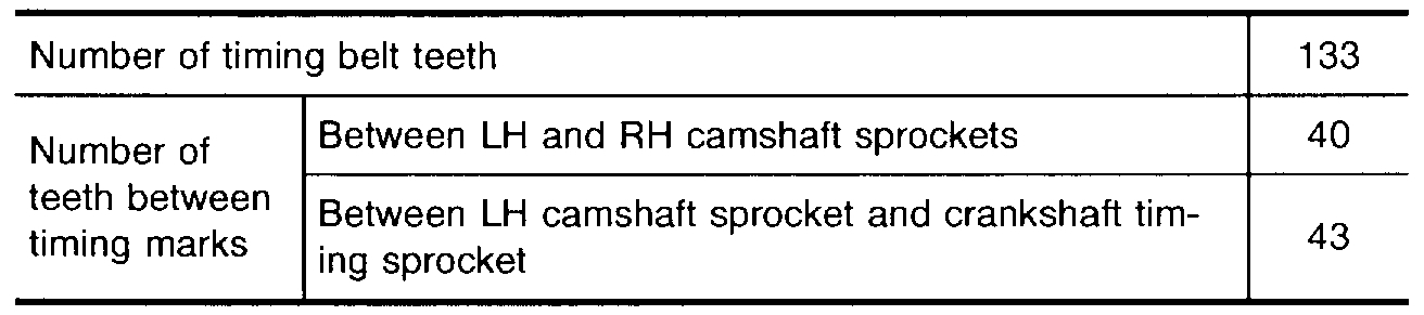

pic 14

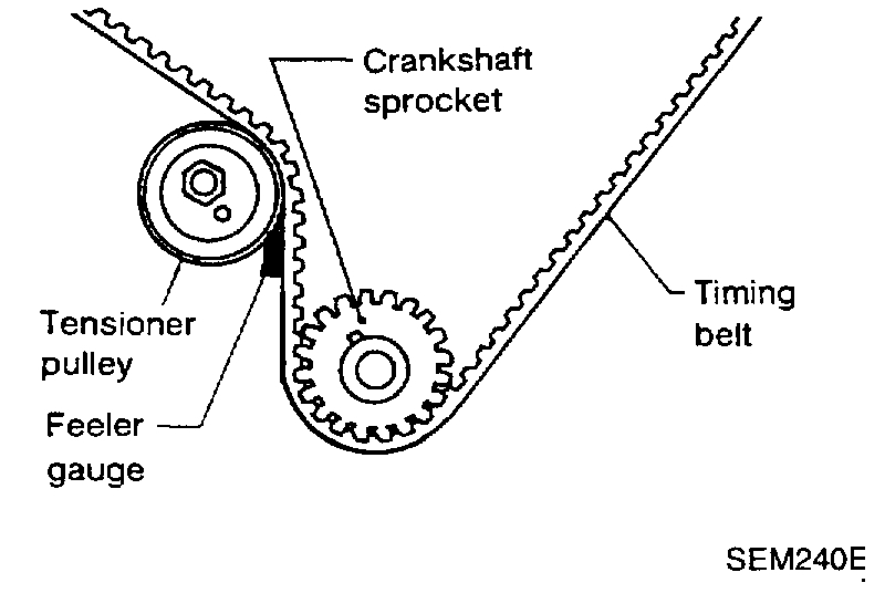

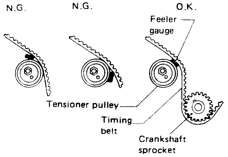

10. Set feeler gauge as shown in image which is 0.35 mm (0.0138 inch) thick and 12.7 mm (0.500 inch) wide.
pic 15
11. Turn crankshaft clockwise until feeler gauge is positioned as shown in image.
- Timing belt will move about 2.5 teeth.
12. Tighten tensioner lock nut, keeping tensioner steady with hexagon wrench.
13. Turn crankshaft clockwise or counterclockwise, and remove feeler gauge.

15. Install lower and upper belt covers.
BELT TENSION CHECK
pic 16
1. Set No. 1 piston at TDC on its compression stroke.
pic 17
2. Measure deflection of timing belt midway between camshaft E pulleys while pushing with 98 N (10 kg, 22 lb) force.
Belt deflection when engine is cold (Reference value): 13 - 15 mm (0.51 - 0.59 inch)/98 N (10 kg, 22 lb)

Let me know what you find. I hope damage wasn't done to the valves. I am concerned because you said about the noise. Make sure the belt is in good condition and properly tightened. You don't want it to jump time.
Dec 5, 2019 at 8:52 PM
JULLIANB94
Will the process you described work even though I've physically turned the cams separately to line up with the timing notches? The belt obviously had slipped when I didn't follow protocol when I replaced it the very first time.
Dec 6, 2019 at 3:58 AM
JULLIANB94
The belt jumped time the first time I reinstalled it cause I didn't remove the top timing cover to verify belt tension. I had only removed it from the crankshaft gasket.
Dec 6, 2019 at 4:08 AM
  • 110,194 POSTS
Yes, but if the belt jumped, it should be replaced. Chances are it is bad. My biggest concern is the noise you heard and the fact that this engine is an interference engine. There may have been damage done.
