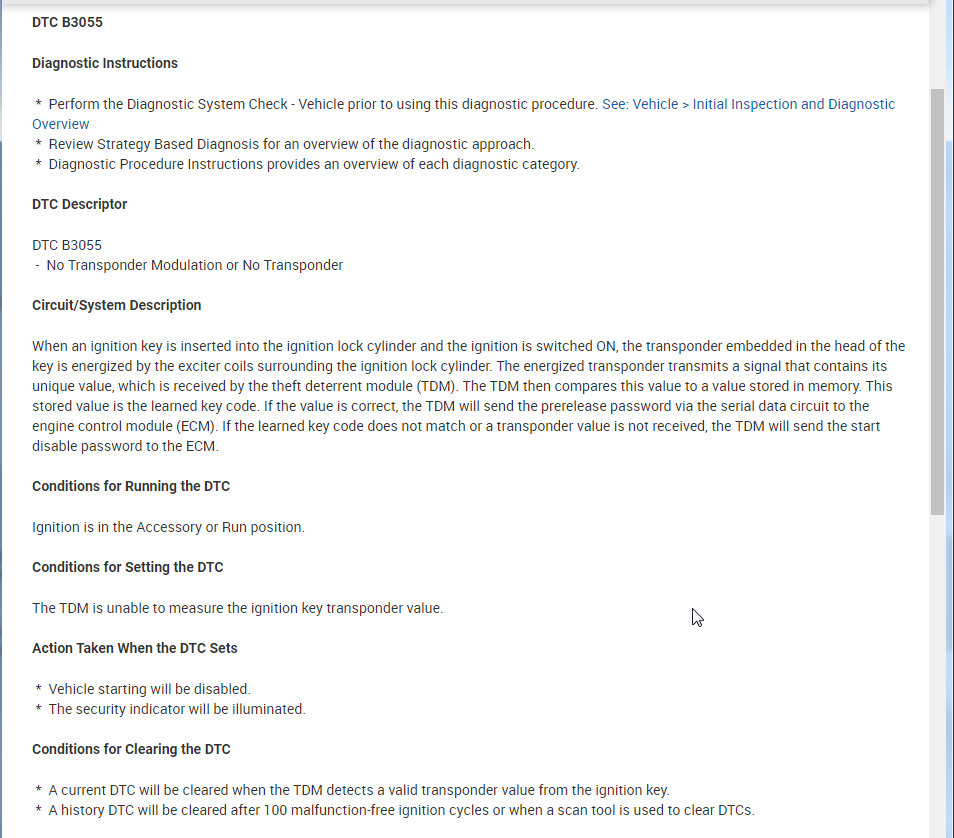

A few months back my car started being really stubborn about turning over. I'd have to rock the key (not the wheel) for nearly 5 minutes before it would start or let the key out. I saw a video where a guy suggested the wiring below the shifter so I replaced that and I still have this problem. Then I replaced the whole ignition with new tumblers and all. I still have the same problem.
Side note - while installing the new ignition I was putting the wiring clip (sits on top of the shell above the ignition) and I jammed the screw driver into it too hard and busted it. I have to replace that now too and I'm not ever sure what it's called.
I don't know what to do anymore. This problem is starting to become a money pit and I'm at my wits end.
What do I do to solve this issue so I can get my car back on the road?

I had a neighborhood mechanic put my car on this computer and These are the error codes and what they say.
P0081 pass pres system
B1019 System config incorrect - system 3A
B1000 electronic control unit performance failure
U198 lost comm w/ telecom control mod
U0214 lost com w/ remote
B3055 No transponder modulation
B3060 not programmed transponder ID code
P0449 Evap Circuit
P0455 Evap large leack
P0513 Undoc code
U0140 Lost comm w/ body control mod
B3031 Security system controller in learn more - test failed
I think that's all I have. Lol
Saturday, March 6th, 2021 AT 5:55 PM (Merged)

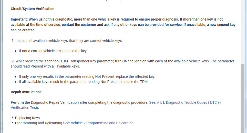

I am attaching the testing needed for the B3055 which does appear to be the issue.
This means a key was used that is not programmed to this vehicle or the key is no longer programmed. However, when you add in the other codes, you most likely have an issue with the ECM or transponder itself.
Let's run through this testing and see what turns up and we can go from there. Thanks.

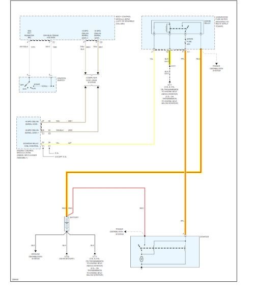

I've replaced starter two times and all my lights and everything coming on but it's still not cranking or even trying to crank. Battery is good, radio, lights are all on and strong but car not cranking or even making any noise to crank.
  • 52,797 POSTS
Good evening,
Did you verify power to the small wire on the starter with the key in the start position to see if you have power?
TINA S
Yes I did. It's just not doing anything.
  • 52,797 POSTS
Okay, what was the result? Do you have power at the small wire in the start position?
TINA S
Yes.
  • 52,797 POSTS
If you have power, then the only thing left is the starter motor itself.
