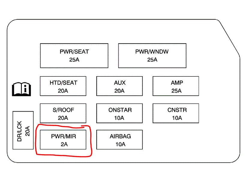

Are the lock issues something that started at the same time as the other issue?

Thanks for your reply, yes the issue with the locks and windows started at the same time.. I will try to get the starter tested soon as possible and I’ll post the engine size soon. Also not sure if it would matter but I forgot to mention the starter was replaced last year not sure how long they usually last.

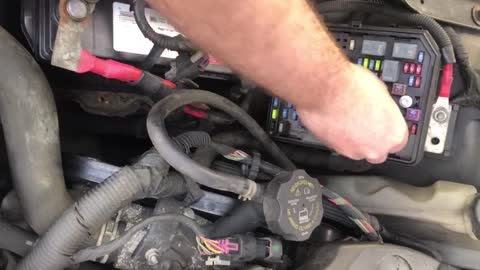

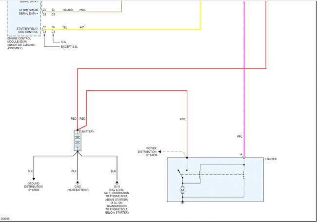

Had someone come and look at it, they tried to start it from the fuse box and the engine was trying to start but when I try to start it with the key it does nothing.
Oct 28, 2020 at 12:31 AM
  • 110,240 POSTS

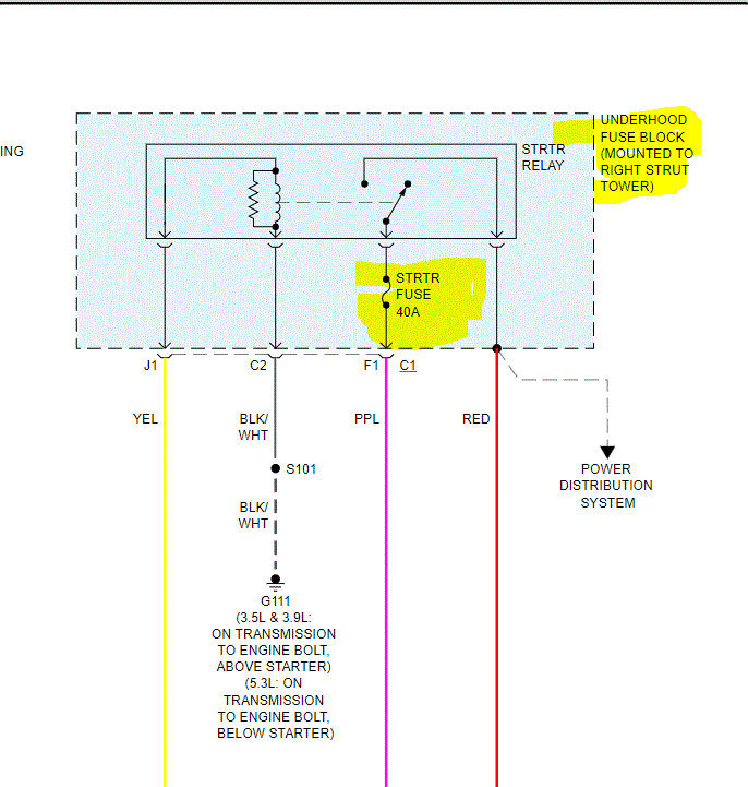

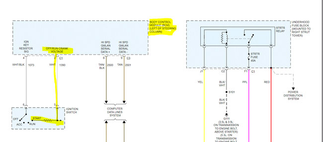

It sounds like they were jumping it at the starter relay. If the starter engaged, then the starter itself is good. Chances are the relay is bad or there even could be a blown fuse.

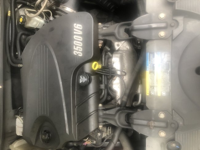

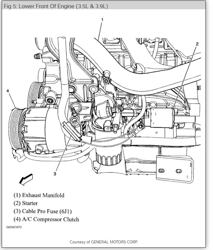

Let me know the engine size. It will either be a 3.5L, a 3.9L, or a 5.3L V8.

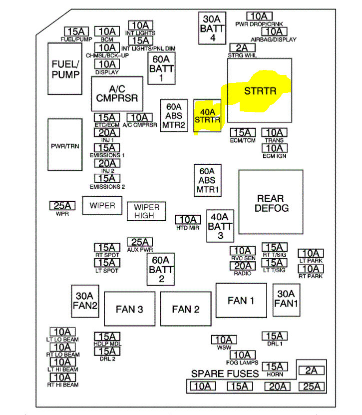

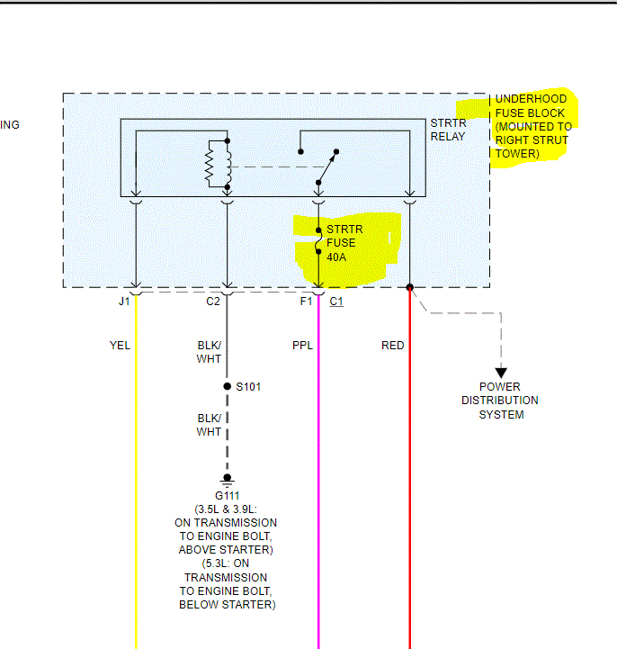

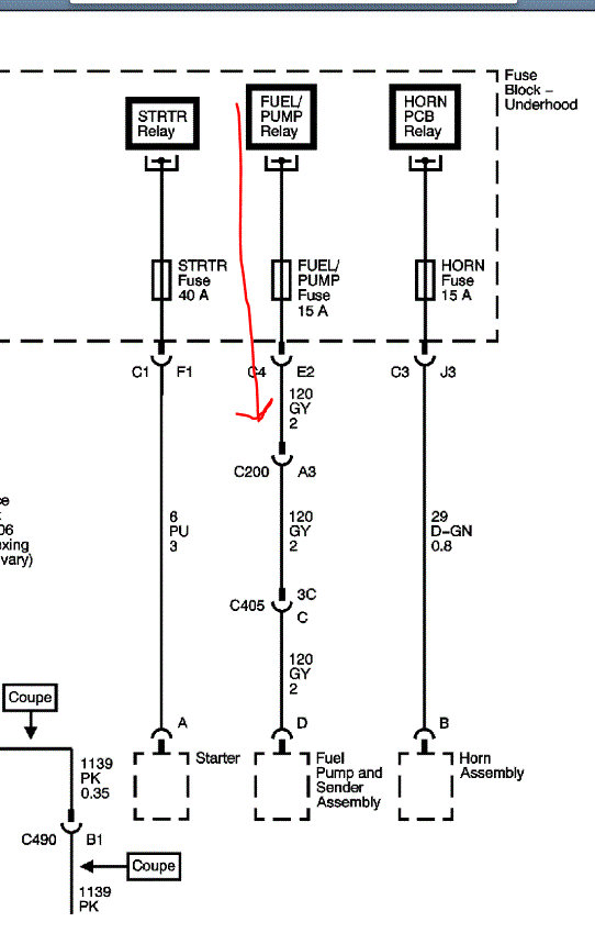

If you look at the pic I attached, it is for the 3.5L V6. I highlighted the starter fuse and relay. Now, if he jumped the red and purple wire in the relay connector, then the fuse is good. That leaves the relay or a signal issue from the ECM or a bad ground for the relay.

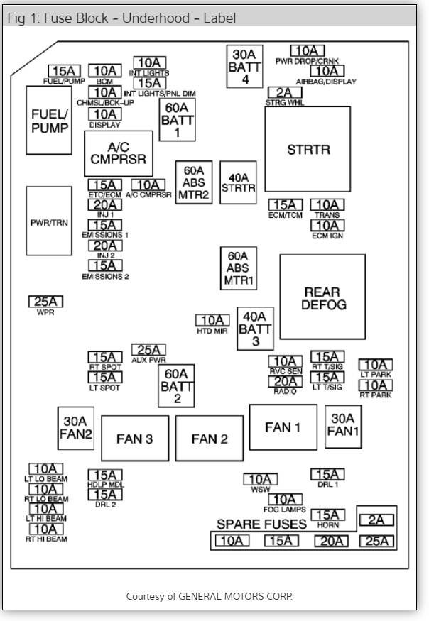

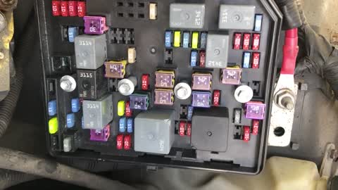

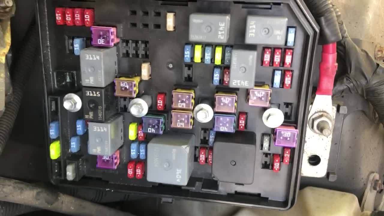

If you look at pic 2, it shows the under hood fuse box. I highlighted the fuse and the relay. If you find the engine is a 3.5L, check that fuse. If it is good, remove the relay and switch it with a different one in the box that has the same part number. Or, here is a link that shows how to check a relay:
Also, when checking the fuse, confirm power to it and out from it. Here is a link showing how that is done:
Let me know what you find.

Thanks for your reply. I will check the fuses and try to get a video of what it’s doing as soon as possible. 3.6L v6 engine.
Nov 2, 2020 at 6:38 PM
  • 110,240 POSTS

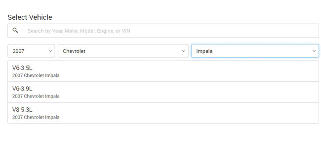

Sounds like a plan. However, I am not showing a 3.6L as an option for this vehicle. See the attached.
Nov 3, 2020 at 10:48 AM
LILDIPPER513
  • 8 POSTS
3.5L v6 I apologize about that.

Just uploaded 2 videos of what it does when I try using the key to start it and then videos of me trying to start it from the fuse box.

Were you able to check the fuse and relay?
Nov 5, 2020 at 7:42 AM
LILDIPPER513
  • 8 POSTS
I put a new relay fuse in, but still same issue.

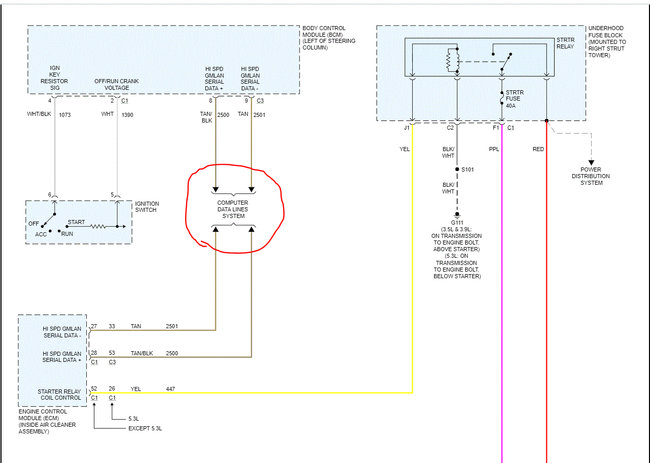

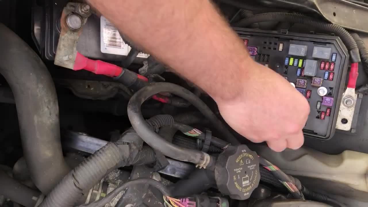

Okay, I have a feeling either the ignition switch is bad or the body control module. Take a look at the pic below. I need you to locate the body control module under the dash (left side). I need you to check for a voltage signal from the switch to the BCM (white wire).
Nov 8, 2020 at 8:26 AM
LILDIPPER513
  • 8 POSTS
Sorry for the delay but I finally figured it out.. it was the module. Thanks for the help and I appreciate your time.

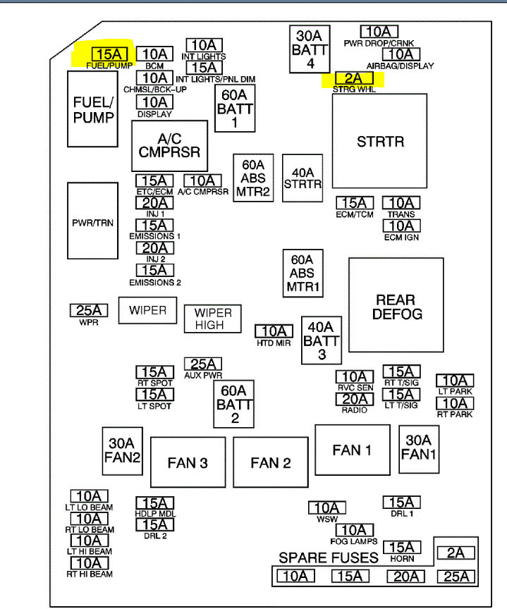

  • 110,240 POSTS
I attached two pics. The first is the under hood box and the second is in the vehicle. I highlighted two that I believe you are referring to in pic one, and circled one in pic 2. Are these the fuses?
Mar 6, 2021 at 9:54 AM (Merged)
CLIFF CONNER
Yes they are.
  • 110,240 POSTS
I want you to switch the fuel pump relay with another relay in the box that has the same part number to see if you then have power to the fuse. According to the schematic, power is fused after the relay. See pic 1.

Did it, still no power. I also have a 2005 impala that I have been switching fusing and relays with trying to duplicate the problem,when I remove the bcm fuse from the 05 it has the very same no start condition.problem is the 05 bcm crank is in the cars cabin..
  • 110,240 POSTS
It could be a body control module issue. Here are the wiring schematics for the entire starting system. Note that I circled the data lines. That is a part of the vehicle's CAN bus system. CAN stands for computer area network. You may want to get your hands on a scan too that can check all modules to see if there is a break down. Here is a video that shows how it's done and why:
https://youtu.be/InIlnsjOVFA
See if the schematics are helpful. I overlapped the two when I copied them so you could follow them easier.
CLIFF CONNER
Thanks for all the help. I disconnected my air conditioner and it was burned in the back harness,once disconnected the car started right up.
