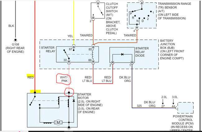

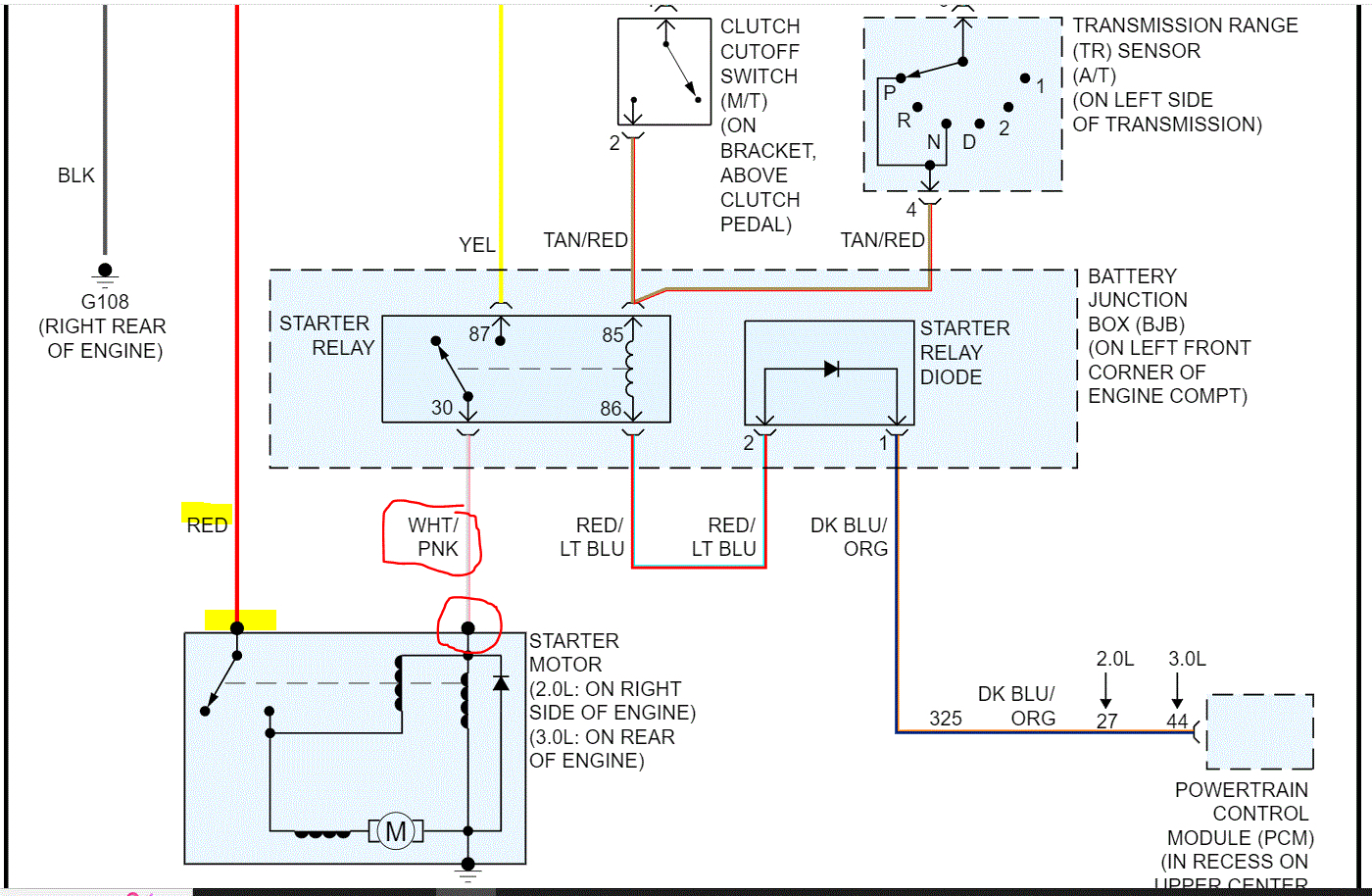

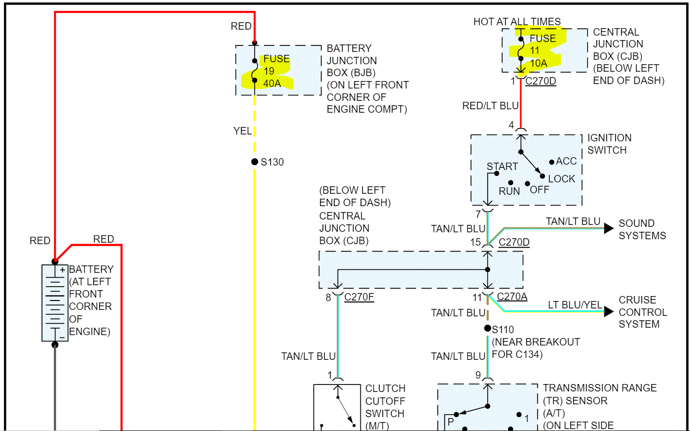

The gas light turned on parked it and the next morning the car would not start. The engine light, oil light, and battery light are on. The battery is fully charged. we put four gallons of gas in the car, but when we turn the key to try and start it, it does absolutely nothing. please help.

I attached the wiring schematic below. First, confirm fuse 19 (40 amp) in the battery junction box is good. If it is, confirm there is power to and from it. Also, check fuse 11 in the central junction box inside the vehicle. It is important to check that both have power. Here is a link that explains how to do it:
If the fuses are good, I need you to check for power at the starter motor. There are two wires we need to check. There is a heavy gauge red wire that should have 12v at all times. There is a thinner wire that is white with a pink tracer that will not have power until the key is in the start position. Have a helper turn the key to the start position while you check for voltage at the white/pink wire.
Let me know what you find.
See pics below. Note: The schematic was one page. I cut it in half to make it readable but overlapped them so you can follow from one to the next.
