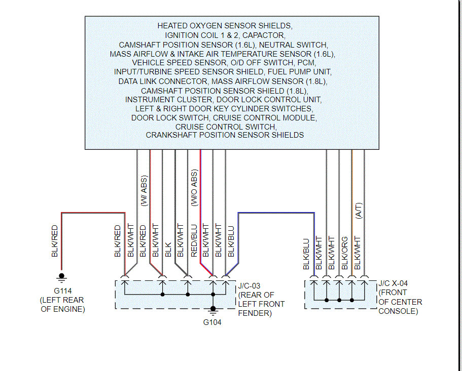

The car will turn over but not start. I don't have any dash lights that normally come on.

Does anything electrical, other than the starter, work? It could be a ground related issue. I attached a pic below that shows a specific ground. Check to make sure it is in good condition and not corroded, loose, or damaged.
Note that there are two grounds in the pic. One is behind the left side of the engine and the other is at the left front inner fender.
If you read the items in the box which are affected by the grounds, you'll notice the car won't run and the instrument panel won't work if they are bad.
