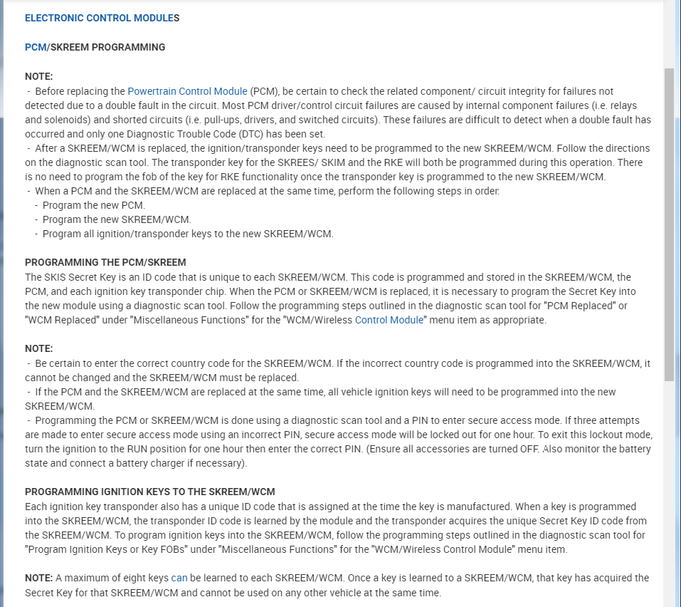

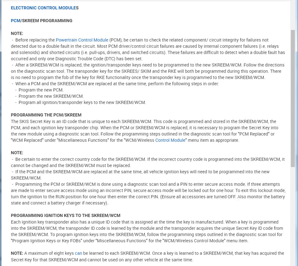

If that is the case, did you perform the PCM replacement procedure with the scan tool? In other words you need to program the tool and transfer what is called the secret key info so that the PCM recognizes the key and starts the vehicle.

Okay. That's what I thought. Even though it is re manufactured it still needs to be programmed. So you are pretty much correct that this is the anti theft system. There is no way to bypass it because this system was designed to disable the vehicle if not programmed.

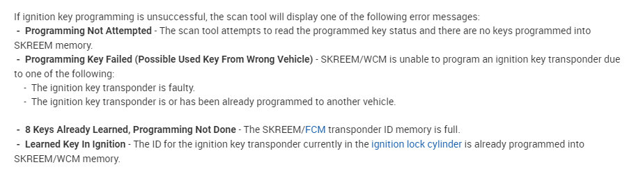

I was wondering how they were able to program this to your vehicle without being connected to the vehicle but all they did was put your VIN in the module but that does not complete the process. Basically the PCM needs to have what is called the secret key programmed into it. Unfortunately the only way to do this is to have a scan tool capable of doing this perform the attached functions.
