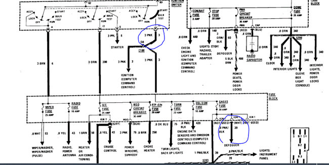

Good afternoon,
Make sure the pink wire going to the cap has power with the key in the on position.

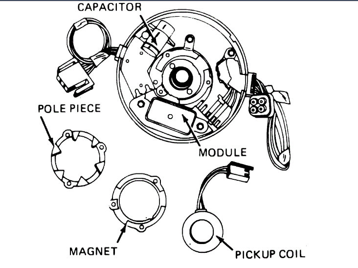

Beyond that, there is a pick up coil in the distributor that was a common failure. I attached a picture of the pick up coil.
The distributor has to be removed, the gear pin removed the gear removed from the shaft. Then remove the shaft and you can remove the pick up coil.
Also, does the rotor turn when you crank it?

This pink wire you mentioned , where is it located? And about the pick up coil, that's what connects to the ignition module right? Just to be sure I'm looking at the pic correctly..

Yes, that is the piece that attaches to the module.

So if i get no power from the pink wire what would I need to do? And I really do appreciate all the help.
Aug 11, 2020 at 2:59 AM

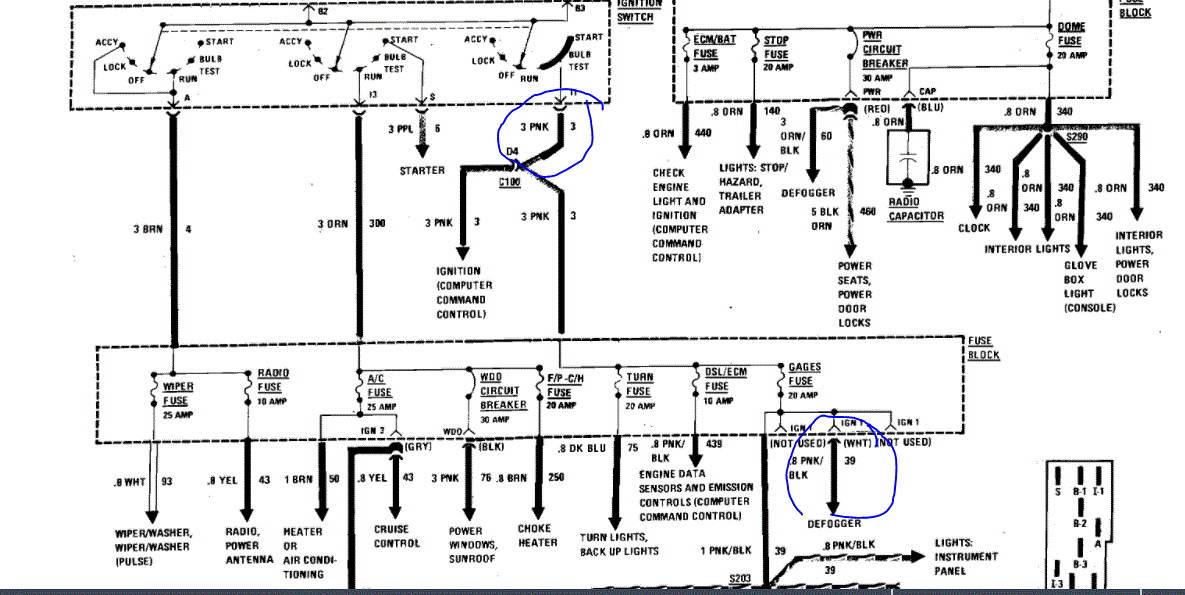

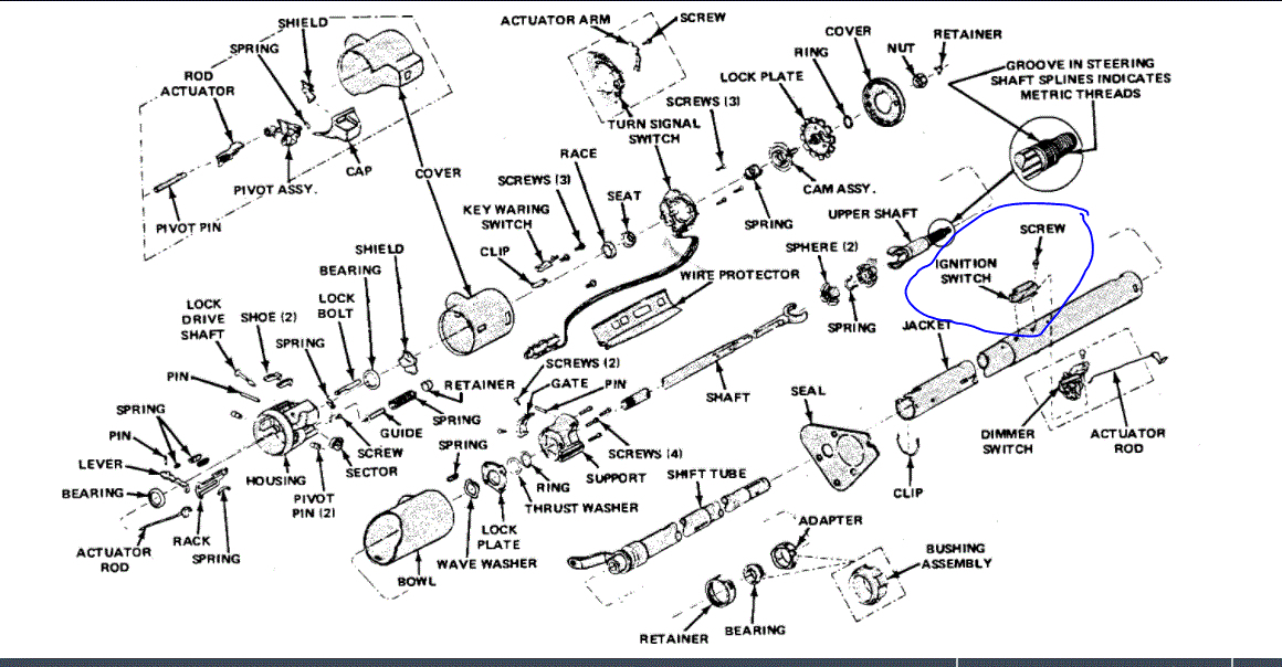

That comes from the ignition switch.
I attached the wiring for the ignition switch and the location of the switch.
Aug 11, 2020 at 3:07 AM
RJANDIANNA
  • 33 POSTS
I believe the pink wire is getting power I checked it with my meter and the red light came on. I am going to check the pickup coil and go from there. I appreciate it thank you will let you know my results.

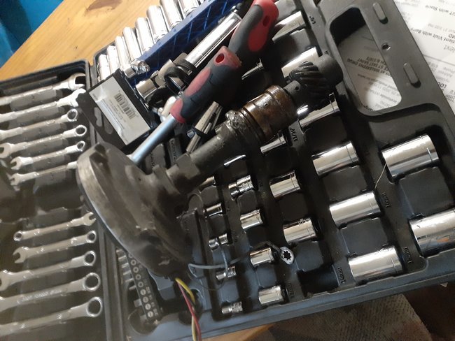

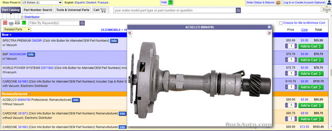

I went ahead and took the whole distributor out and ordered a new distributor is coming with the electronic components as well. my question is, once I put that in I know I might have to find top dead center and after I do that is there anything else that I need to know that should give me spark or stop me from getting spark?
Sep 3, 2020 at 4:31 AM
Okay, did you mark the way the distributor came out?
You need to mark the position of the rotor and the vacuum advance.
Let me know when you are ready to install it. Then we can go over how to set it.

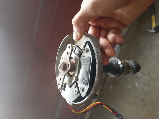

Okay, I'll let you know when it come in and I'm ready. but about the vacuum advance I don't see one on my old distributor so what would I hook the line up to?
Sep 3, 2020 at 5:28 AM
Can you post a picture of your old distributor?
Sep 3, 2020 at 5:34 AM
RJANDIANNA
  • 33 POSTS
Here it is:
Sep 3, 2020 at 6:33 AM
Okay, good. You do not have a vacuum advance since you have CCC.
Let me know when you are ready.
Sep 3, 2020 at 6:35 AM
RJANDIANNA
  • 33 POSTS
Well, I hope I bought the right part because I think the one I bought is coming with the vacuum.
Sep 3, 2020 at 6:46 AM
If it is, it is incorrect.
I attached the correct one from Rock auto. It does not have the vacuum advance.
Sep 3, 2020 at 6:50 AM
