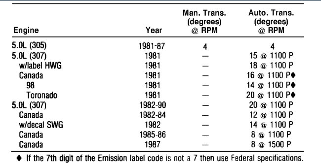

As I stated back a few posts, you need a timing light to read the location of the distributor.
Did you get the timing light?
I attached the procedure below for you.
Set timing at low idle and Before Top Dead Center, unless otherwise specified. Disconnect and plug distributor vacuum line, as equipped, at distributor.
1982-86 1.8L (112) FI, 2.5L (151), 4.3L (260), 5.0L (307) engines, ground diagnostic connector.
1982-86 2.0L (122) FI, 2.8L (173) FI, disconnect EST bypass connector (single connector, tan/black wire).
1981-90 all others W/carburetor, disconnect 4-wire connector at distributor.
Timing MUST be set to specifications on emission label, if different from setting listed. If Check Engine" light comes on during procedure, remove ECM fuse to clear.
Sep 7, 2020 at 2:43 AM

Do you have a timing light to check the timing?
I posted the procedure for setting the timing and specs are attached.
1981-90 all others with carburetor, disconnect 4-wire connector at distributor.
Nov 22, 2020 at 10:07 AM
