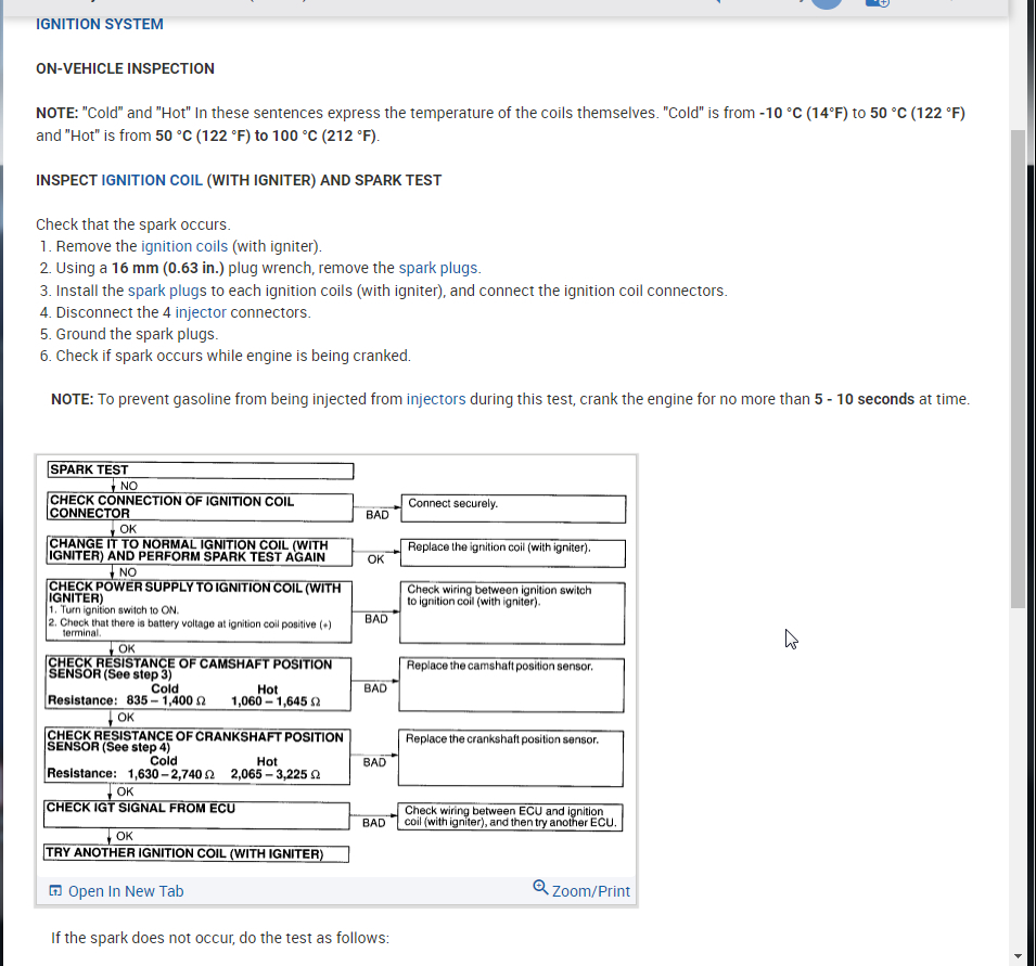

Let's start with fuel as that is the easiest. Use starter fluid sprayed in the intake and crank the engine. Does it start for a second or two? Then pull a spark plug and hold it against the block and crank the engine. Does the plug spark?

We replaced it with the same engine, used. It is getting fuel. we cranked it with the fuel rail out and the injectors all worked. Pulled plugs. no spark. The compression is 100-120.
Dec 29, 2020 at 1:12 AM

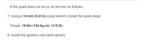

Okay. That compression is low. It should be around 145 +/- 15 PSI. However, if you are not getting spark we need to follow the testing attached.
Just make sure the theft light is not on or flashing. Let me know what you find with this. Thanks
