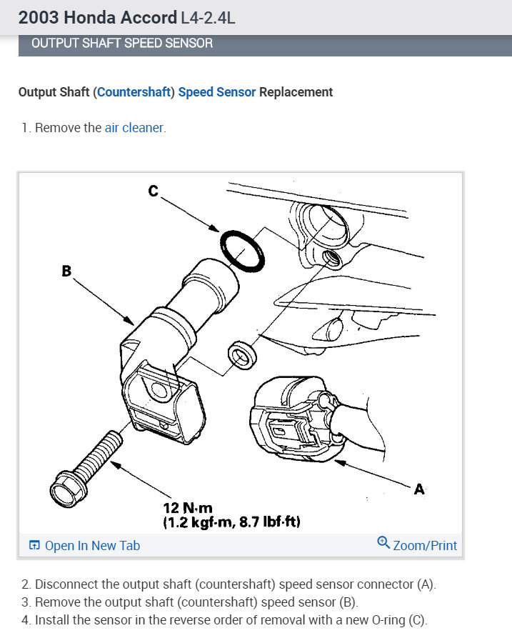

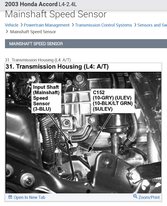

It sounds like the VSS is going out (vehicle speed sensor) here is the location of the sensor. Check out the diagrams (Below). Please let us know what you find. We are interested to see what it is.
Thursday, May 2nd, 2019 AT 2:12 PM

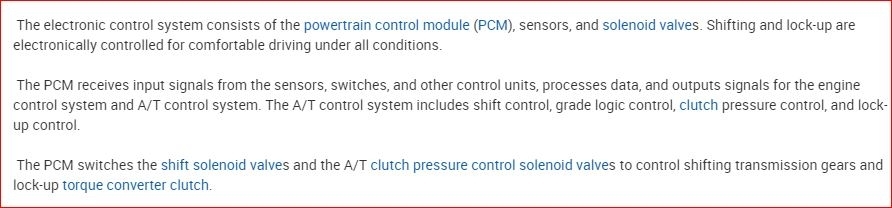

Hi FloridaMan,
There will be codes in the system so those will definitely point us in the right direction. However, from what you describe it very well could be related to the check engine light. However, the issue you experienced is a form of protection mode that the PCM puts the transmission into when it sees something that could be catastrophic to the trans.
When you said it felt like it was in neutral, that is because even though the shifter said it was in Drive the computer took it out and put it in neutral so that it didn't damage itself.
This could be anything from a simple sensor like a speed sensor, to a module, to a failed transmission. Because of this it is important to get those DTCs.
I attached a description about this trans which will explain how it works in general terms. When it says the PCM receives input signals, these are the sensors and other things that the PCM needs to monitor in order to function properly.
Feel free to run what they are recommending past us if you want us to see if it makes sense. Thanks
