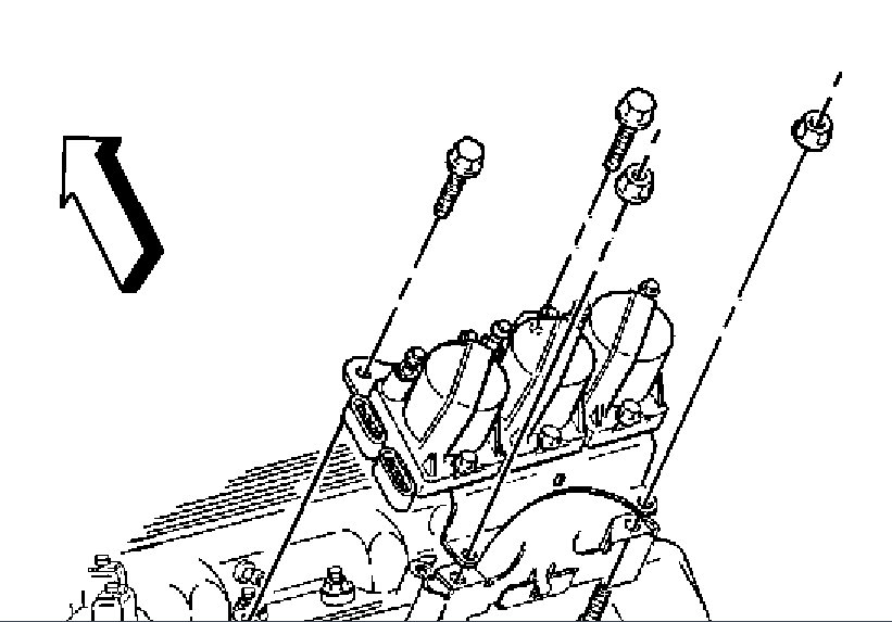

Okay, car was stalling and tap on gas it would start. so we put a new fuel pump on. they said that was it. well it's really bad now, it stalls in mid drive I'm going 60 and the car just stops. I get down to 40 mile per hour and stalls while driving have to hit gas tank to restart. then sometimes it runs great. shakes around 50 to 60. I like this car but I've but more into it then I payed for it almost. please help
Nov 17, 2019 at 9:53 AM
Good afternoon,
This sounds like it could be the ignition module or the crank sensor.
https://www.2carpros.com/articles/engine-stalls
You will need a scan tool to monitor the sensor operations and the module as well. It sounds like the spark is dropping out.

The machine says it's a mass air flow circuit performance p0101.
Nov 18, 2019 at 10:49 AM
You never mentioned it had a code.
Are there any other codes?
Did you replace it yet? I doubt that is the issue.

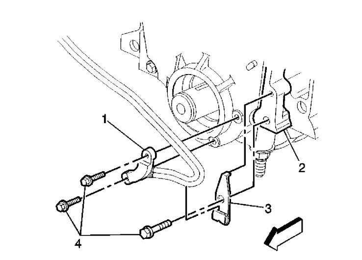

Did anyone verify those parts failed before replacing them?
Did you or a shop replace both crank sensors?
Nov 30, 2019 at 6:48 AM
100000
  • 6 POSTS
No, I don't think. so I will find out Monday it does not throw codes.
Nov 30, 2019 at 7:18 AM
Not looking for codes.
This sounds electrical. Ask about the other crank sensor.

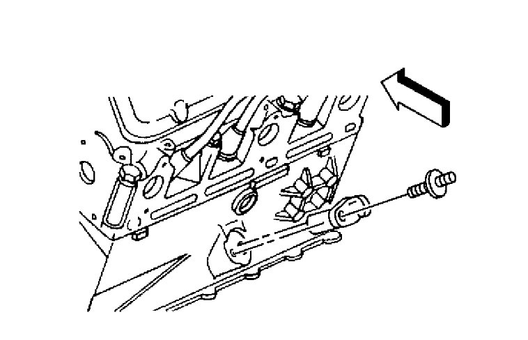

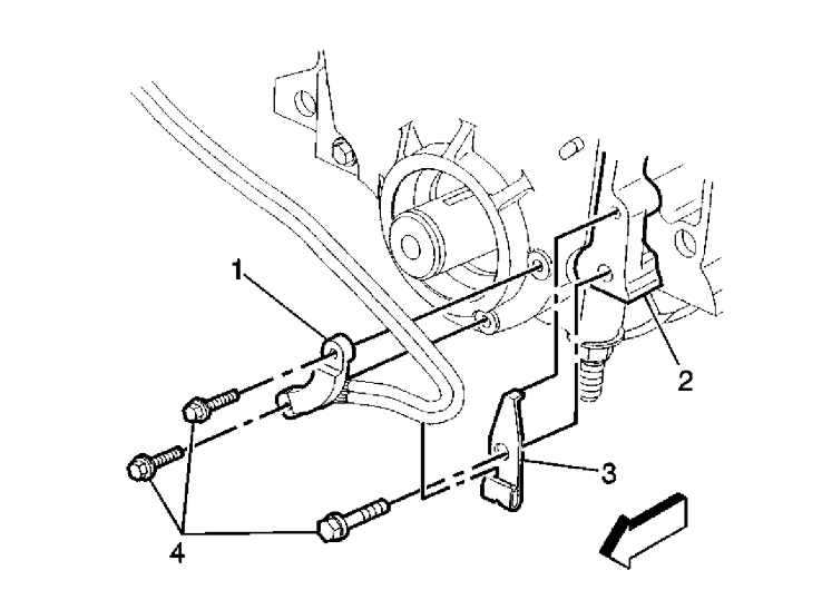

He said it only has 1 crank and 1 cam sensor and both we changed.
Nov 30, 2019 at 7:17 PM
Sorry he is wrong. There are 2. I am sure when he ordered it they asked him which one the 7 times or 24 times.
I sent you the location of both sensors.

Okay, still says only has one of them parts it runs and drives without shutting off, but still spits and sputters when gear change. Will on go 30 mph going up hill gas to the floor and no speed up hill until I get to a point with I let off gas and hit again gets a little better. until level car out of hill.
Dec 3, 2019 at 10:39 AM
There are 2 sensors. he is incorrect.
