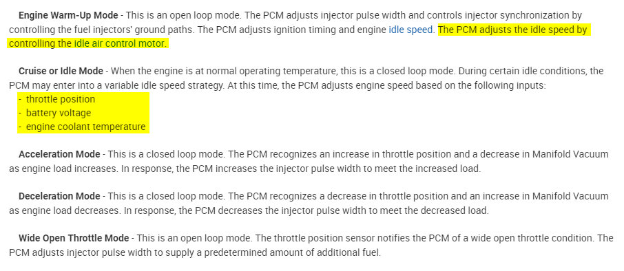

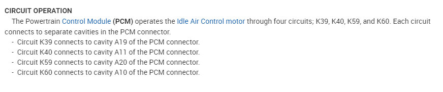

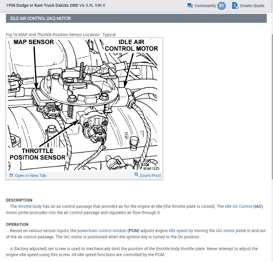

This could be a number of different items. I attached some documents that explain what is happening during idle. This could be the idle air control motor but if this happens at different times and the throttle does not return quickly I suspect the throttle position sensor has failed. These are really easy to replace and cheap enough that if it were me, I would just go ahead and replace it based on experience. If that is not the issue then we can dig further.
Review this material and let me know what you think. Thanks

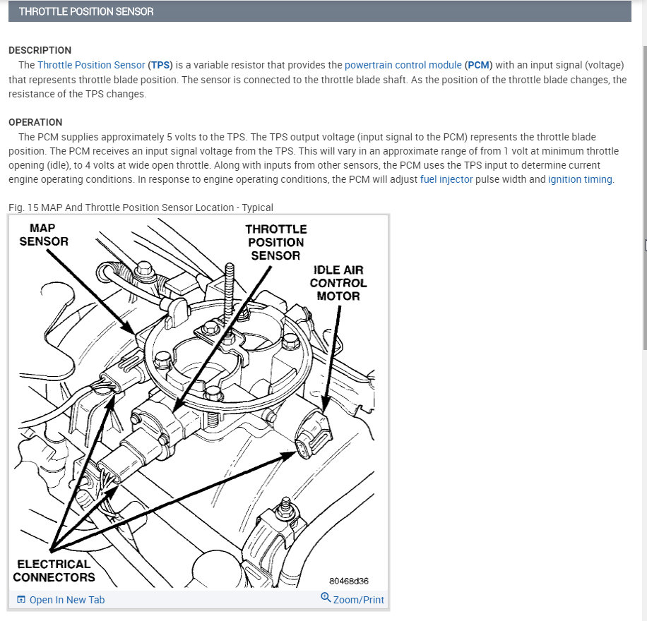

Only if they are outside of a predetermined range. However, if the throttle sensor stays with in this range, the PCM will just think the throttle is opening and closing. It was for these reasons and others that OEMs starting developing checks and balances in more modern cars.
Basically, they just added a second sensor that the PCM needs to see them in half of the other. This way the PCM can see if one sensor is out of range and it will set a rationality fault. Your truck does not have this. You have a throttle cable that attaches from the pedal to the throttle body and this sensor reads the movement of the throttle plate on the throttle body.
As you can see under the operation, the PCM will adjust fuel and ignition based on this sensor so if it is ranging up and down, the PCM will add and remove fuel which will bring the RPM's up and down. Stepping on the accelerator changes it but if the sensor sticks there, the RPM will remain high as you are describing.
Sep 3, 2019 at 1:21 PM

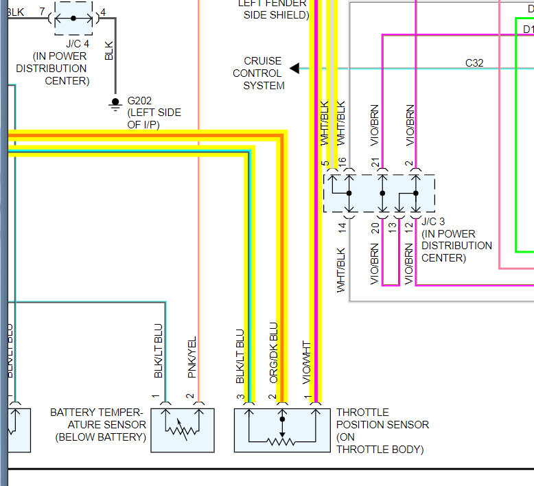

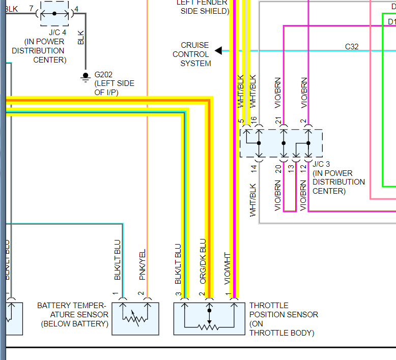

Here are a couple videos of similar issues. These are a not the same year as your vehicle but the similar complaint. I don't think they called it the correct name. It is not the idle position sensor. It is the throttle position sensor as shown in the diagram.

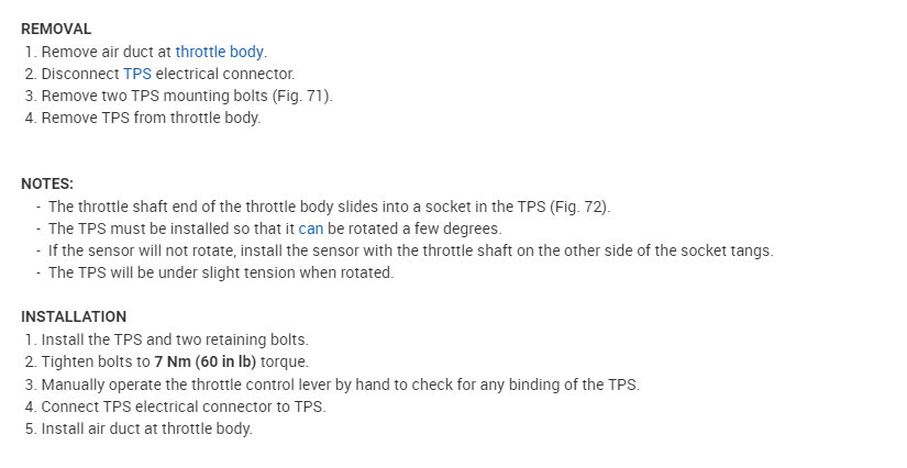

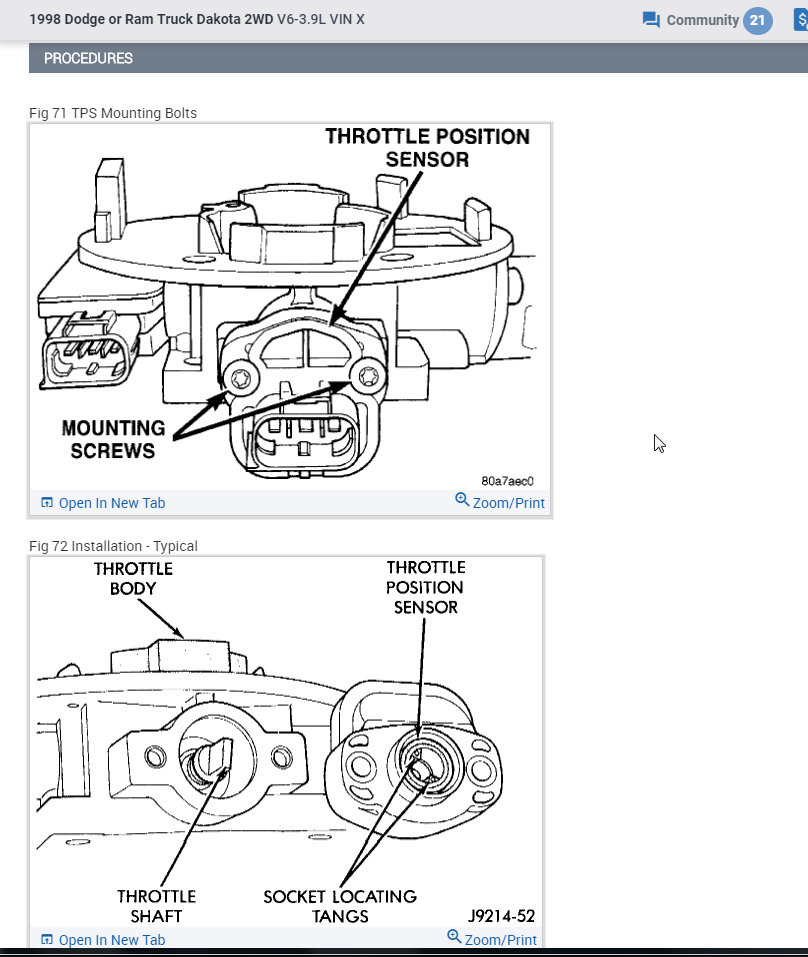

After I change the TPC should it work automatically or is there anything I have to do first? Thanks
Sep 3, 2019 at 1:38 PM
Good question. There is no programming for this sensor. It is plug and play. Here is the instructions from the manual. Just see step 3 on the installation. That is just checking the mechanical operation. However, there is not programming required.

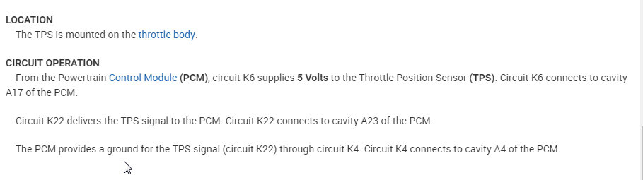

Okay. Then you may have a wiring issue if those numbers are accurate. However, we need to make sure we have the meter set on the right scale. You are correct that there should be 5 volts but this is just the supplied voltage. We want to see what the orange with dark blue wire is saying while this is acting up.
This wire should be between 1 volt and 4 volts. The lower the voltage the closer to idle the engine is. 4 volts is wide open throttle. If this voltage is accurate then the PCM is most likely the issue.
Also, the violet with white wire is the 5 volt supply and the black with light blue is the sensor ground.

Put your red lead of your meter on the orange wire and then the black lead of the meter on a good ground like the negative battery post. Start the engine and when the RPM is ranging, watch the meter and see if it is moving or not. If the engine is idling, the throttle plate should not be open very much so you should have about one volt. If the sensor is faulty I would expect to see the voltage ranging up and down and hence the RPM is going as well. Since you just replaced the sensor I suspect it is okay. If this is the case, then we need to find what is causing the RPM to range which is most likely the PCM. However, we have not gotten to that point so don't just replace the PCM because I would hate to just make a couple hundred dollar guess.

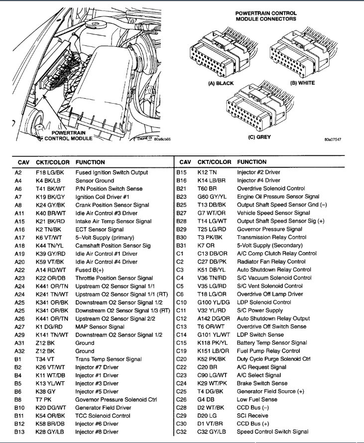

Can you find me the PCM pin out diagram? Thanks
Sep 12, 2019 at 2:32 PM
Sorry for the delay. I have been traveling all week for my full time job. Here is the document that you need. Looks like the middle connector (B - White connector) has a pink wiring that is for the governor pressure control. The pink and black is the transmission relay control. Hopefully this helps. Let me know what you find. Thanks

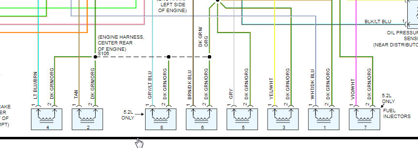

If some reason if the injector driver wire was hooked up to the wrong wire would it cause the problems I’m having ?
Sep 13, 2019 at 4:16 PM
Well I can't say I have ever tried that to see how the engine runs but if the driver wire was not correct, I suspect the injector wouldn't operate. This is a ground side control. That means the PCM grounds that driver wire and that opens the injector. The other wire is a constant power wire when the key is on coming from the ASD relay. When the PCM wants the injector to fire, it grounds that driver wire, the injector opens and then it removes the ground creating an open circuit and the injector closes. Assuming the wire that is there rather than the driver is a wire with voltage on it, I suspect the injector will just remain closed or possibly fail. If the wire that is there rather than the driver wire is a ground wire then the injector would be open all time. Either way, I would imagine you would have a dead misfire on that cylinder.
Plus, you would have a DTC for an injector circuit issue.
Are your injector wires a different color? Remember this lists all 8 injectors so your engine does not have 7 or 8.
