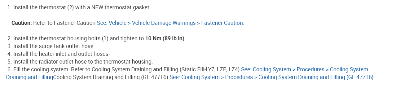

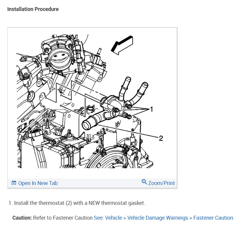

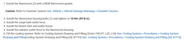

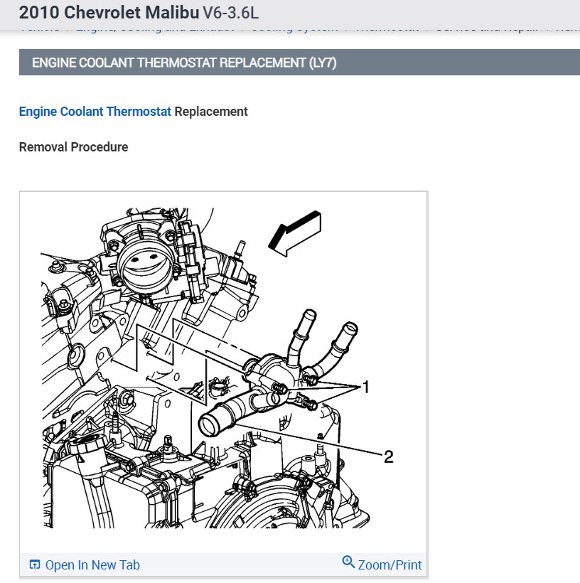

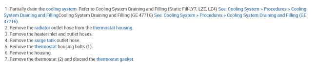

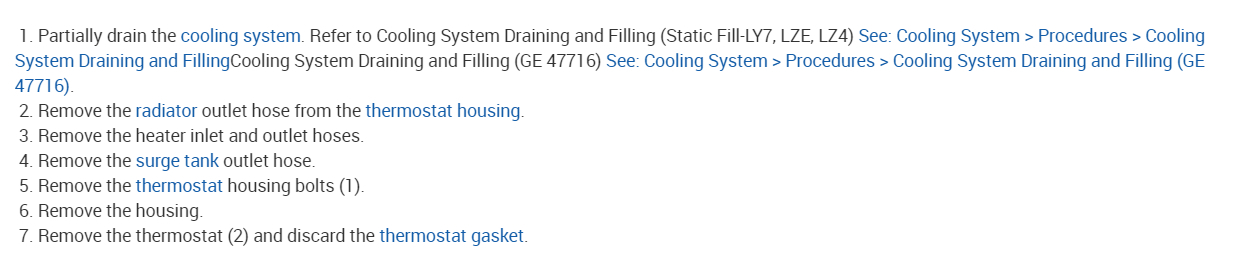

Yes, the thermostat is the first thing I would do. Also, I would do a chemical test to test for a blown head gasket. Here is a generic guide to help you step by step with instructions in the diagrams below to show you how on your car:
and
