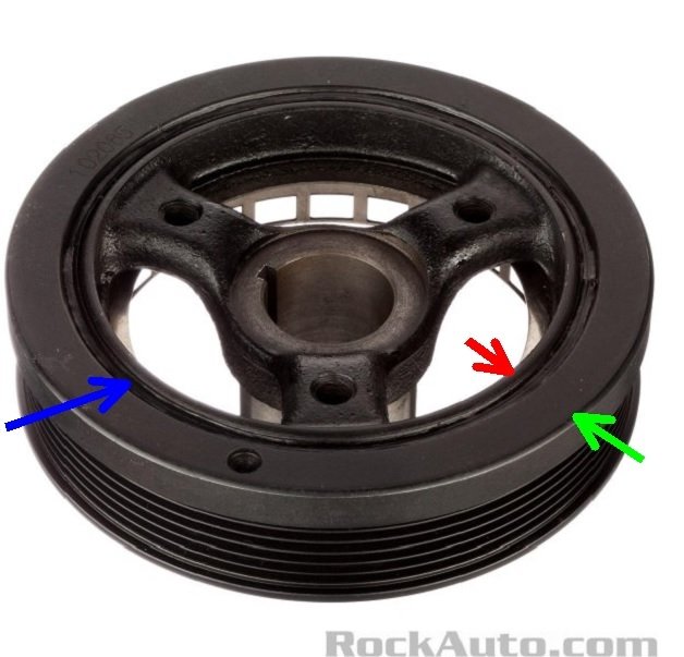

Another thing to look at is the vibration damper. On many engines, the outer ring is the drive pulley for the serpentine belt. If the gel that is bonding that ring to the hub lets go, it can spin and not drive the belt.

Here is a photo of what your vibration damper looks like. The green arrow is pointing to the outer ring, which is the pulley. The blue arrow is pointing to the bonding material that holds the ring to the hub. Sometimes you will see that bonding material looks like it melted and/or sprayed around the area. Sometimes they look perfectly fine, even when the ring is broken loose.
To check for that elusive cause, put a chalk mark or piece of tape on the center hub by the red arrow, and another one on the outer ring, by the green arrow. Now run the engine for a least a minute or two. When you stop the engine and inspect those two marks, they should still be lined up like they were when you planted them. If they have move in relation to each other, that bonding material has let go and the assembly must be replaced.
