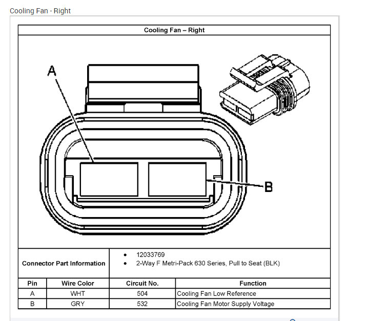

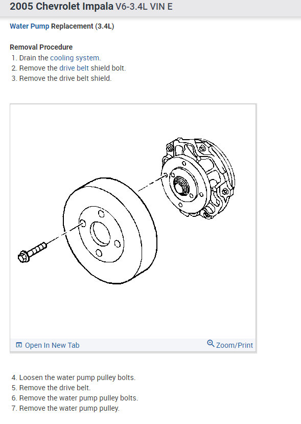

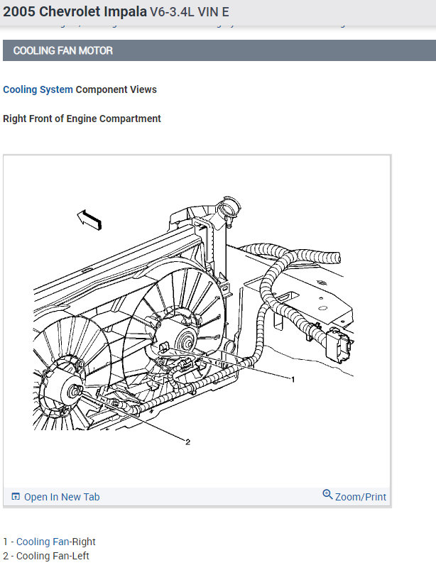

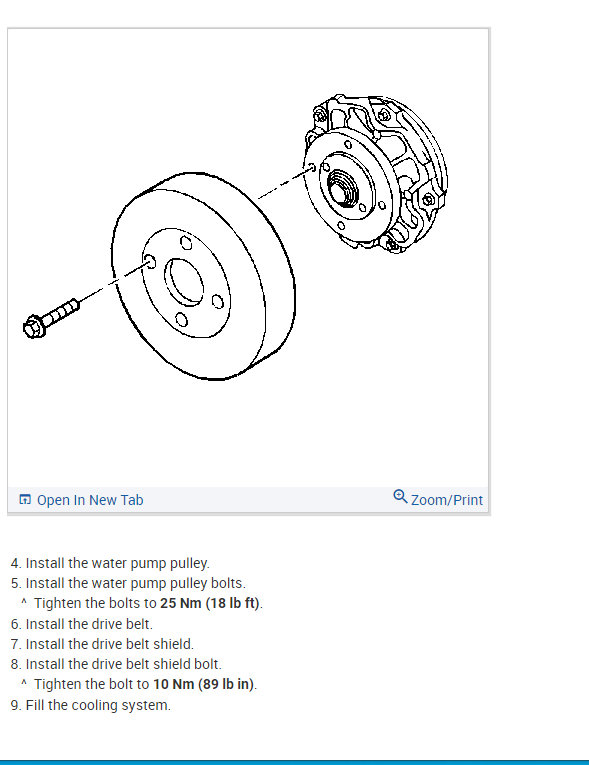

My 2005 chevy impala is running hot. I changed my bypass hose and my thermostat but its still overheating. But, my water pumps looks corroded as well.

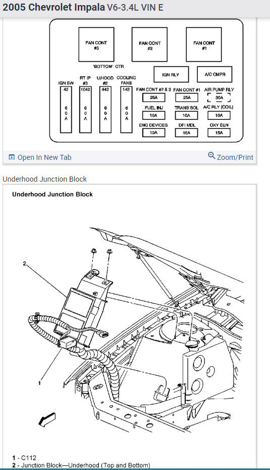

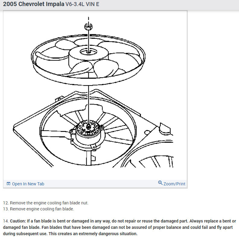

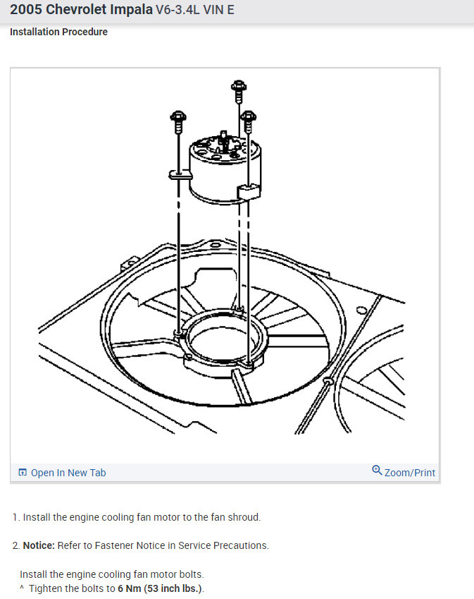

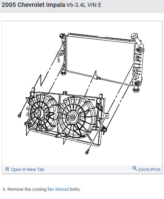

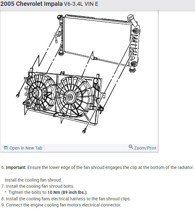

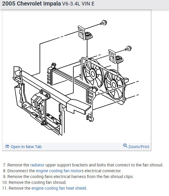

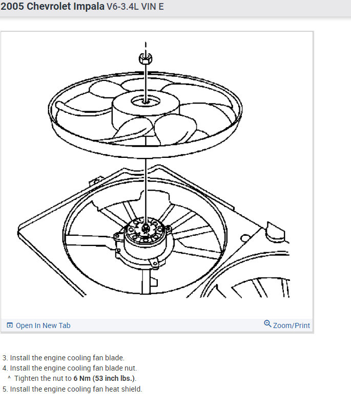

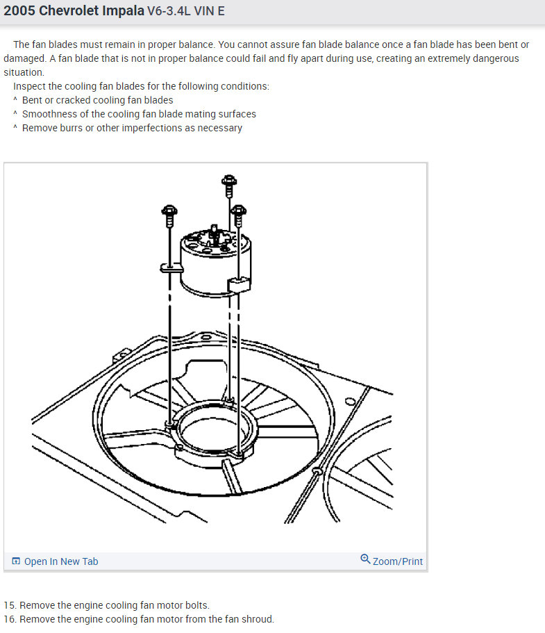

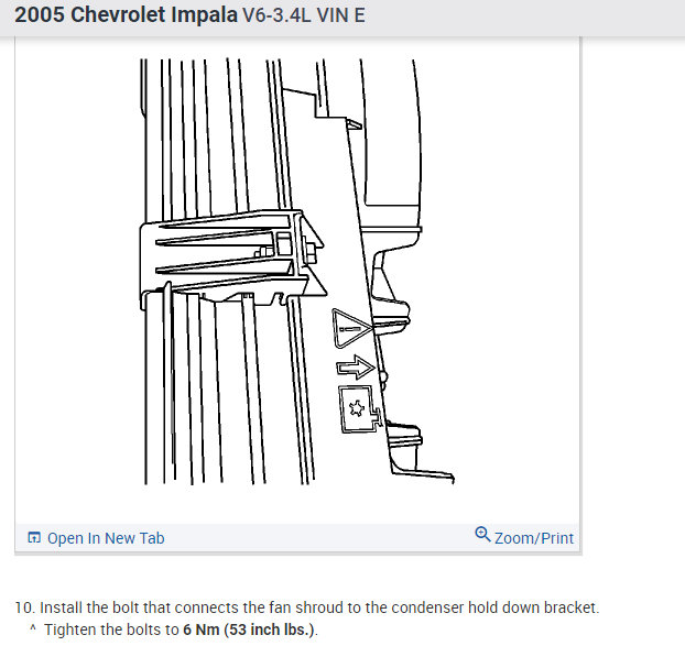

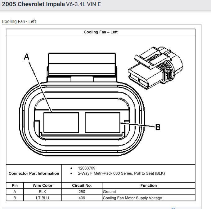

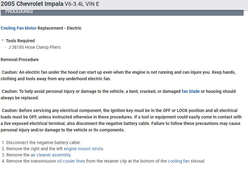

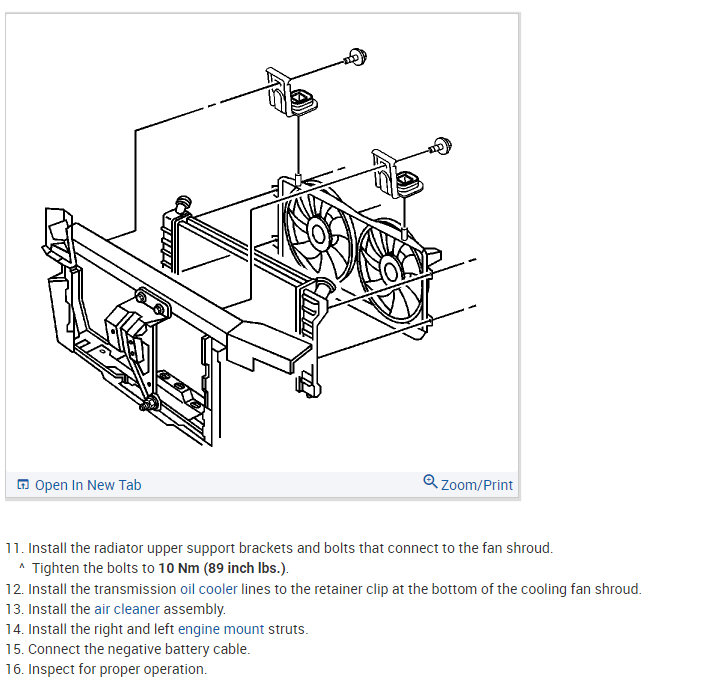

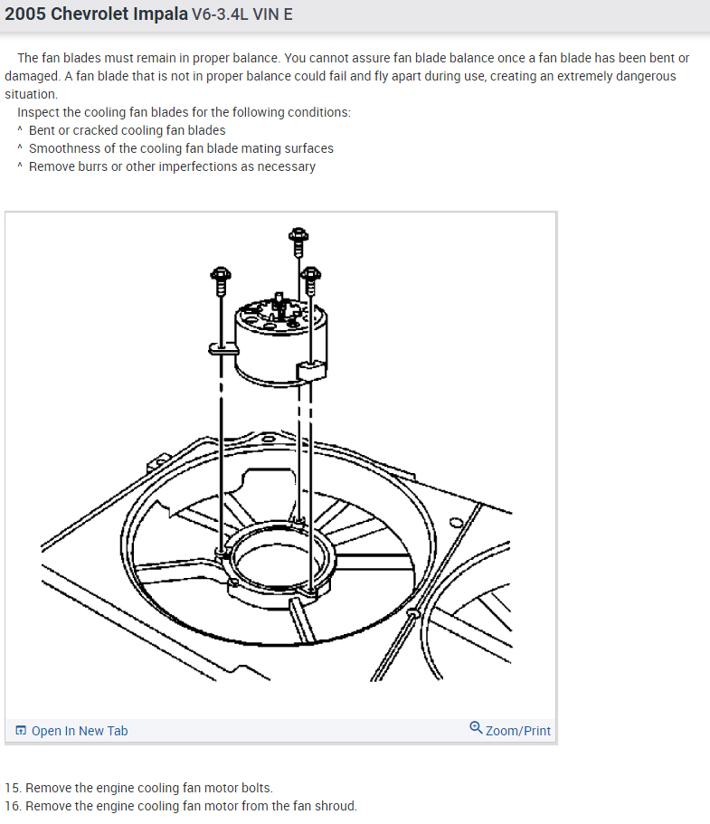

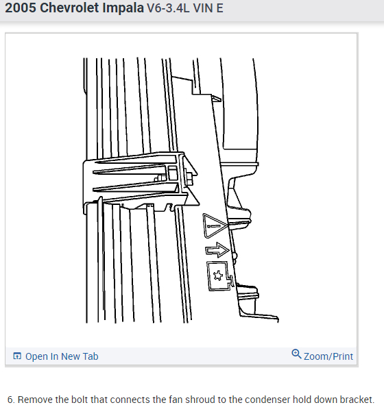

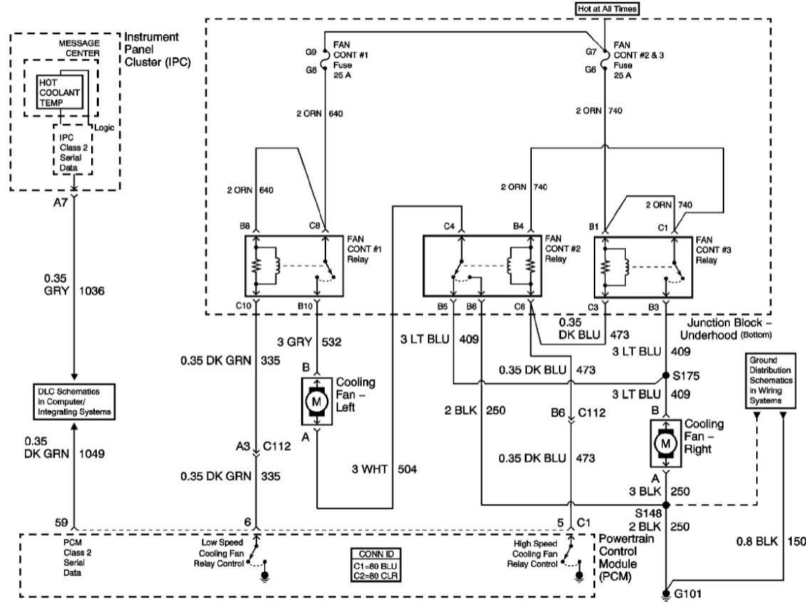

Since you have already replaced the thermostat, check to see if your cooling fan works.
If the fan is not operational the engine will overheat. An faulty can can be caused by a bad fan relay or fan motor. First check the relay, the fan relay is located under the dash fuse box (see diagram below).
https://www.2carpros.com/articles/how-an-electric-cooling-fan-works
https://www.2carpros.com/articles/replace-electric-fan-motor

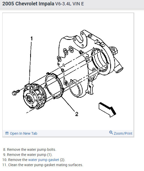

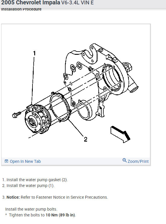

Other reason of course the water pump.
If the water pump does not circulate the coolant properly the engine will overheat as well.
https://www.2carpros.com/articles/water-pump
https://www.2carpros.com/articles/symptoms-of-a-bad-water-pump
https://www.2carpros.com/articles/water-pump-replacement
I have attached the cooling fan as well as the water pump replacement procedure for your reference.
