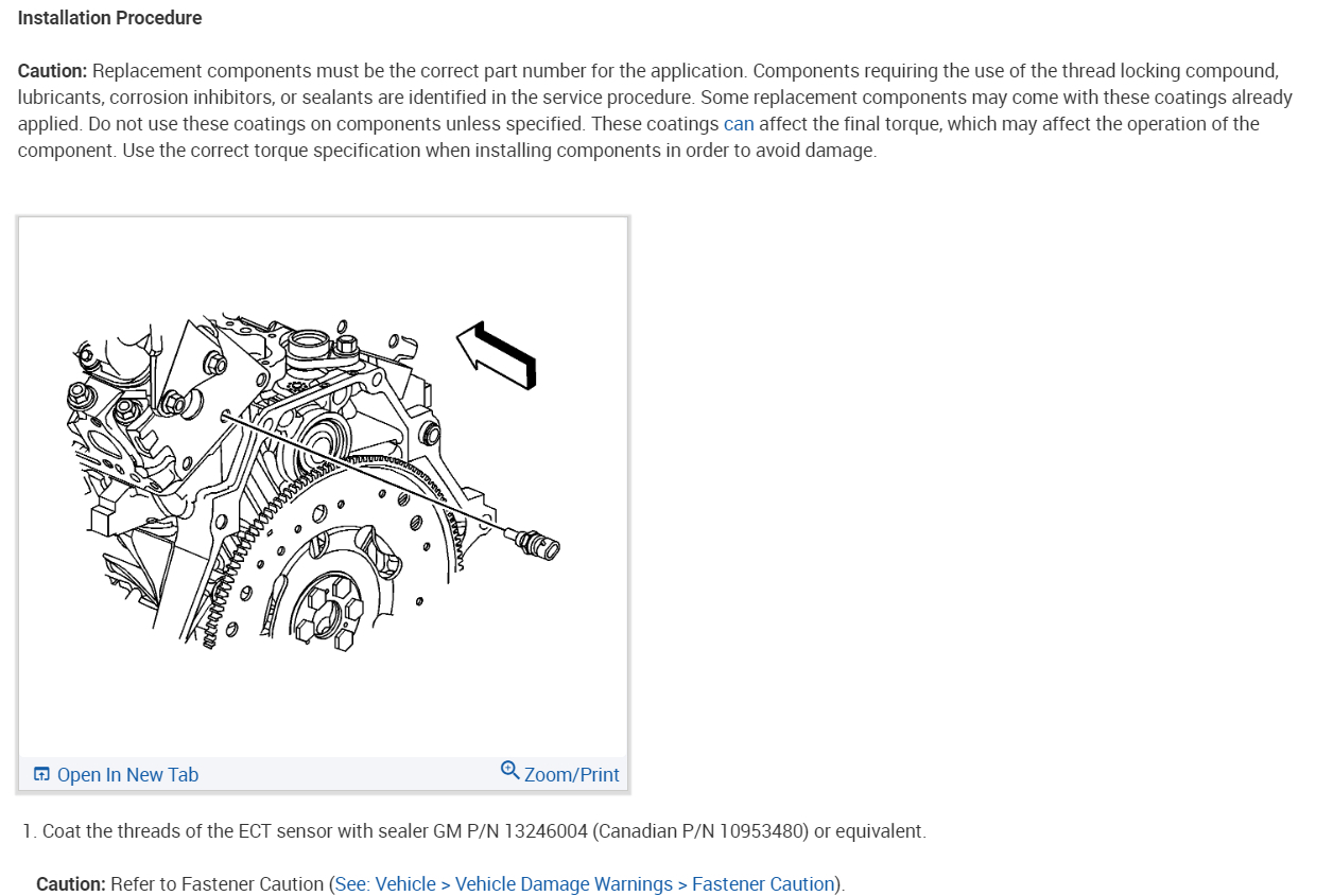

today my dash read: engine hot a/c off after about 5-8 miles or so, what could it be the engine overheating it doesn't seem like it though?

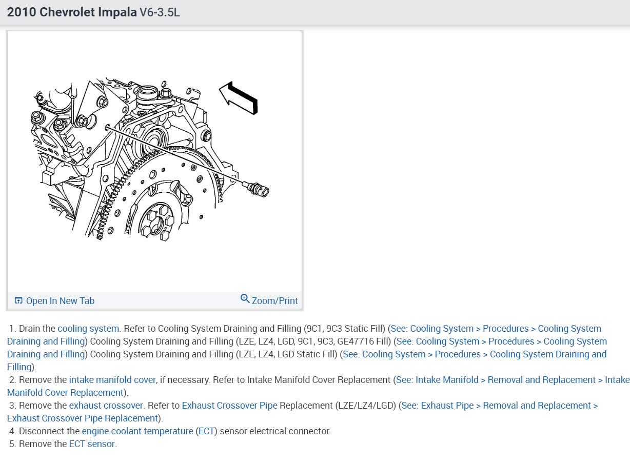

Was the engine overheating? if not I have seen the engine temperature sensor intermittently short out causing the is problem here is a guide to help see if the engine is overheating and how to fix it with the engine coolant temperature sensor location in the diagrams below.
https://www.2carpros.com/articles/engine-overheating-or-running-hot
Check out the diagrams (Below). Please let us know what you find. We are interested to see what it is.

i was going about 55-60mph on the open road highway, the engine was not over heating, everything seems fine, i didnt see any smoke nor smelled any inaccurate odors, the engine sounded fine also, the only thing that bothered me was that the temp meter was all the way down to C it usually moves up a little when driving.

Most likely the temp sensor it bad.

Thank you for this post I had this problem and had to get a new coolant temperature sensor for 56.00 all fixed! This site rocks water back :)
