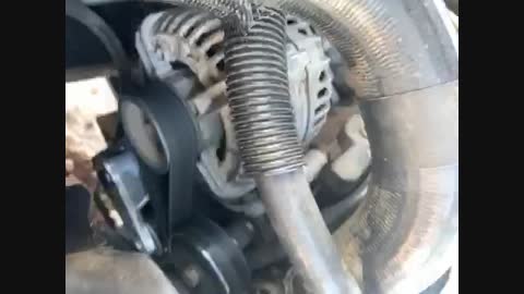

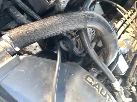

AFRAUSTO94
  • 16 POSTS
So, I put the new battery on and tried to start it, it started and I looked and none of the pulleys were spinning besides the very bottom one but then I tried again and was watching the pulley in the very bottom one was spinning but none of the others then when I went to take the belt off to put a new one on the belt wasn’t put on the tensioner so I’m letting the battery charge and then going from there. Also, another thing that happened was the drive side window started falling down, I don’t know if it could be related to anything going on. Just thought I would throw that in there.

Has a little bit of trouble, and one of the pulleys is squeaking.
Dec 3, 2019 at 5:49 AM
Sounds like the idler pulley. Remove the belt and spin it by hand.
What is the voltage at the battery with the engine running?
Dec 3, 2019 at 6:25 AM
AFRAUSTO94
  • 16 POSTS
Okay.
And the voltage of the battery is 14.3.
Dec 3, 2019 at 6:30 AM
Okay, need to find the source of the noise.
Dec 3, 2019 at 6:39 AM
AFRAUSTO94
  • 16 POSTS
Is the idler pulley going to be the one on the right side of the alternator pulley, above the tensioner?
If so, we had just replaced it the other day.
Dec 3, 2019 at 7:36 AM
Yes, it looked like the tensioner was replaced but not the idler pulley.
If it was, remove the belt and spin each component one at a time to find the source of the noise.

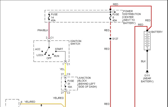

JDL
  • 16,098 POSTS
I would have to check wiring circuits at your starter. Any testing at starter make sure tranny is in park or neutral and the parking brake is set. Check applicable fuses. I would have to be sure battery has a full charge and charging system is ok?

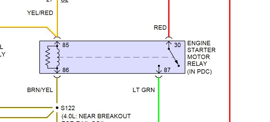

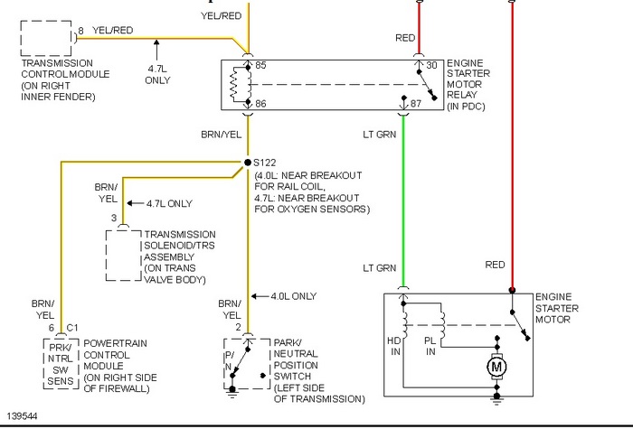

JDL
  • 16,098 POSTS
Just to add, no 6.0 so looked at 4.0L engine. Note the relay, terminal 30 is hot all the time and is fuse protected. When the relay is energized that line with the arrowhead moves to terminal 87 and voltage goes to starter. Also, red wire at starter, hot all the time
The coil side of relay to the left, also needs voltage and ground. I'm not sure about that clkicking noise either relay or starter itself.
Any body else has any ideas, jump in, no problem.

JDL
  • 16,098 POSTS
I don't know of any site that will let you post without registering. There are many reasons to have you register. The least of all is to try to control trouble-makers.
With intermittent issues, you have to test when the problem is ongoing. Below is a wiring diagram for your starter circuit. If you have any questions about the diagram, holler. Any testing make sure the tranny is in park or neutral and the e-brake is set.
