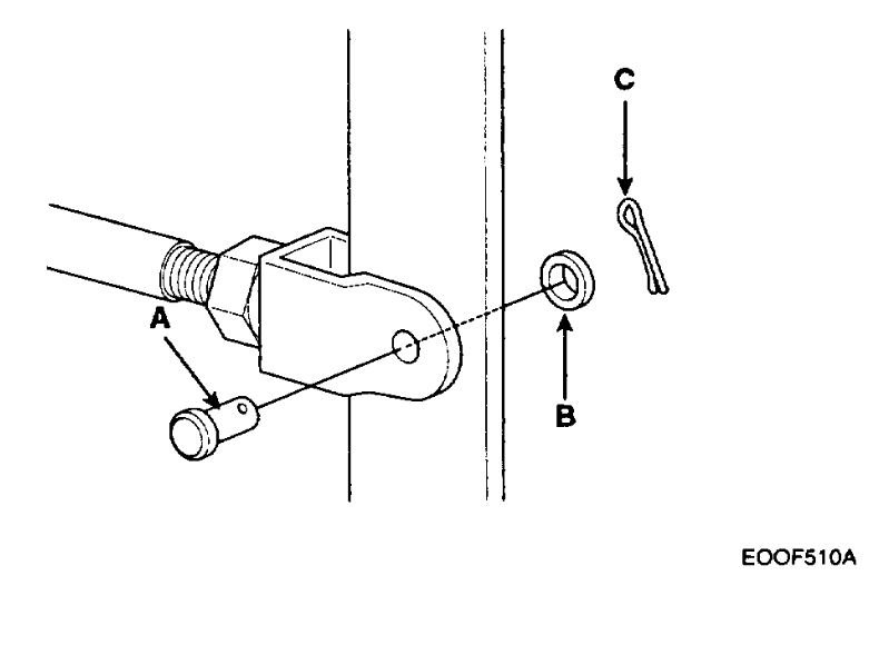

Good evening,
Do you have a good clutch pedal? Does it feel correct with the correct amount of free play?
Are you losing clutch fluid?
I attached a picture of where you adjust the clutch pedal free play. If you loosen this nut and turn the shaft into the master, you can adjust the length of the throw to the slave cylinder.

I have adjusted the clutch pedal and it feels great. But still not going into gear.

If you have proper adjustment and the slave is moving the throwout bearing and it will not go into gear, there is something wrong with the new clutch.
You will need to pull the transmission again and inspect it.
