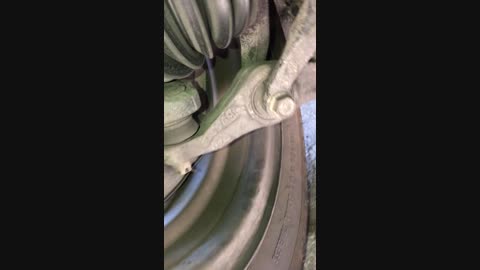

Here is a video I took under the two front wheels. I did not really see much other than a ripped boot on the upper ball joint but I do not think that would be causing the issue.

And that ripped ball joint is on the right side.

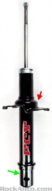

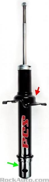

Here is two photos that show the front strut for your car. The green arrows are pointing to the lower end that slides into a pocket on the spindle, then it is clamped there. The red arrows are pointing to the steel plate that's welded to the strut body. This is where the coil spring sits, and where it pushes down to hold the car up.

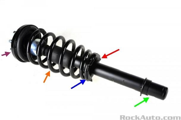

The second photo is of the complete assembly you would get when you buy it with the new spring already installed. The blue arrow is pointing to the lowest loop on the spring where they commonly break. Sometimes you will hear a single, really loud bang when it breaks, but this part of the spring does not contribute very much to ride height, so after that one bang, you may never notice another problem until someone measures ride height. The more dangerous failure is when they break in the area of the orange arrow. This is where a sharp end can go through the tire. The purple arrow is pointing to the upper strut mount. It is a plate that holds the spring compressed when the assembly is removed from the car, and all the car's weight is supported by that mount. There is a bearing in it to allow the strut, wheel, and tire to rotate as an assembly when you turn the steering wheel. Sometimes those get dirt inside the bearings, or they just deteriorate, then they cause roughness, crunching noises, or banging/thumping/twanging noises as you turn the steering wheel. Those noises are almost always only heard when the car is standing still or moving very slowly, as in when backing out of a parking space. Road vibration at higher speeds helps those mounts rotate for steering, so you usually will not notice an issue at those times.
