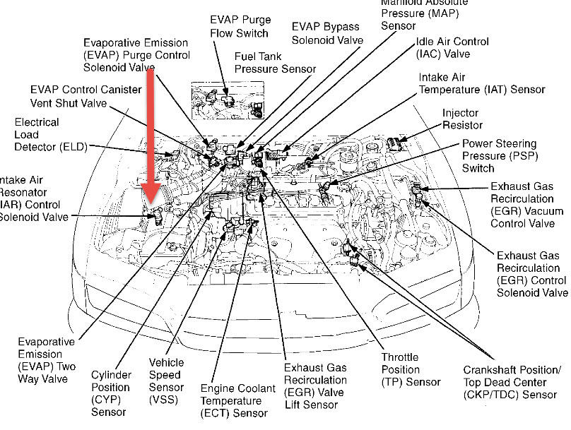

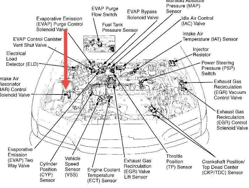

like I said in another reply all grommets on engine duct work leading form air cleaner to engine etc. it screws these cars up with that stuff. if you duct work has ahole in it especially between maf and throttle body it will do what is happening.
Nov 24, 2015 at 12:59 PM
BEN LEE
  • 66 POSTS
Thanks, I'll double check the duct work, but strange enough, this Accord actually does not have a MAF sensor for some reason
Nov 24, 2015 at 1:20 PM
HMAC300
  • 48,601 POSTS

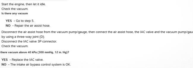

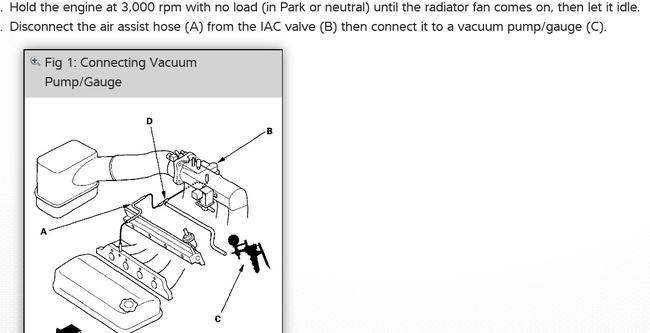

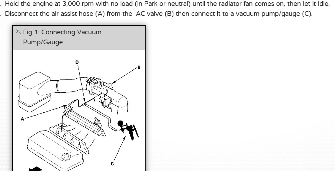

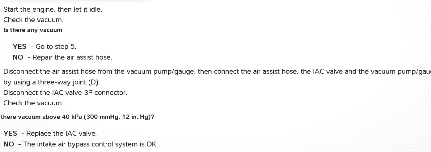

then it uses a intake air temp sensor. one thing you might try when this happens is to slowly turn ignition switch to off but not off see if stops meaning the surging, if it does it may be the ignition switch.also if you have an IAR solenoid which you probably do see if it's sticking open from crap in it or something like that.
Nov 24, 2015 at 3:21 PM
HMAC300
  • 48,601 POSTS
I screwed up on last reply there is no iar solenoid on yours I put wrong year in manual. test the air intake bypass control valve.
Nov 24, 2015 at 3:27 PM
BEN LEE
  • 66 POSTS
Some of the text in the instructions you attached are cut off. Can you post them again

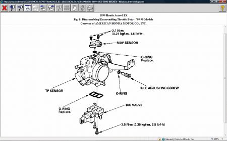

I rinsed my engine compartment yesterday and when I started my car this morning, the engine idle speed was fluctuating between 1000 -2000 rpms. I figured that it might have been due to the moisture from the wash and so I started driving to work. I did not noticed anything different while driving it (26 miles) but when I arrived at work and put the car in park (automatic), I noticed that the idle speed is still fluctuating the same way as when I first started the car. What can i do to fix this problem. Please help. My car is a 1999 Honda Accord V6 EX with automatic transmission. Thanks.

On your throttle body locate the idle air control valve, unplug it and get any moisture out! If the doesnt help you may have shorted it out, and may need to replace it. Try compressed air at the connectors.

Is the idle control valve the one that site on top of the throtle body with the accelerator cable attched to it? If it is shorted out, what or how can I replace? Thanks in advance.

MERLIN2021
  • 17,250 POSTS
No it's on the bottom and has a connector, and a few screws.

ILIKETHIS1968
It idled steady at 1050 rpm after I sprayed it with wd40 then I drove it for 3 minutes and put it in "park" then it started fluctuating again. Why does it run nice and steady when it is in drive and fluctuates when it is in "park"?
