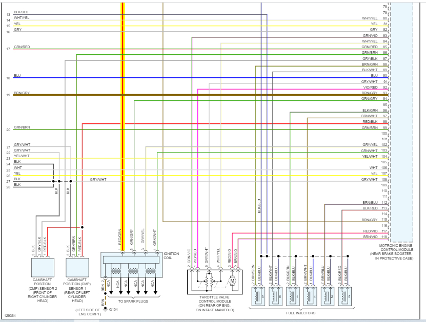

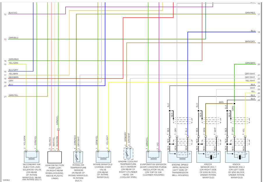

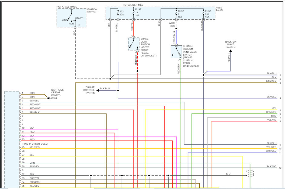

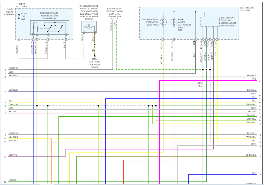

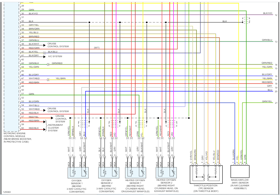

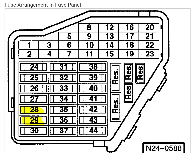

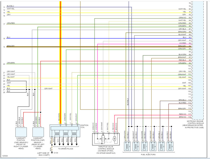

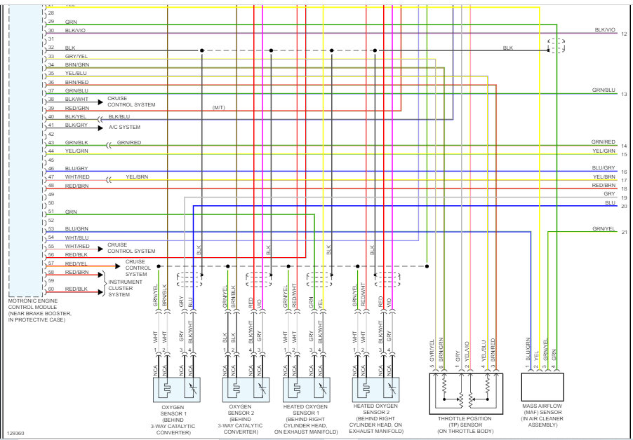

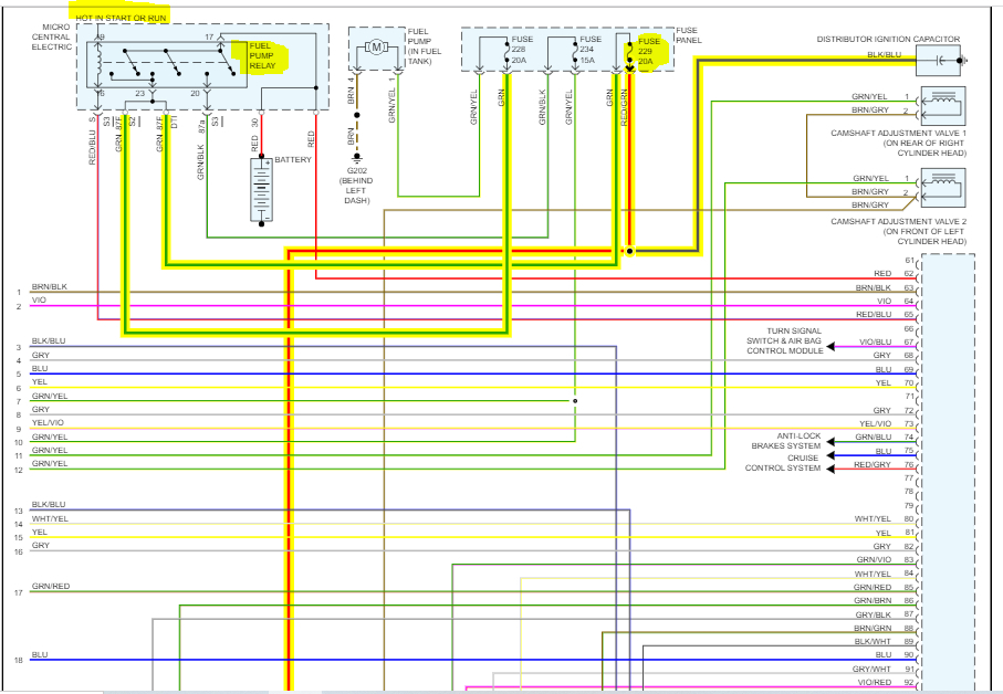

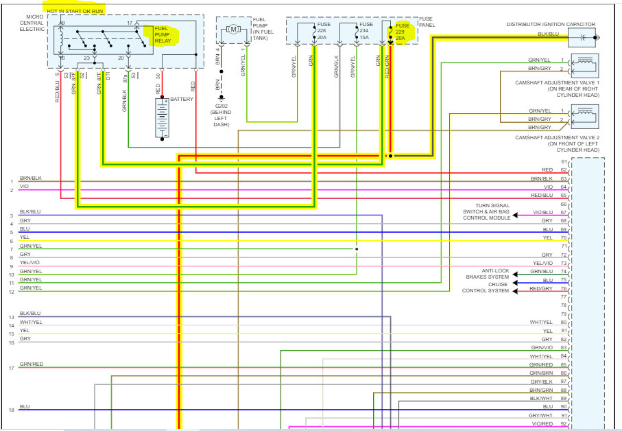

Also, I have attached the powertrain management wiring schematics below. I highlighted fuses I need you to confirm for me. Interestingly, if you don't have power to the ignition coils (red wire), it could be a fuse or the fuel pump relay. And, for the coil to get power, there is a fuse related to the fuel pump that may be bad and stopping power before it gets to the fuse for the pump.
Take a look. If the fuses are good and you have power to the coil and you know the coil is good, then the module is suspect.
See pics below. Note. Fuses 228 and 229 are identified with the additional prefix 2, in the wiring diagram. In the fuse box, they are fuses 28 and 29. See last pic
I had to cut each schematic in half to make them readable.

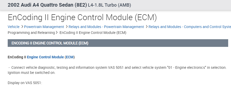

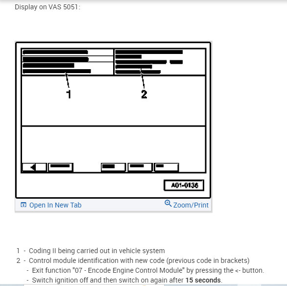

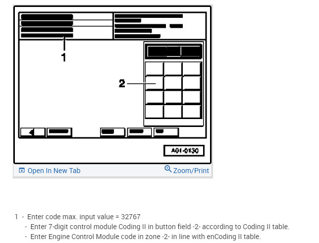

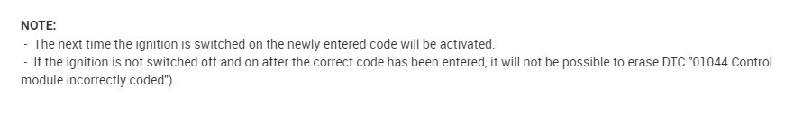

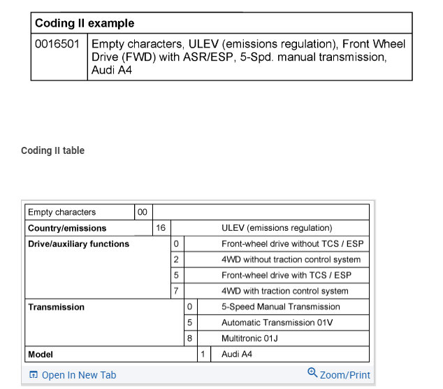

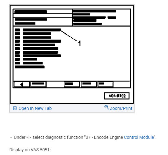

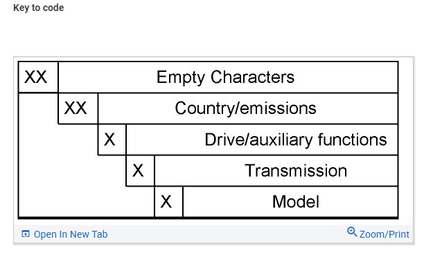

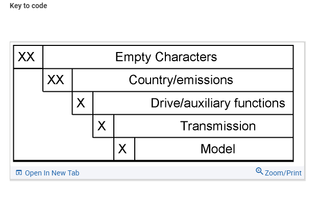

That is correct. If the module is replaced, it requires coding/relearning specific to your vehicle. If I recall, (please know this is from memory) once they are coded, I don't think they can be recoded to a different car. You will need to check on that.
Also, you may be able to find a remanufactured one online.

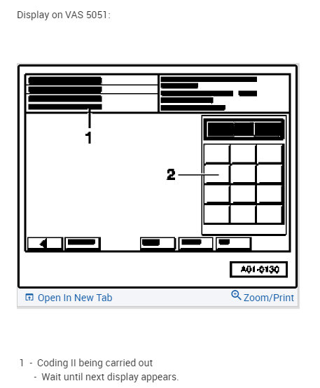

If you look below, I attached the coding directions.
Let me know if this helps.
