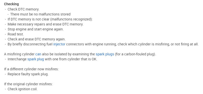

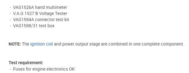

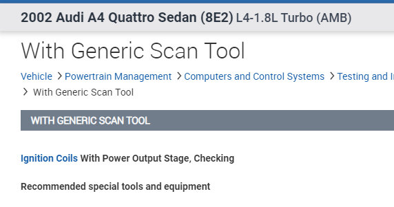

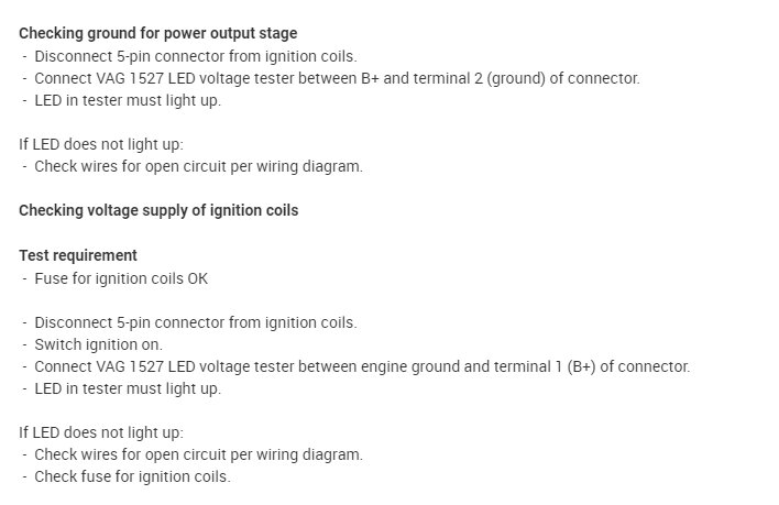

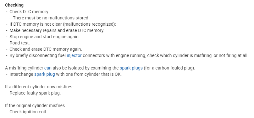

I did a little digging and found diagnostics for the ignition system. It is if one coil isn't working, but you could still test since all are not working.
If you look below, I attached the info. Note: I eliminated part of the directions because it explained how to determine if a coil is bad. Also, the heading indicates testing without a factor scanner. However, it indicates using VAG-COM.
Let me know if this is something you feel comfortable performing.

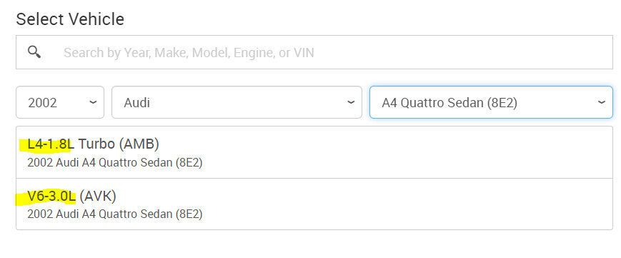

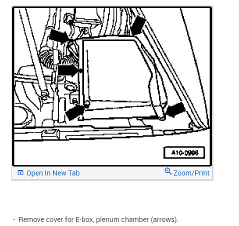

The 2.8L isn't one that was offered. They offered a 1.8L turbo or a 3.0L V6. I need you to send me a pic of what you are referring to. I can't find evidence in my manuals for either engine having an ICM.
See pic below.
Aug 20, 2023 at 11:39 AM

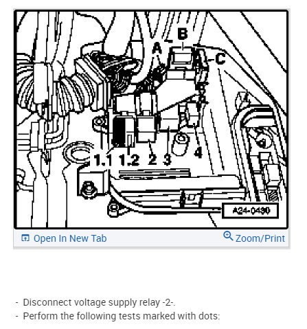

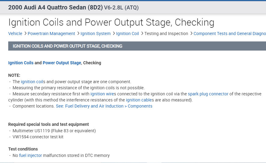

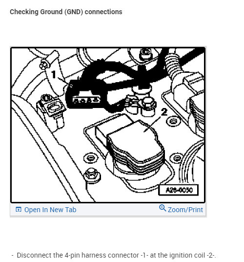

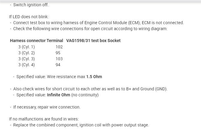

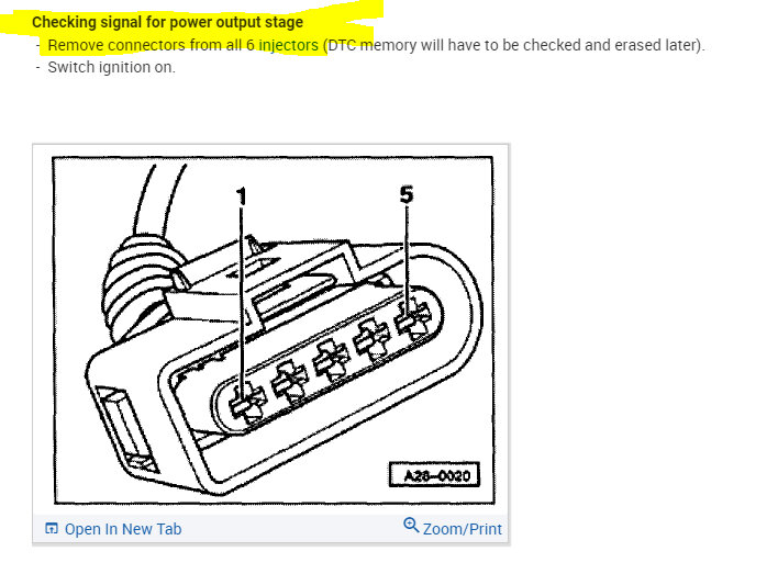

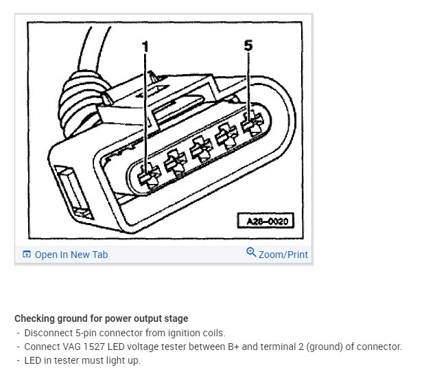

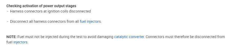

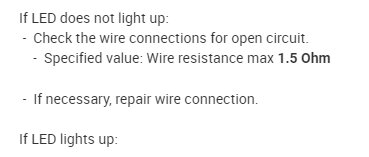

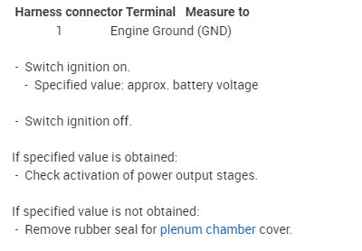

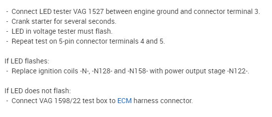

Now, that makes sense. If you take a look below, I attached the diagnostics related to the ignition coils and power output. This is for the 2.8L (2000).
Take a look through the diagnostics and let me know if you are comfortable performing them.
Aug 28, 2023 at 11:08 AM

  • 110,248 POSTS

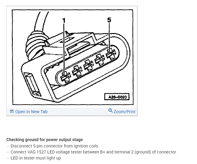

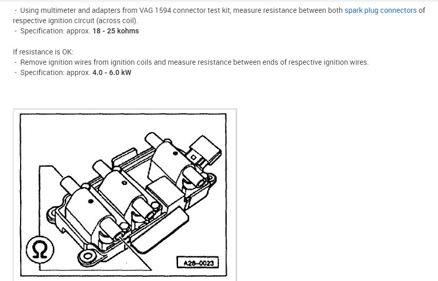

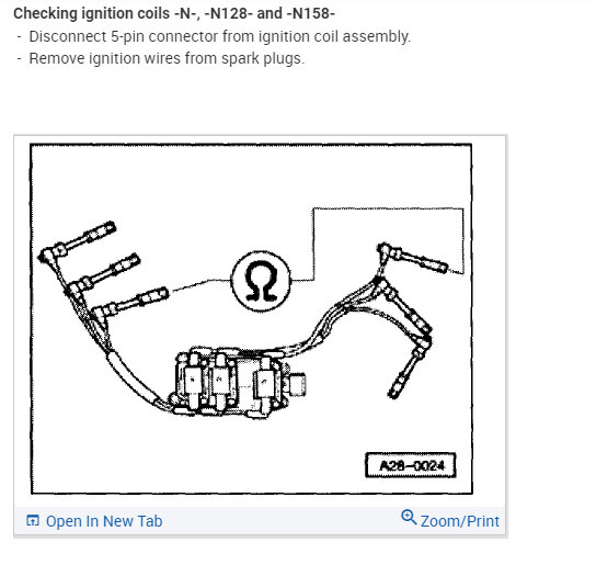

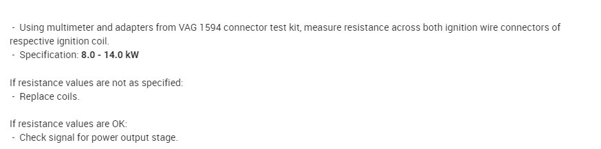

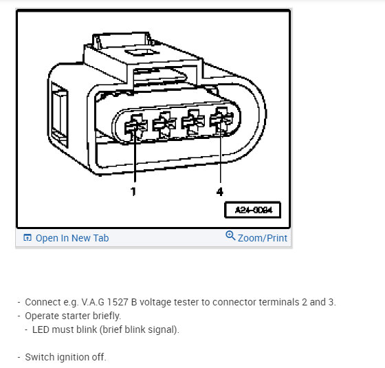

Basically, you are testing the wiring between the coils and the PCM. Also, you will be checking the coils as well.

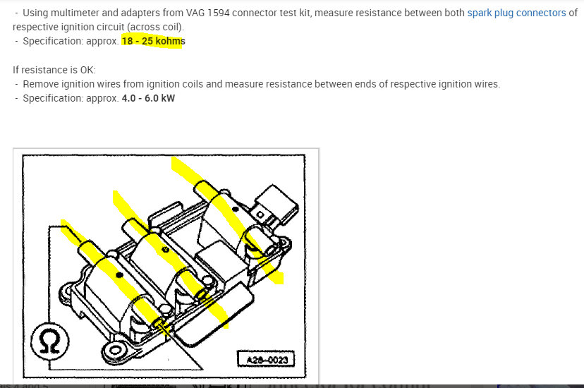

Start with the coils. You will need a multimeter. Set the meter to kohms. The coils work as pairs. So, place one terminal on one side and the other on the opposite to get a reading. See pic below. See if they are within the specifications listed above.
See pic below.

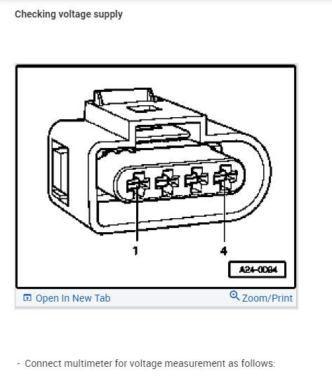

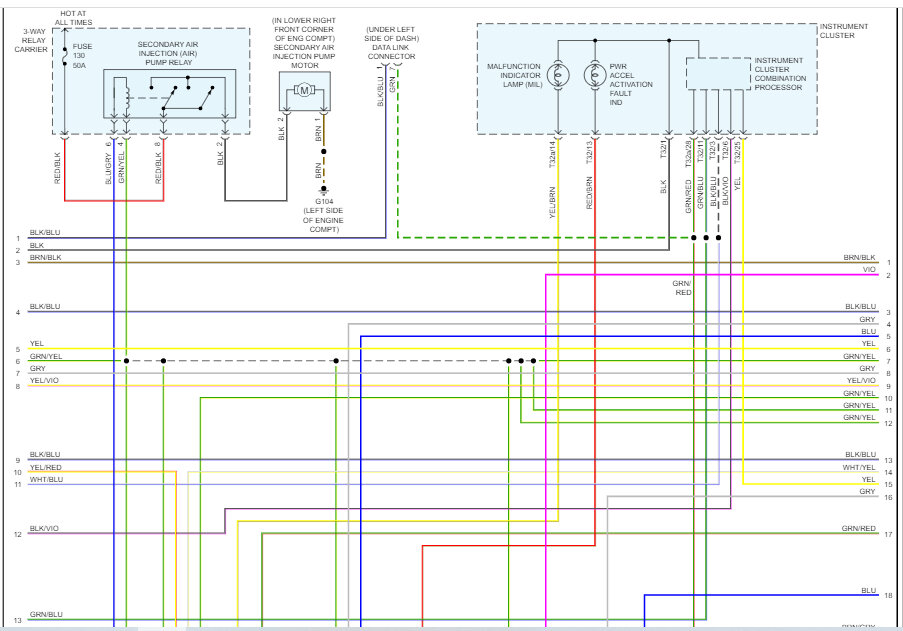

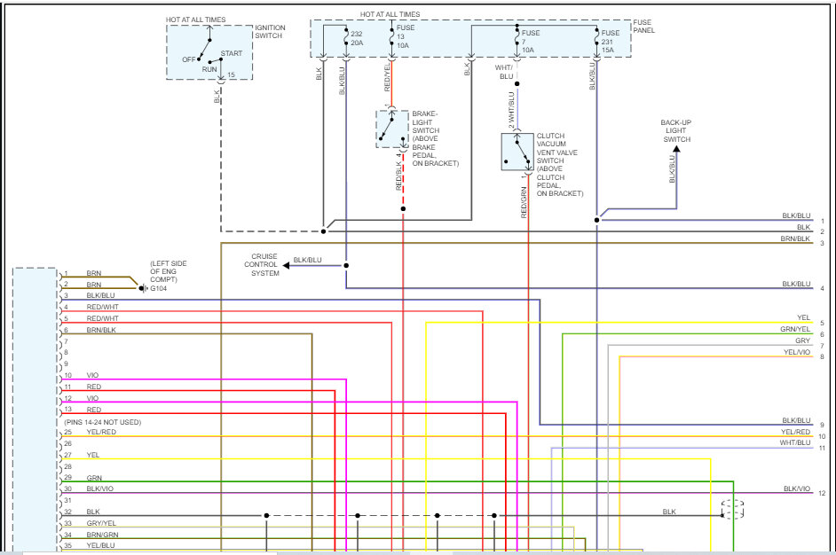

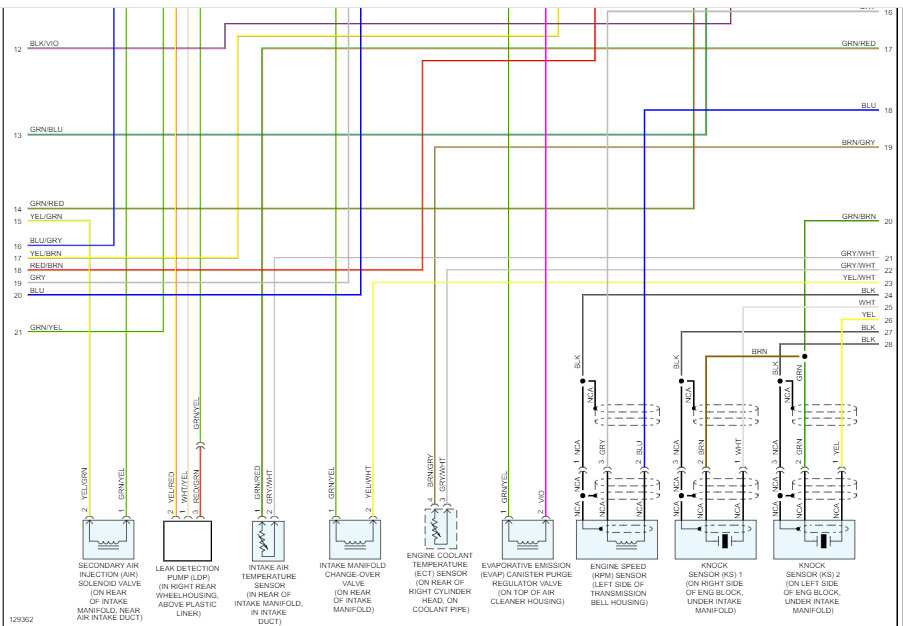

  • 110,248 POSTS
Do you have spark? You didn't mention if you did or not.

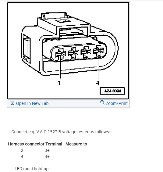

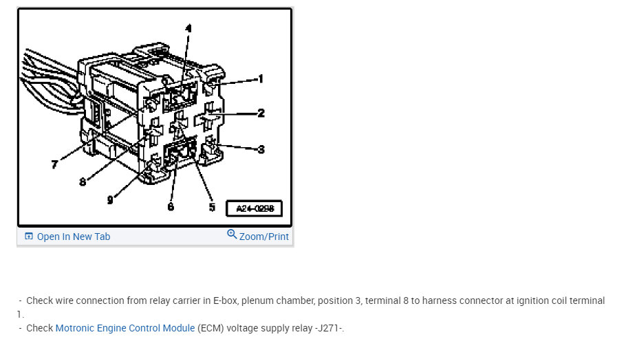

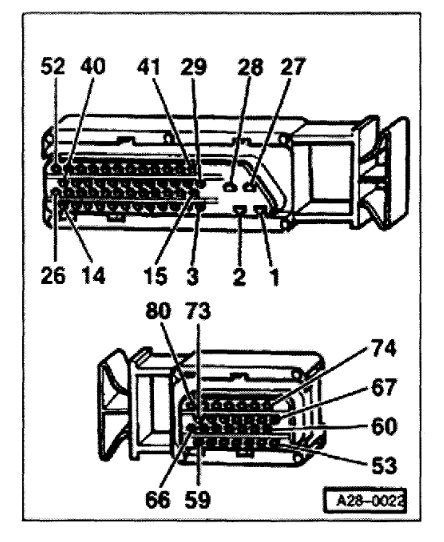

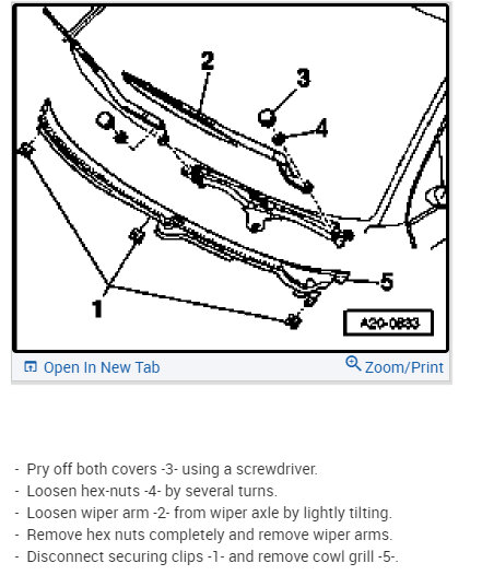

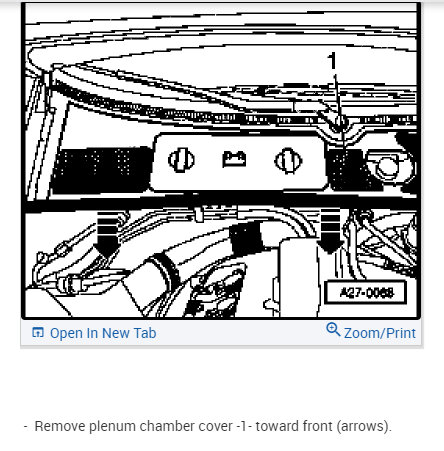

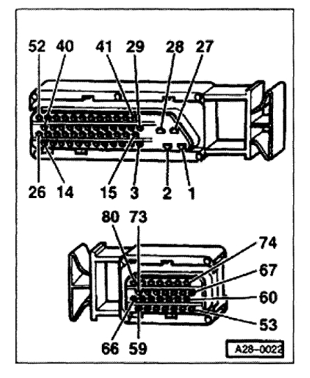

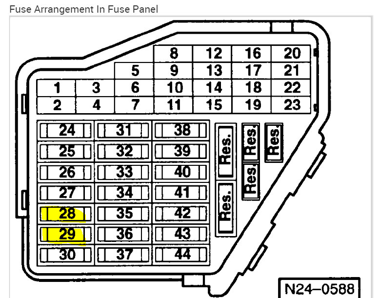

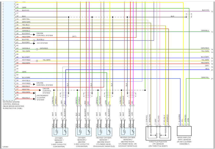

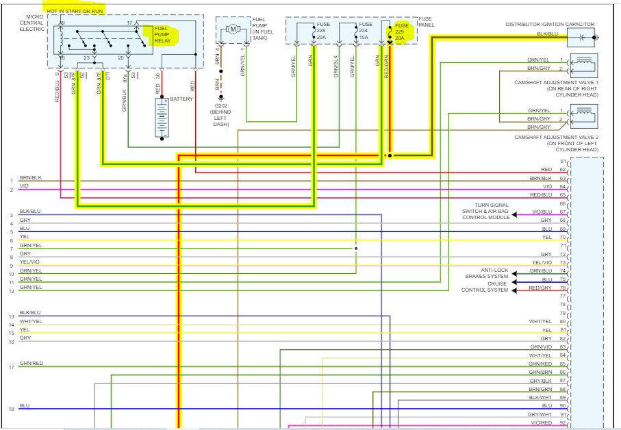

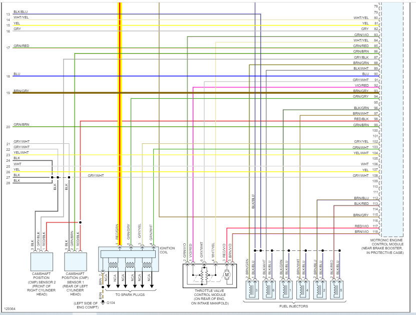

Also, I have attached the powertrain management wiring schematics below. I highlighted fuses I need you to confirm for me. Interestingly, if you don't have power to the ignition coils (red wire), it could be a fuse or the fuel pump relay. And, for the coil to get power, there is a fuse related to the fuel pump that may be bad and stopping power before it gets to the fuse for the pump.
Take a look. If the fuses are good and you have power to the coil and you know the coil is good, then the module is suspect.
See pics below. Note. fuses 228 and 229 are identified with the additional prefix 2, in the wiring diagram. In the fuse box, they are fuses 28 and 29. See last pic
I had to cut each schematic in half to make them readable.

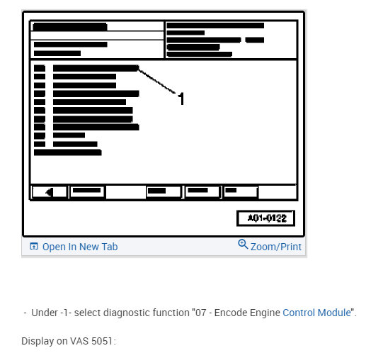

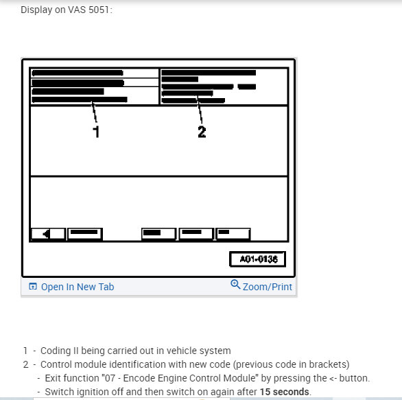

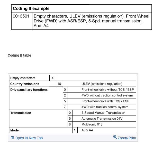

So, Audi discontinued my ECM for that car but with the manual ECM i do have spark. i plug in my old ECM i have no spark, so that leaves me to believe i need one programed to my car.
Sep 5, 2023 at 8:21 AM

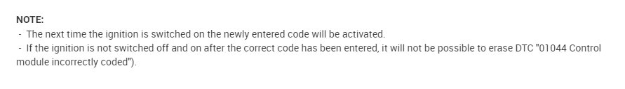

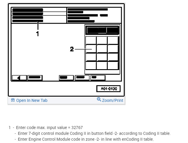

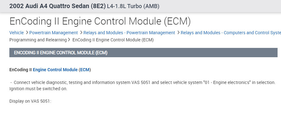

  • 110,248 POSTS

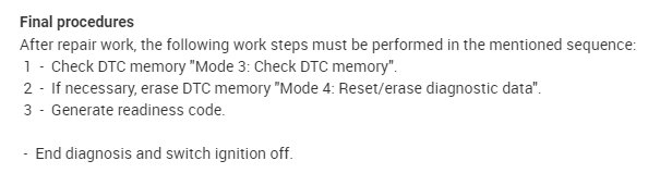

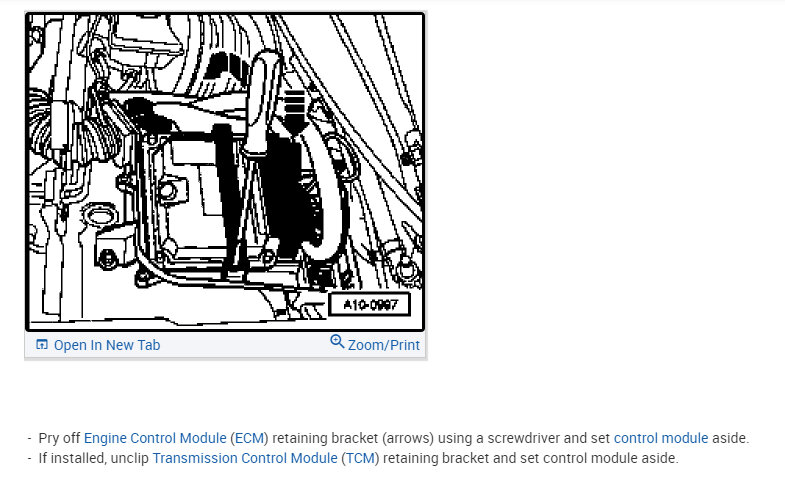

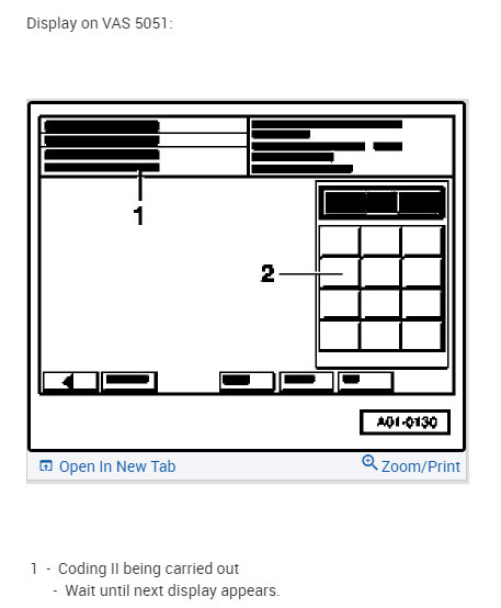

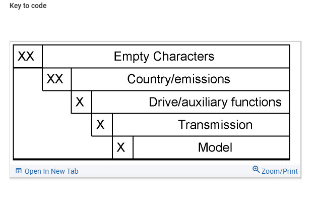

That is correct. If the module is replaced, it requires coding/relearning specific to your vehicle. If I recall, (please know this is from memory) once they are coded, I don't think they can be recoded to a different car. You will need to check on that.
Also, you may be able to find a remanufactured one online.
If you look below, I attached the coding directions.
Let me know if this helps.
Sep 6, 2023 at 9:50 AM
