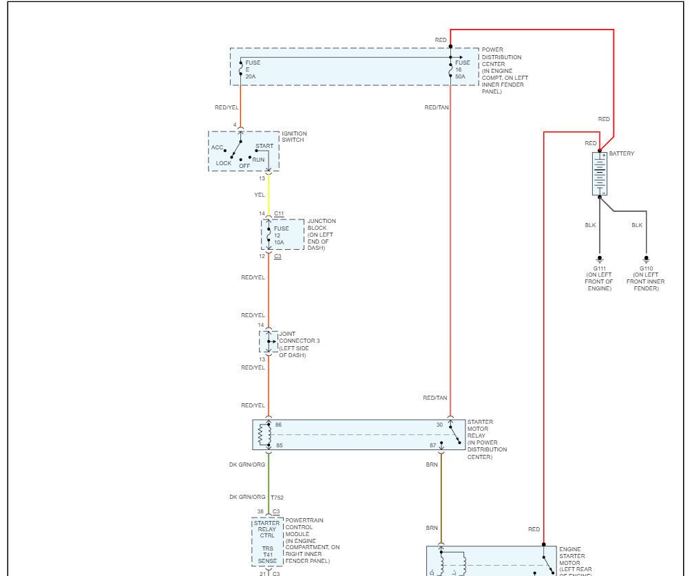

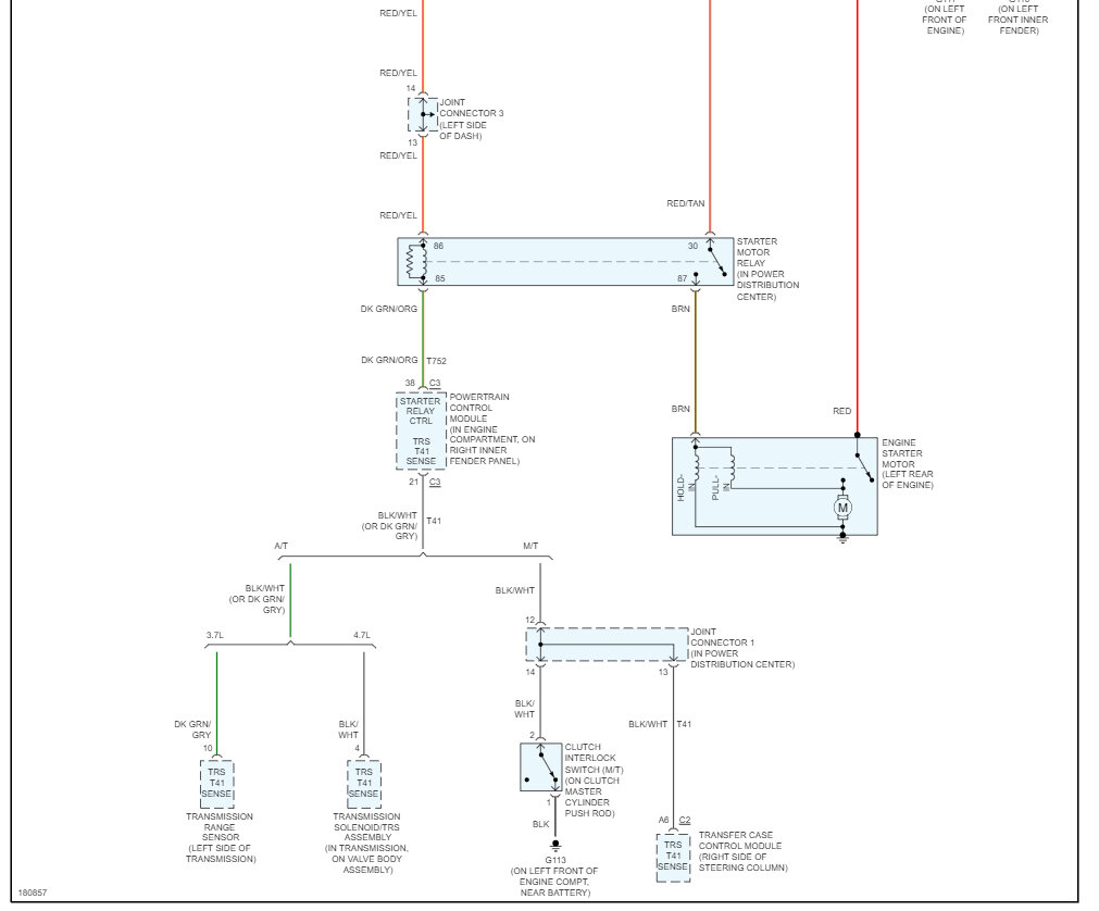

Nope, the engine will crank over with the security enabled, it sounds like the engine might be locked up which you should use a breaker bar on the front of the engine to see if you can turn it by hand, if so let's check for power at the trigger wire of the starter to see if you have 12 volts while in the crank position. This guide can help:
Here is the starter wiring diagrams so you can see how the system works. Check out the images (below). Let us know what happens and please upload pictures or videos of the problem so we can see what's going on.

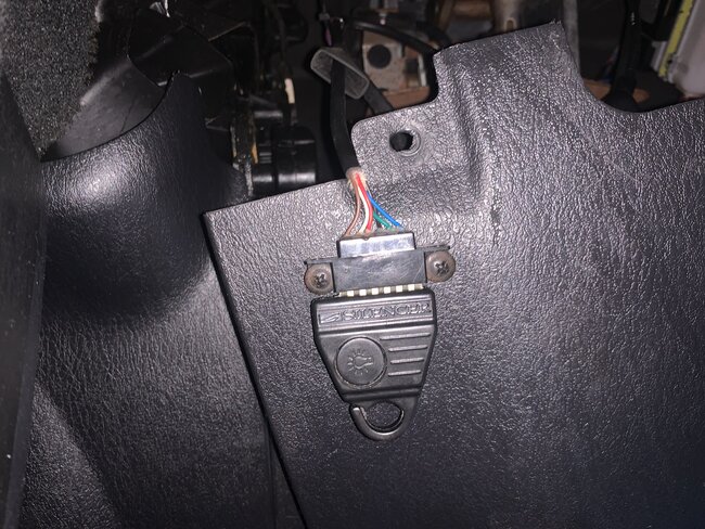

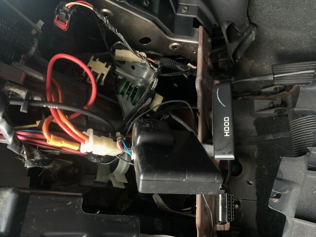

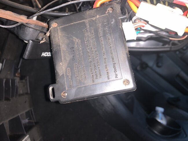

So, I ended up finding out that the car does not have an immobilizer but it does have an aftermarket theft system or security system that disables the starter.

I don’t know how to bypass it, I tried removing the wires that was going from the starter to that system and the wire that was going from the ignition switch to that system and connecting them to make a direct connection but when then the starter doesnt engage.
Aug 10, 2023 at 8:29 PM
  • 55,456 POSTS
Yep, this is the problem, I have removed many of these aftermarket units. Follow the wires from the unit and reconnected the wiring harness back to stock and you should be all set.
