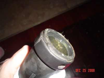

the bad part is, while it was idling the hose right under the radiator fill cap popped off, I don't know if I can hook it back on somehow, or if I need to replace the whole contraption, I am adding a picture????.......
but I pulled the battery out, and I will be taking it to get tested tomorrow,, any help on the radiator would be great

Is that the upper radiator hose? Did the steel housing break? If so, it will need replaced. I'll be honest, I've never seen one of those break like that.
Also, if the truck is running with the battery fulley recharged, there may be a problem with the alt. Have the battery tested first and then we'll move to the alt if needed. (Remember. "If it works, don't fix it.") One of my old shop teacher's favorite sayings.

It is right where the upper hose attaches to the radiator cap, it doesn't seem to be broken, just like it popped of, but it doesn't have any kind of clamp I can figure out around it.

The picture is good, but I can't tell if there is a flange that it goes on to. Also, on the hose itself, it looks like there is something that looks like a clamp. What is that?

There is some plastic thing that goes around the hose, but I can't figure how to get it off, thats why I wonder if the whole unit needs to be replaced

Here is a pic of the clamp, I don't think it comes off, any ideas????

It must come off or you would need to replace the entire unit every time the hose goes bad. Let me show another tech this picture. I want to see what he says.

I wonder if maybe the piece with the radiator cap broke of inside the hose and clamp.
All the hoses I find online are not hooked to the radiator cap, there must be a way

Ok, so I found the part but I still have to figure out how to remove that clamp thing, another post on here for a durango, says they come from the dealer with the filler neck, and two hoses attached, what a pain

I see the part and am trying to figure out why they would make something like that. Based on you picture, it looks like the part broke off inside your rad hose.

so the battery load tested weak, so I replaced that, I looked at the coolant filler neck in the daylight, and the edge is definitely broken off, but I have to get that from a dealer, so I am off to the dealer, I will let you know how it goes

It sounds like you have the same kind of luck as I do. I thought something broke off with the hose, but even though the picture was very clear, it was hard to tell.
