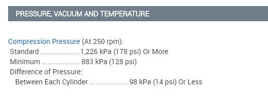

You are welcome. So did you have spark and I assume it did not start on starter fluid? If you have spark and fuel then we need to verify compression.

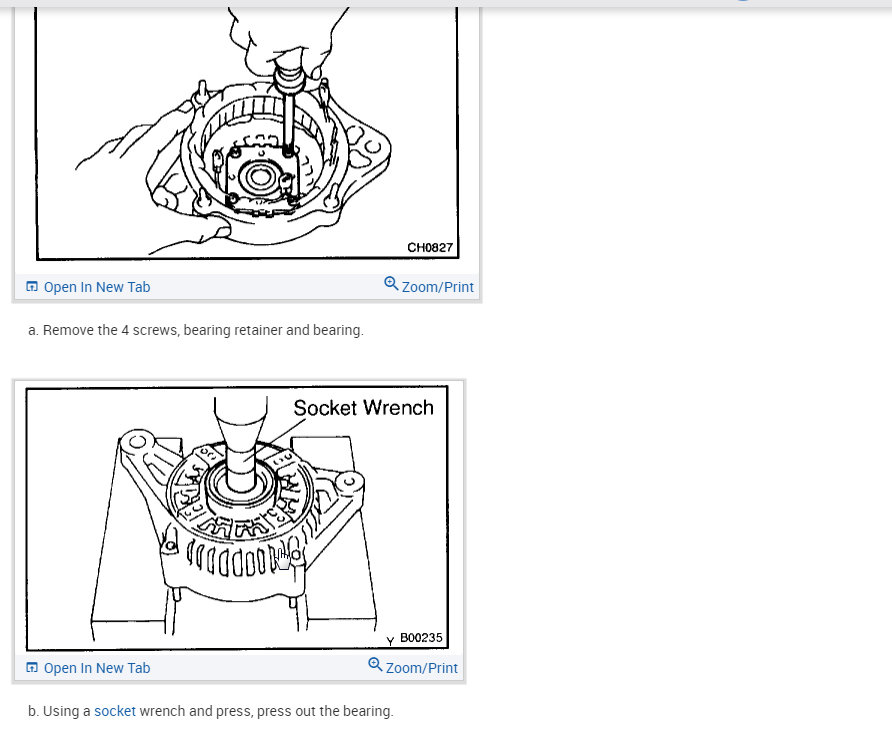

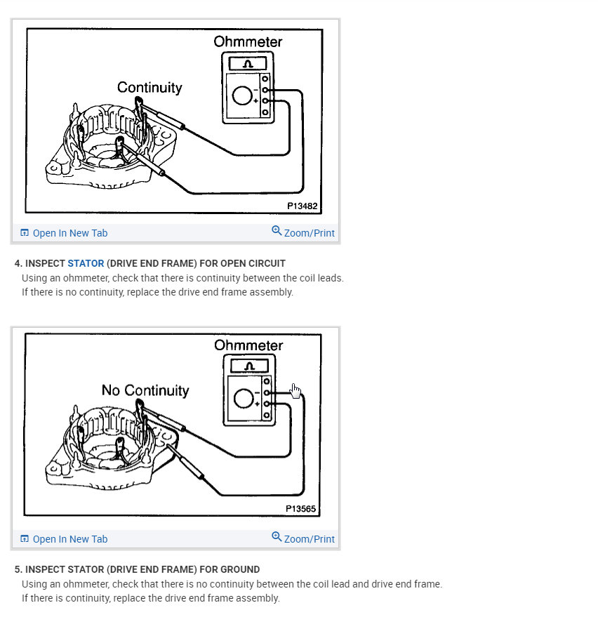

Yes, and it's drained battery until the point my car wont start. Someone told me it might be the alternator, I do not know much about cars, but I really need to get this figured out. Thanks again for reply.
+1
Saturday, December 7th, 2019 AT 10:40 PM

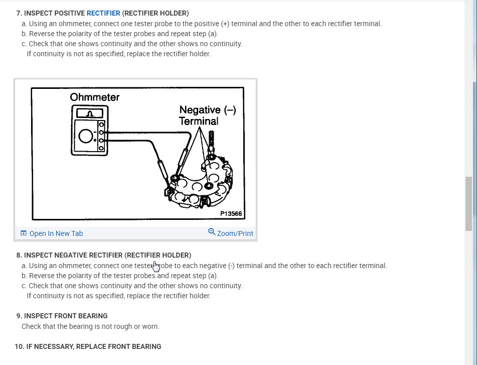

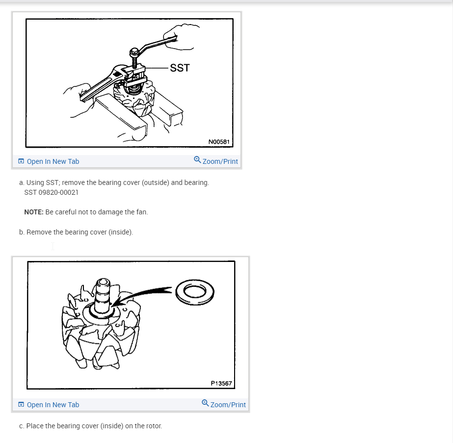

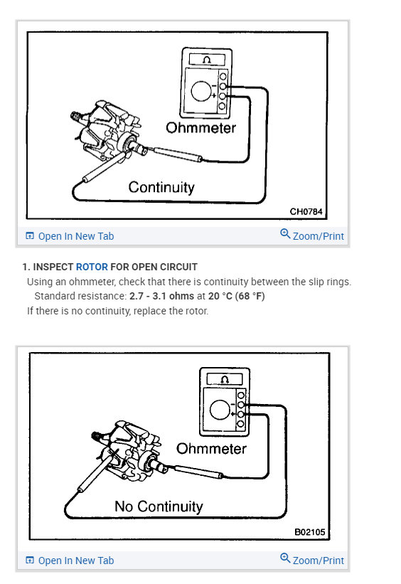

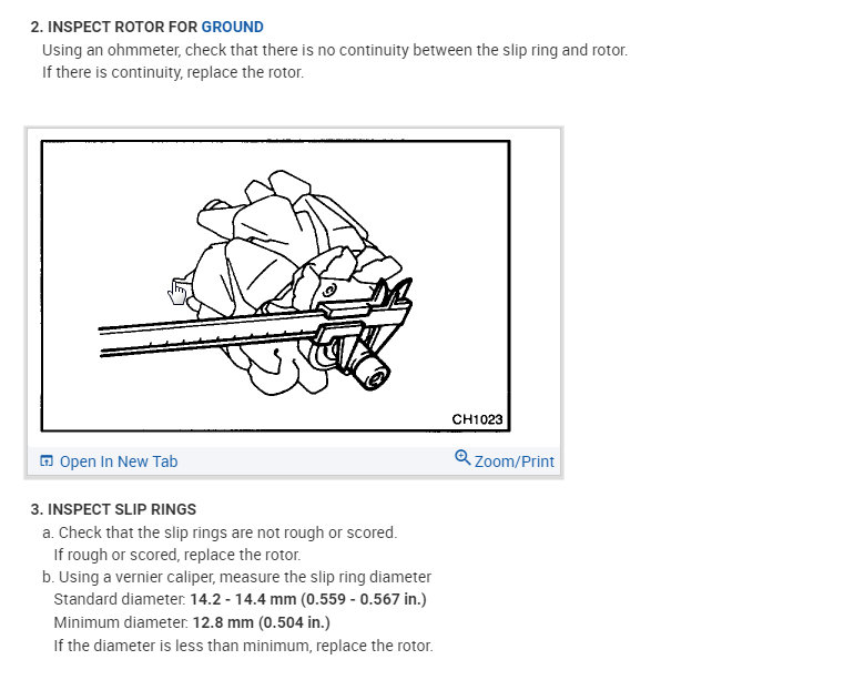

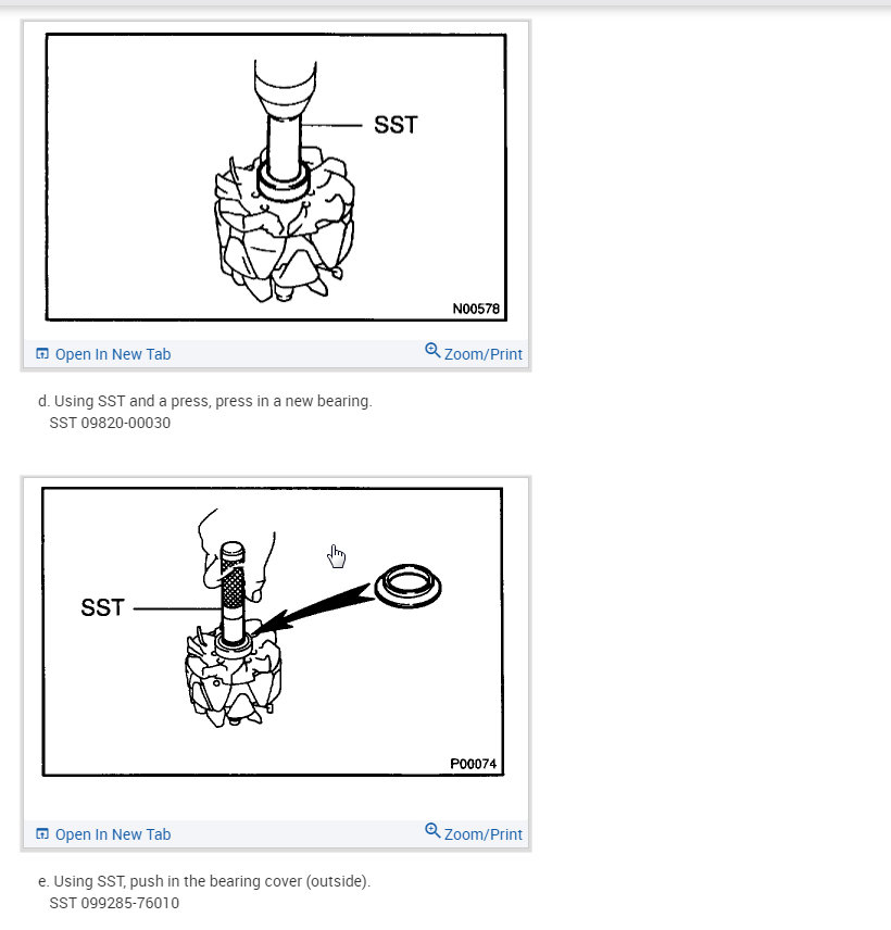

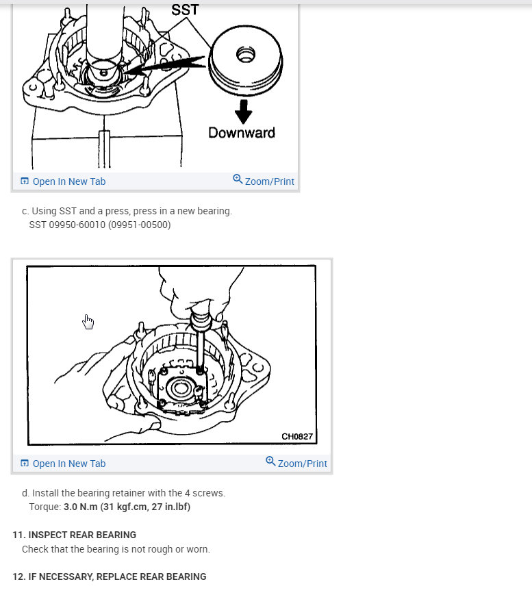

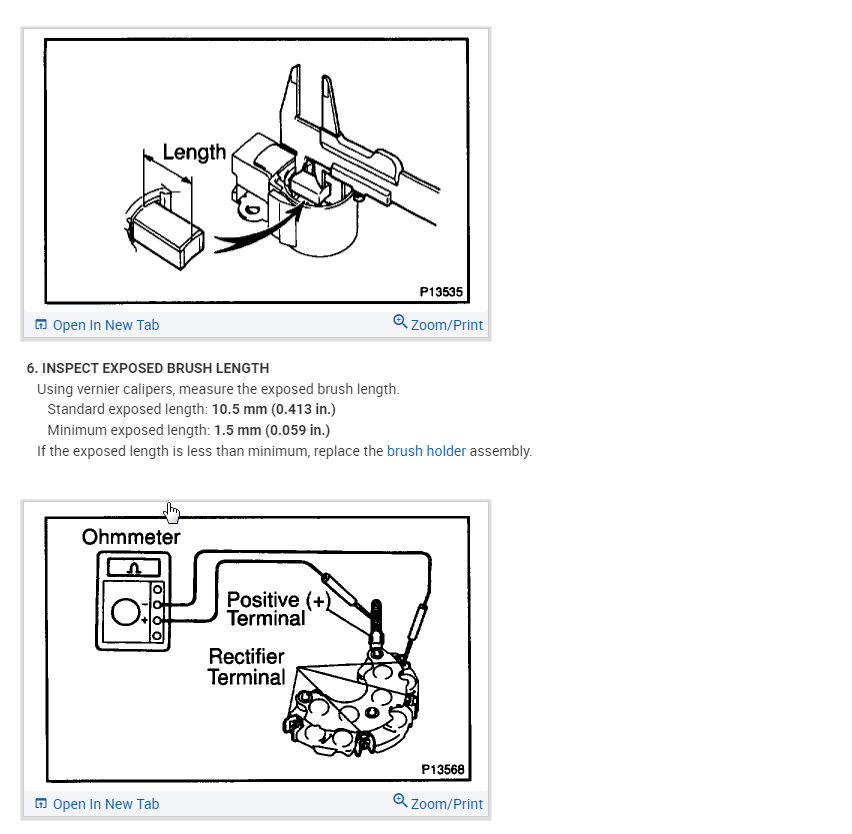

It could be the alternator not charging the battery but it could also be something not "going to sleep." Basically there is a system that is constantly on and it drains the battery. If this person tapped into the wrong thing or didn't wire something properly then it could be the issue. Think of it like your cell phone screen never turns off when you are not using the phone. The battery would last maybe a few hours. Instead it turns off and "goes to sleep" and it allows the battery to last days.
I attached the alternator test and how to rebuild it but it may be easier to have a parts store check the battery and alternator output. Most do this for free. If they are okay then we need to test for an ignition off draw or a parasitic draw.

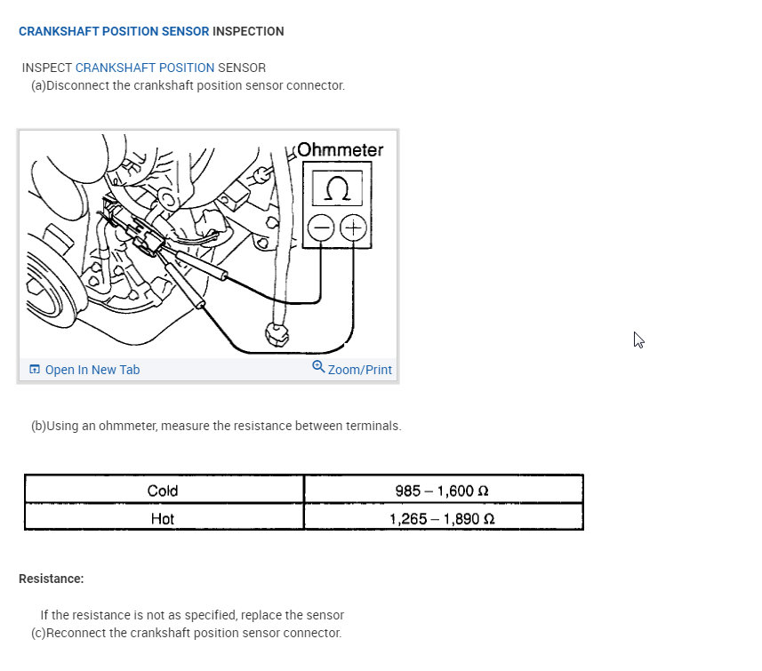

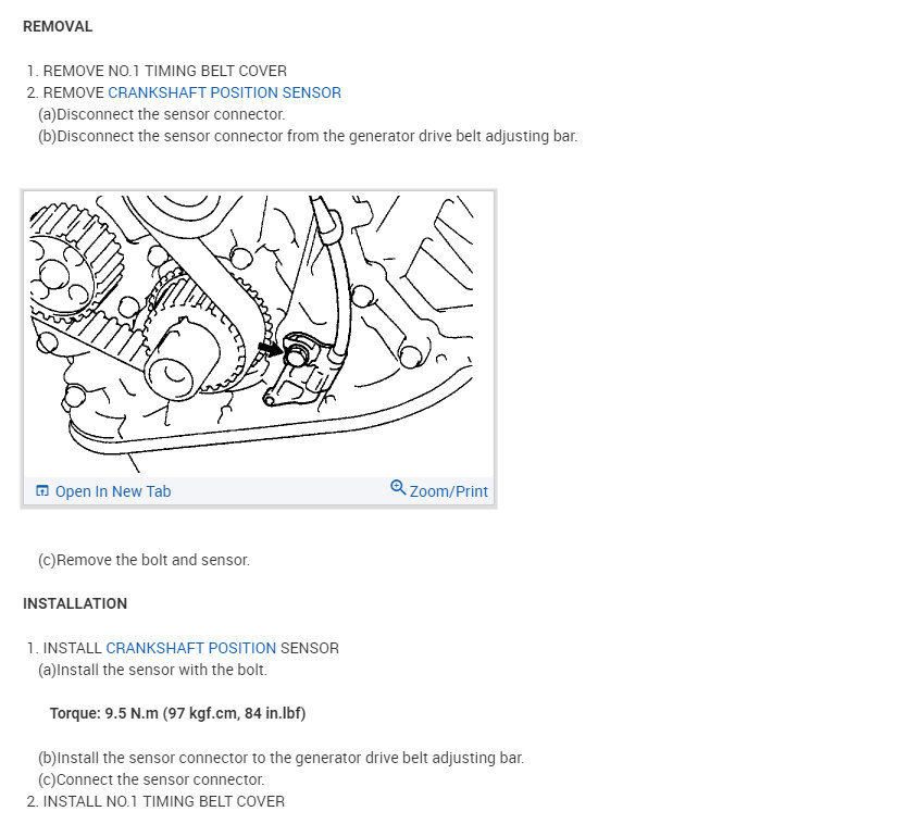

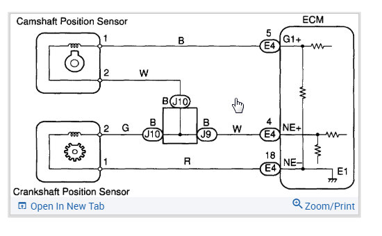

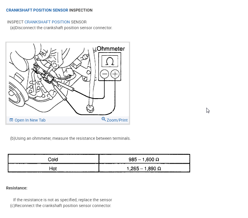

What's wrong if crank sensor not getting power?
Wednesday, December 11th, 2019 AT 1:38 PM
If you have no signal coming from the CKP sensor then the ECM is not getting the engine position and will not know when to fire the plugs.
You need to test the sensor and I suspect you will find that this is an open and needs replacement.
