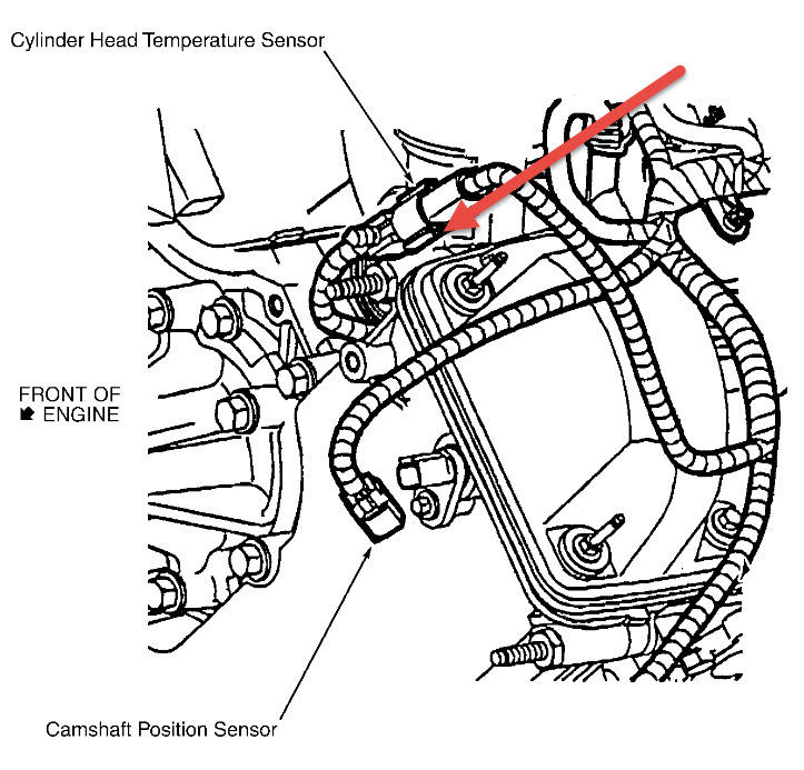

DRE827768
  • 10 POSTS
Truck problems please expert help?
My check engine light is on code said p1299 could someone explain this. Before the check engine light turned on the check gage light would turn on and off every 30minutes lasted about 2 days like this then out of nowhere the check engine turn on and the check gage light was on also and even tho I would accelerate fast the rpm would go to 3 and speed to 10mph it wouldn't go any higher stayed like that for about 2 minutes and it was all shaky also just because i wanted to get home asap the truck didn't turn off but when I got home water was leaking on the bottom don't know exactly where but it was somewhere on the passenger center side. In the last 2 months its been nothing but waisting money I've changed the oil, changed the ac compressor because it was leaking antifreeze also changed the hoses connected to the ac compressor, changed the spark plugs because check engine light said so, and the radiator is about 2 years new
Jan 6, 2020 at 8:34 AM (Merged)

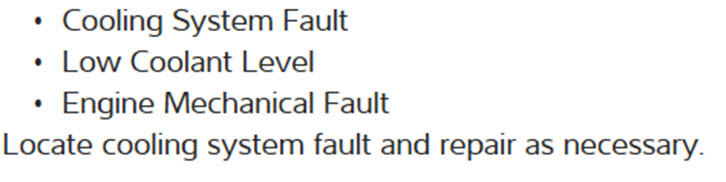

OHYEA
  • 153 POSTS
This code indicates that the engine cylinder head temperature sensor indicates the truck is overheating and going into a fail safe strategy. IBelow is a list and description of the trouble code. You need to first check the coolant level, if it is low then look for a external leak somewhere.you said that is seemed to leak where the thermostat is. In the center behind the alternator. Follow the upper radiator hose. I would pressure test the coolant system to find if you have more leaks than that one location.
Detailed Description
Indicates an engine overheat condition was detected by the cylinder head temperature (CHT) sensor. An FMEM Strategy called Fail-safe Cooling was activated to cool the engine.
Possible causes :-
Engine cooling system concerns.
Low engine coolant level.
Base engine concerns.
DRE827768
  • 10 POSTS
I turned my car on again and drove it couple blocks and it let's me drive it like their is no problem only thing that the check engine light is still on would it still be the sensor you mentioned. What happens if it falls on safety mode?
OHYEA
  • 153 POSTS
Fail Safe Cooling
The vehicle has a strategy built into the powertrain control module (PCM) that will control the engine if it starts to overheat.
Stage 1 of the strategy will commence if the engine starts to overheat. The cylinder head temperature (CHT) sensor transmits a signal to the PCM, which then moves the temperature gauge pointer into the red zone.

Driving the vehicle even more will cause more expenses. Rent a pressure tester for free at an auto parts place and find leaks to repair. You said it was where the thermostat location is so that might be a culprit as a thermostat stuck in the closed position will prevent coolant flow and cause the temperature to steadily rise. In a matter of minutes, if you fail to notice the problem, your engine will be destroyed

HMAC300
  • 48,601 POSTS
this can be a couple of things, see pics, one can be the cht sensor and or ect sensor or a short plus what is shown in 1 pic.
