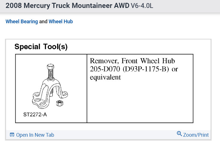

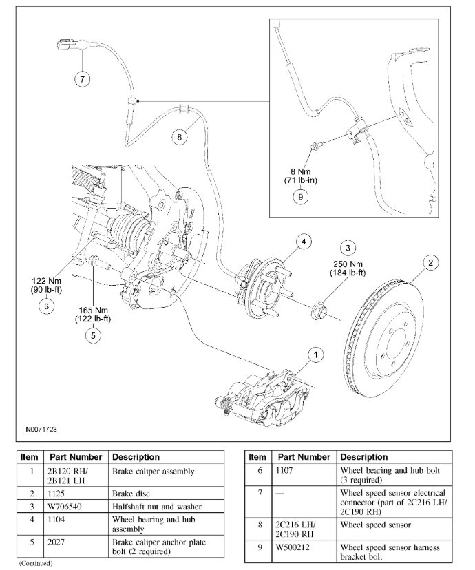

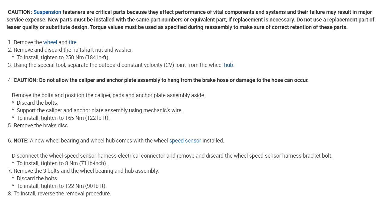

This is common when the bearing hub goes out in the front here is a video of the job being done on a similar car with instructions in the diagram below to show you show on your car.
https://youtu.be/ZgiPRG6jffc
