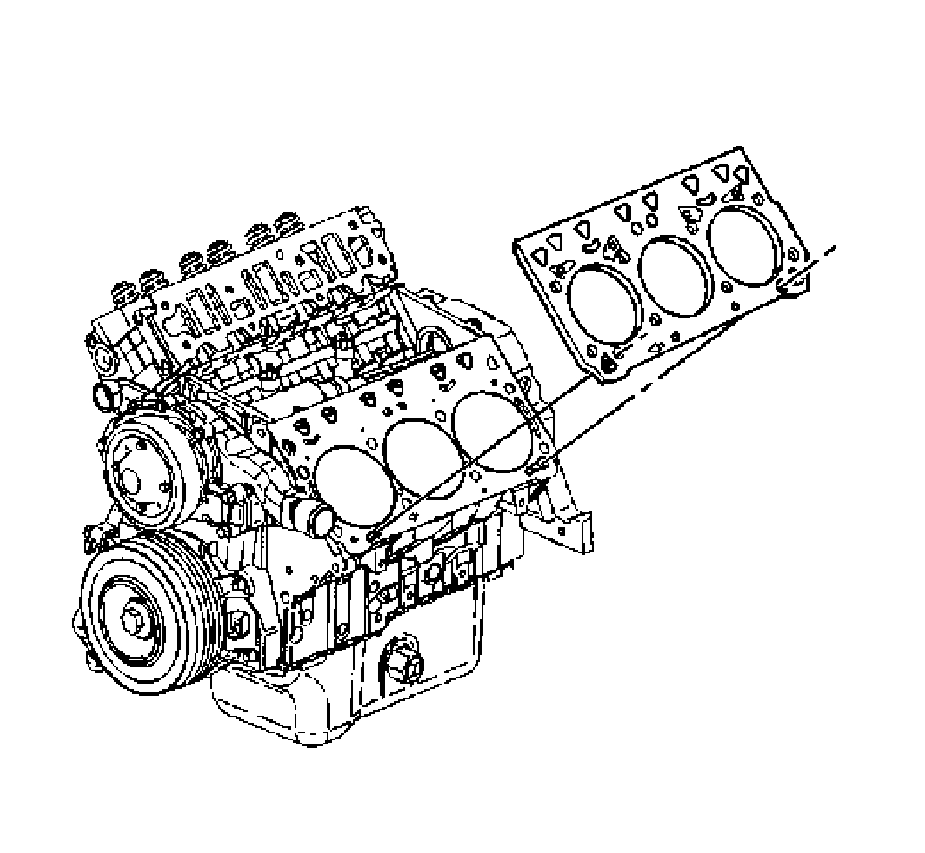

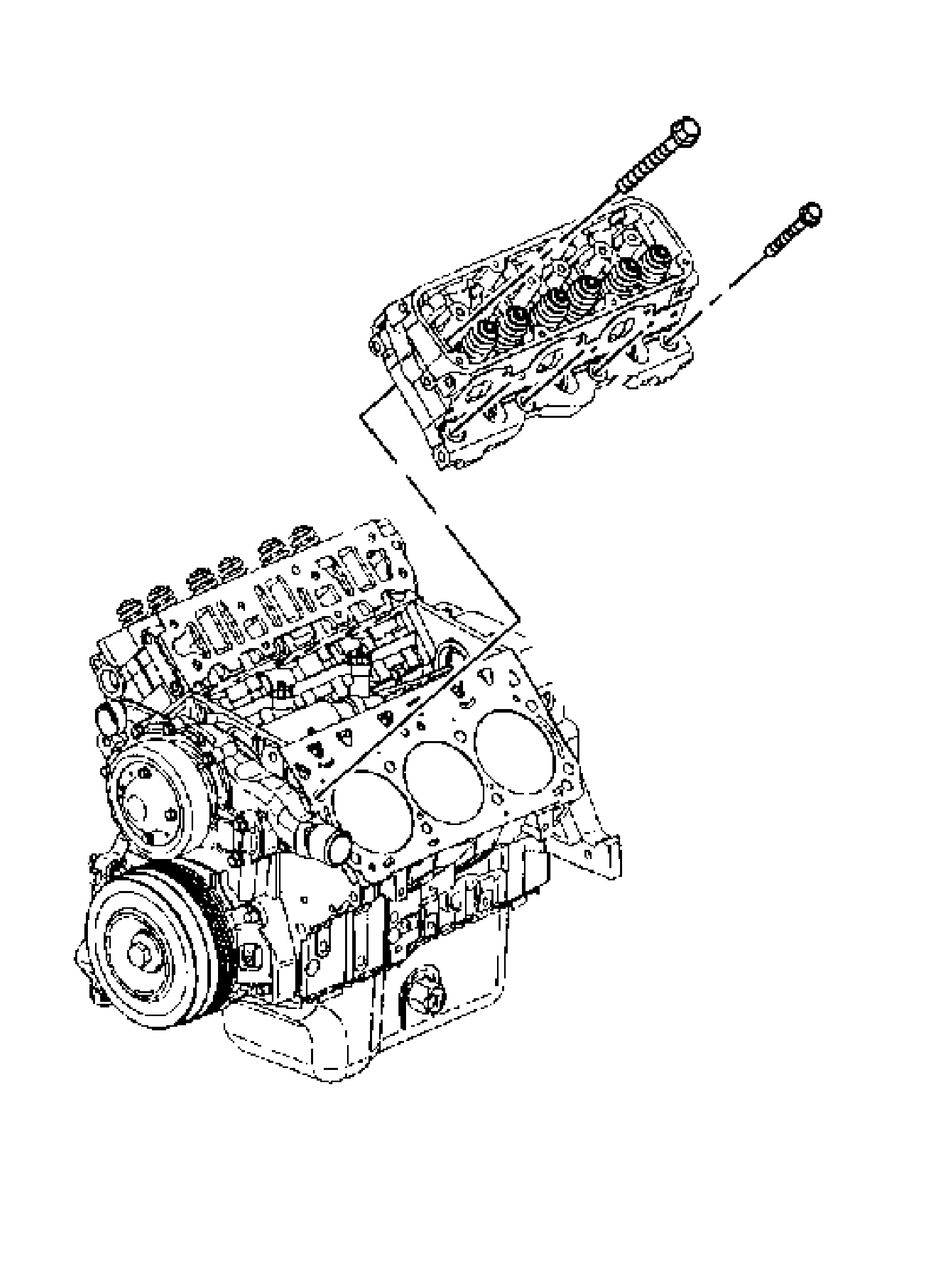

If you can get a complete new head for that price, I would replace it. Doing a valve job isn't a five minute job and there is always a chance a valve will need replaced or there is damage to the head.

Pic 1
15. Remove the left cylinder head bolts. Discard the cylinder head bolts.
16. Remove the left cylinder head.
Pic 2
17. Remove the cylinder head gasket.

2. Position the head gasket with the arrow pointing to the front of the engine.
Notice: Head gaskets are not interchangeable. The head gasket must be installed with the arrow pointing to the front of the engine. Installing the head gasket in any other direction will cause gasket failure and possible engine failure.
Pic 4

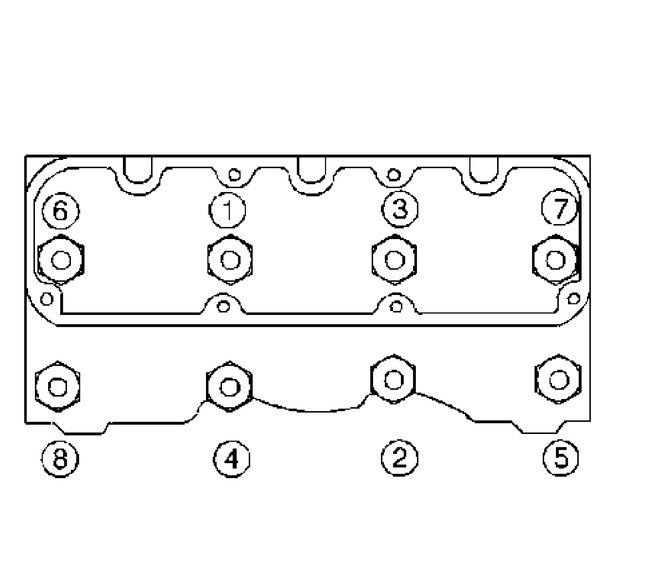

3. Install the cylinder head.
Pic 5

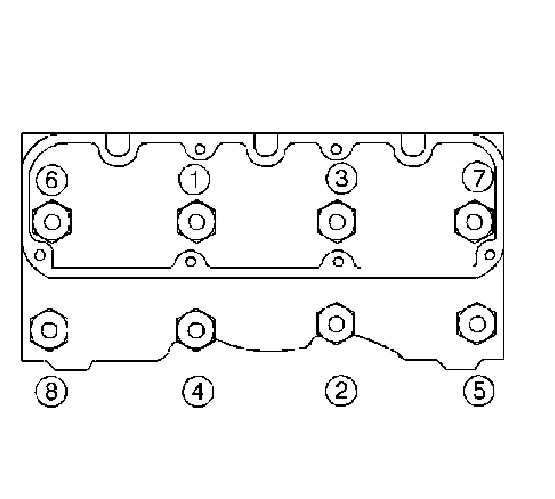

4. Install the new cylinder head bolts (1-8).
1. Tighten the cylinder head bolts (1-8) in the following sequence to 50 Nm (37 ft. Lbs.).
2. Use the J45059 to rotate the cylinder head bolts in the following sequence (1-8) an additional 120 degrees.
Notice: This bolt is designed to permanently stretch when tightened. The correct part number fastener must be used to replace this type of fastener. Do not use a bolt that is stronger in this application. If the correct bolt is not used, the parts will not be tightened correctly. The system or the components may be damaged.
Notice: This engine uses special torque to yield head bolts. This design bolt requires a special tightening procedure. Failure to follow the given procedure will cause head gasket failure and possible engine damage.
