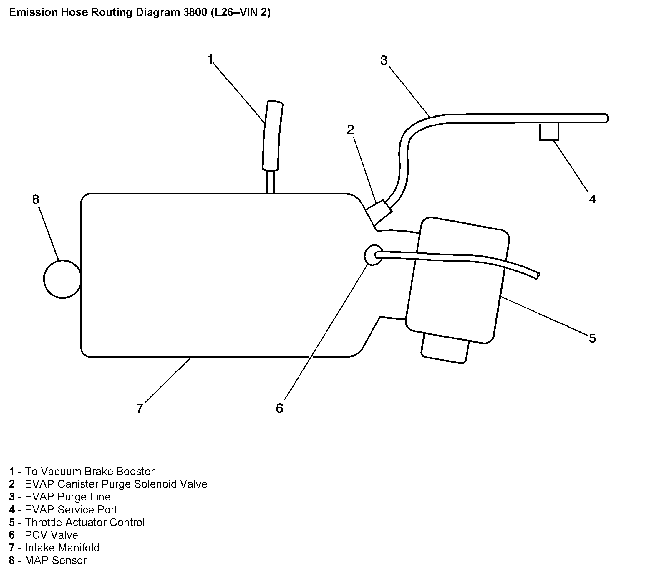

Replaced all plugs and wires and ignition coils. Replaced brake booster hose and valve. Ran better for a short time. But if I turn the wheel to fast the engine wants to stall. In neutral it idles fine but when I put in drive I can feel the engine dragging. New water pump, belt tensioner and power steering pump. The A/C compressor sounds strange and sometimes makes rapid tapping noise for a few seconds? Any help would be greatly appreciated.
Jan 14, 2020 at 6:03 AM
  • 110,251 POSTS
It sounds like you have either a vacuum leak or there is an issue with the idle air control valve (IAC). The IAC is responsible for maintaining idle speed. When you put it in gear or turn the AC on, do the RPM drop?
First, and I have a feeling you may have already done this because of the brake booster replacement, check for engine vacuum leaks.

I cleaned the throttle body very good. Can't find any more vacuum leaks. I wonder if when I unhooked the battery for a while if it messed up the programming? Down the road the engine is strong. Just putting in drive it drops rpm's or when stopped at light.
Jan 16, 2020 at 9:31 AM
  • 110,251 POSTS
If you cleaned the throttle body and there are no leaks, my first suspect is the IAC. However, on this vehicle, there isn't an IAC at least in the true definition of an IAC. In this case, there is a throttle actuator control module. I attached a picture of its location.

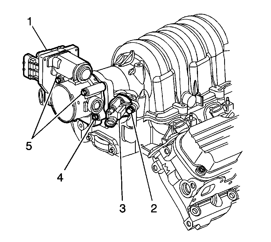

2005 Buick Allure (CANADA) V6-3.8L
Throttle Body Assembly Replacement
Vehicle Powertrain Management Fuel Delivery and Air Induction Throttle Body Service and Repair Procedures Throttle Body Assembly Replacement
THROTTLE BODY ASSEMBLY REPLACEMENT
REMOVAL PROCEDURE
pic 1
1. Partially drain the cooling system. Refer to Draining and Filling Cooling System.
2. Remove the fuel injector sight shield.
3. Remove the air cleaner intake duct.
4. Disconnect the throttle body electrical connector.
5. Remove the throttle body nuts (4) and the bolts (5).
6. Remove the throttle body assembly (1).
7. Clean the throttle body gasket mating surfaces.
NOTE: Do not use solvent of any type when cleaning the gasket surfaces on the intake manifold and the throttle body assembly, as damage to the gasket surfaces and throttle body assembly may result.
Use care in cleaning the gasket surfaces on the intake manifold and the throttle body assembly, as sharp tools may damage the gasket surfaces.
INSTALLATION PROCEDURE
pic 2
1. Install the new gasket.
2. Install the throttle body assembly (1).
3. Install the throttle body bolts (5) and the nuts (4).
NOTE: Refer to Fastener Notice in Service Precautions.
Tighten the bolts and the nuts to 10 N.m (89 lb in).
4. Connect the throttle body electrical connector.
5. Install the air cleaner intake duct.
6. Install the fuel injector sight shield.
7. Fill the cooling system. Refer to Draining and Filling Cooling System.

The code was P0300 random. I will spray carburetor cleaner around the intake again very slow. Driving down the road and even putting the pedal to the floor the car runs great. It just doesn't want to adjust the idle? Years back you could fix this problem pretty fast with a screwdriver. I have new lower intake gaskets and a new plenum gasket torqued to specs. I'm missing something? I'll let you know. Thanks again!
Jan 28, 2020 at 1:22 PM
STEVE W.
  • 15,423 POSTS

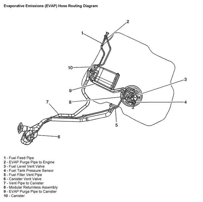

Don't forget the hidden vacuum leaks. IE brake boosters, EVAP purge valves.

I checked again and can't find a leak. But the strange thing is when I replaced the power booster vacuum hose and check valve it ran perfect for a few hours. Triple checked the hose and fitting seal and there all good?
Jan 30, 2020 at 11:37 AM
  • 110,251 POSTS
Were the booster hose and check valve both new?
Jan 30, 2020 at 12:06 PM
JEFF SORDYL
  • 53 POSTS

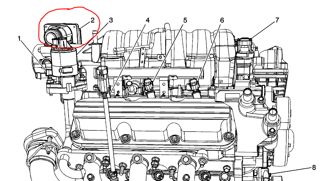

I was checking a few other spots and when I sprayed around the EGR metal hose, coming from the intake to the EGR has one bolt and a oblong thick washer and at the bottom of the clamp it should be flush but it has a very small slit that when I spray carburetor cleaner the car almost stalls. I might have bent it when changing the head gaskets. Can I try high temperature RTV around the opening of I can't get it flush or permatex high temp gasket maker? Thanks again.

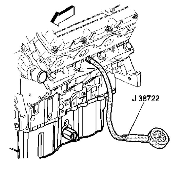

Now my car has a P0303. Back to one now.
I guessing a fuel injector? I also found the PCV valve was stuck. Bought a new one and running better.
Feb 2, 2020 at 6:15 AM
  • 110,251 POSTS
If plugs are good, there are no vacuum leaks, fuel pressure is within spec, then we have to consider an injector (like you mentioned), a compression issue within that cylinder, and timing issues. I have to be honest, if it was timing, I suspect it would involve more than one cylinder.
To start, here is a link that explains how to test an injector:
https://www.2carpros.com/articles/how-to-test-a-fuel-injector
Next, here is a link that explains how to test engine compression. Also, if you look through the first link below, it discusses symptoms of compression issues.
https://www.2carpros.com/articles/symptoms-of-low-compression
Here are the specific directions for your vehicle. The attached pic correlate with the directions.
Engine Compression Test
Vehicle Powertrain Management Tune-up and Engine Performance Checks Compression Check Testing and Inspection Component Tests and General Diagnostics Engine Compression Test
ENGINE COMPRESSION TEST
Tools Required
^ J38722 Compression Tester
A compression pressure test of the engine cylinders determines the condition of the rings, the valves, and the head gasket.
1. Run the engine until it reaches normal operating temperature. The battery must be at or near full charge.
2. Turn the engine OFF.
3. Disable the ignition.
Important: Remove the Powertrain Control Module (PCM) and the ignition fuses from the I/P fuse block.
4. Disable the fuel systems.
5. Remove the spark plugs from all the cylinders.
6. Remove the air duct from the throttle body.
7. Block the throttle plate in the open position.
pic 1
8. Measure the engine compression, using the following procedure:
1. Firmly install J38722 to the spark plug hole.
2. Have an assistant crank the engine through at least four compression strokes in the testing cylinder.
3. Check and record the readings on J38722 at each stroke.
4. Disconnect J38722.
5. Repeat the compression test for each cylinder.
9. Record the compression readings from all of the cylinders.
^ The lowest reading should not be less than 70 percent of the highest reading.
^ No cylinder reading should be less than 689 kPa (100 psi).
10. The following are examples of the possible measurements:
^ When the compression measurement is normal, the compression builds up quickly and evenly to the specified compression on each cylinder.
^ When the compression is low on the first stroke and tends to build up on the following strokes, but does not reach the normal compression, or if the compression improves considerably with the addition of three squirts of oil, the piston rings may be the cause.
^ When the compression is low on the first stroke and does not build up in the following strokes, or the addition of oil does not affect the compression, the valves may be the cause.
^ When the compression is low on two adjacent cylinders, or coolant is present in the crankcase, the head gasket may be the cause.
11. Remove the block from the throttle plate.
12. Install the air duct to the throttle body.
13. Install the spark plugs.
14. Install the Powertrain Control Module (PCM) fuse.
15. Install the ignition fuse to the I/P fuse block.
____________________________
Let me know if this helps.

New throttle body definitely made a difference. Idle is steady at 1,000 rpm's and vacuum is a consistent 14 to 16. But now I have a new code for EVAP leak. Forgot code number? Fix gas cap and problem fixed.
But I definitely have a vacuum leak somewhere on the car. Still have code p0300. When I find it I will let you know.
Feb 10, 2020 at 9:39 AM
  • 110,251 POSTS
Glad to hear it's running better. I don't remember if I included this, but here is a link that will help locate a vacuum leak:
Feb 10, 2020 at 11:24 AM
JEFF SORDYL
  • 53 POSTS

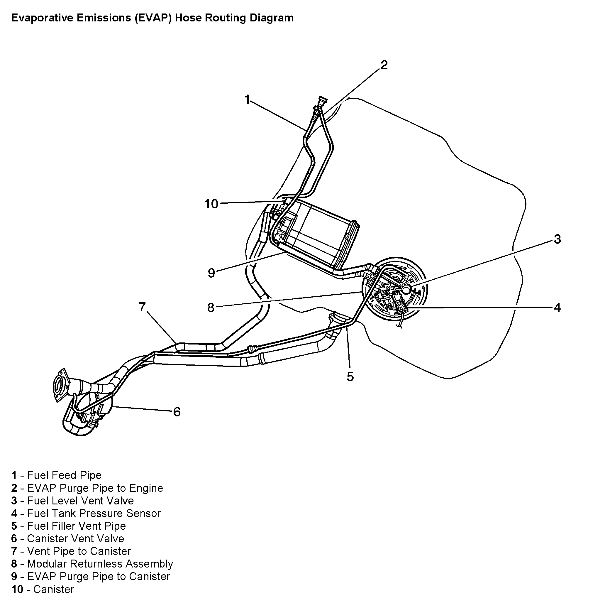

Okay, thanks. My fuel pressure is 70psi. Would a fuel tank vapor sensor or pressure sensor cause this issue?
