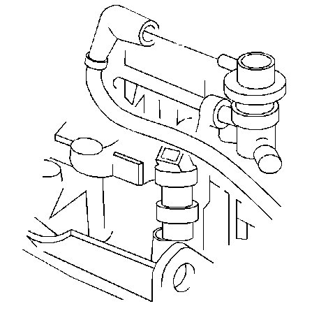

If that is running, it is too high. Max is 62 engine off. It sounds like the fuel pressure regulator is bad. Do me a favor. Connect the pressure gauge and start the engine. Note the fuel pressure. Then, remove the fuel pressure vacuum hose. Pressure should increase. If it doesn't, replace the regulator. Also, confirm there is no fuel getting into the vacuum hose.

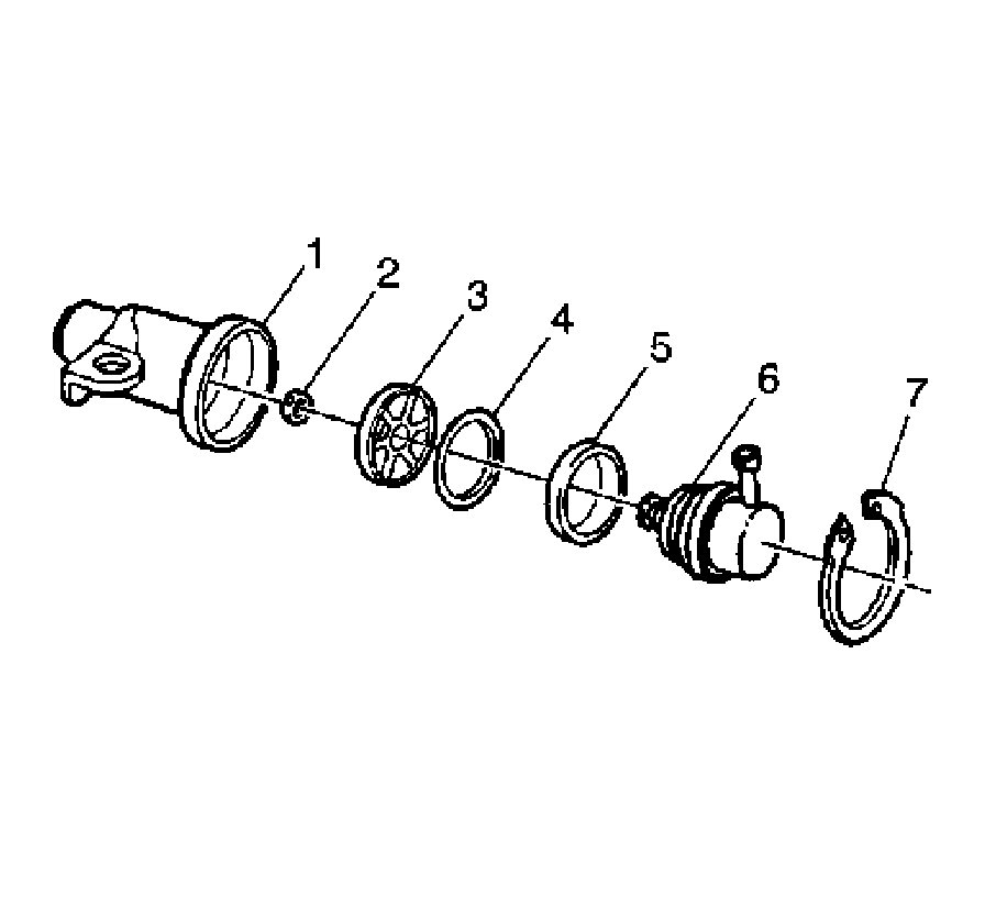

Here are the directions for replacing the regulator. The attached pictures correlate with the directions.

Pic 1
1. Relieve the fuel pressure. Refer to Fuel Pressure Relief Procedure.
2. Clean any dirt from the fuel pressure regulator retaining ring.
3. Remove the vacuum line from the pressure regulator.
Pic 2
4. Remove the snap ring (7).
5. Using a shop towel to catch any spilled fuel, lift and twist the fuel pressure regulator in order to remove the fuel pressure regulator (6) from the fuel pressure regulator housing (1).
6. Remove the regulator O-ring small (2).
7. Remove the regulator O-ring large (4).
8. Remove the regulator O-ring back up (5).
9. Cover the fuel pressure regulator housing (1) to prevent contamination from entering the fuel system.

I don't have a fuel pressure regulator on my fuel rail or anywhere on the engine. I think it's in the fuel tank? The pressure of 70 was when the engine was running. (My car listed above has a series 3 engine) if that makes a difference.
