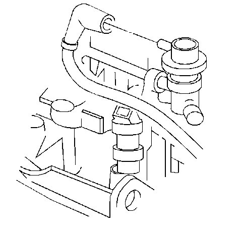

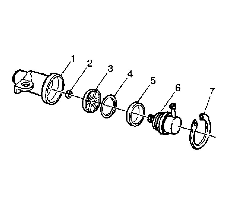

FUEL PRESSURE REGULATOR REPLACEMENT
REMOVAL PROCEDURE
IMPORTANT: Always maintain cleanliness when servicing fuel system components.
pic 1
1. Relieve the fuel pressure. Refer to Fuel Pressure Relief Procedure.
2. Clean any dirt from the fuel pressure regulator retaining ring.
3. Remove the vacuum line from the pressure regulator.
pic 2
4. Remove the snap ring (7).
5. Using a shop towel to catch any spilled fuel, lift and twist the fuel pressure regulator in order to remove the fuel pressure regulator (6) from the fuel pressure regulator housing (1).
6. Remove the regulator O-ring small (2).
7. Remove the regulator O-ring large (4).
8. Remove the regulator O-ring back up (5).
9. Cover the fuel pressure regulator housing (1) to prevent contamination from entering the fuel system.
INSTALLATION PROCEDURE
NOTE:
- Do not use compressed air in order to test or clean a fuel pressure regulator as damage to the fuel pressure regulator may result.
- Clean the fuel pressure regulator filter screen with gasoline if necessary.
- Do not immerse the fuel pressure regulator in a solvent bath in order to prevent damage to the fuel pressure regulator.
pic 3
1. Install the new O-rings on the fuel pressure regulator (6), if a new fuel pressure regulator is not being installed. Lubricate the O-rings lightly with clean engine oil.
2. Install the regulator back up O-ring (5).
3. Install the regulator O-ring large (4).
4. Install the regulator O-ring small (2).
5. Install the fuel pressure regulator (6) in the fuel pressure regulator housing (1).
6. Install the snap ring (7).

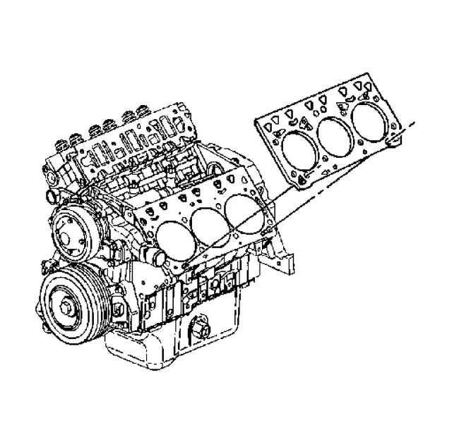

1. Install the valves, the seals, the springs and the caps to the cylinder head.
pic 3
2. Position the head gasket with the arrow pointing to the front of the engine.
Notice: Head gaskets are not interchangeable. The head gasket must be installed with the arrow pointing to the front of the engine. Installing the head gasket in any other direction will cause gasket failure and possible engine failure.
pic 4

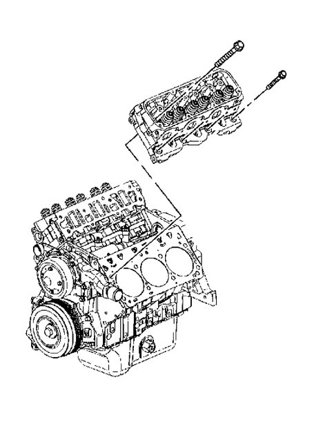

3. Install the cylinder head.
pic 5

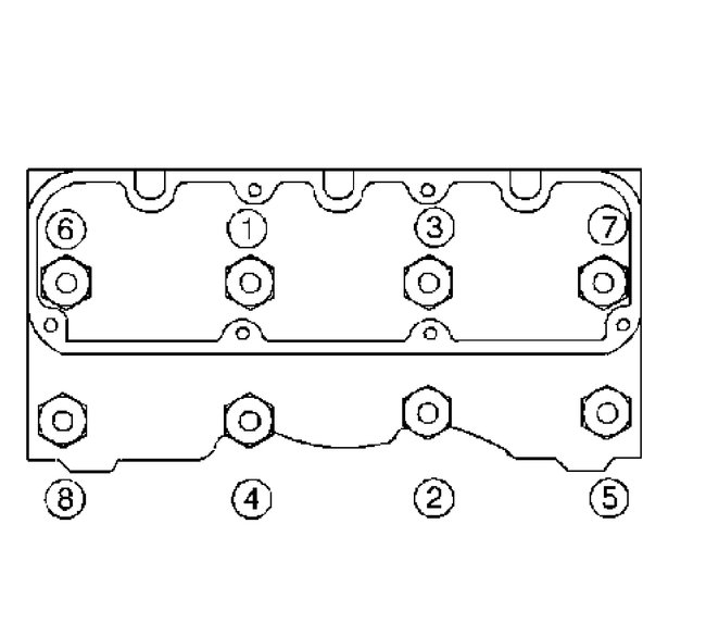

4. Install the new cylinder head bolts (1-8).
1. Tighten the cylinder head bolts (1-8) in the following sequence to 50 Nm (37 ft. lbs.).
2. Use the J45059 to rotate the cylinder head bolts in the following sequence (1-8) an additional 120 degrees.
Notice: This bolt is designed to permanently stretch when tightened. The correct part number fastener must be used to replace this type of fastener. Do not use a bolt that is stronger in this application. If the correct bolt is not used, the parts will not be tightened correctly. The system or the components may be damaged.
Notice: This engine uses special torque to yield head bolts. This design bolt requires a special tightening procedure. Failure to follow the given procedure will cause head gasket failure and possible engine damage.
