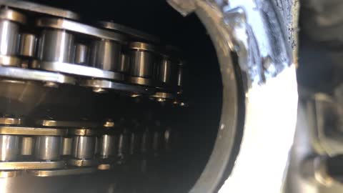

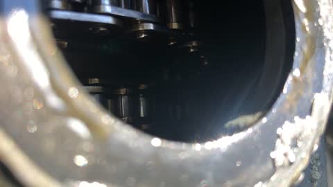

NASER NASER
  • 836 POSTS
Removed the oil cap and tried to start it, nothing is moving on the inside.
Thursday, February 27th, 2020 AT 5:54 PM

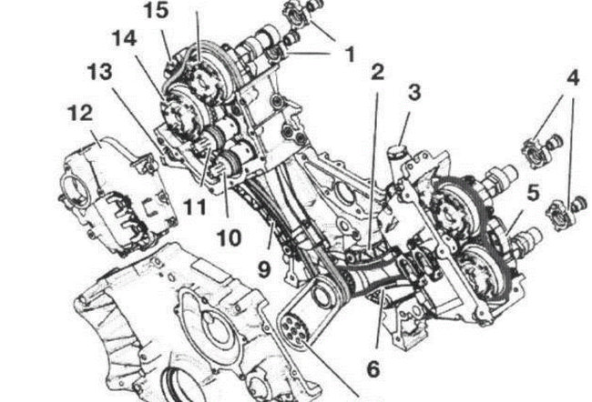

  • 109,885 POSTS
I attached a pic of the chains. Either the one for that side has broken or the counter chain has broken. That isn't good news and explains the cam codes. If you confirm the engine is a 4.8L, I can get you the directions for replacement.
