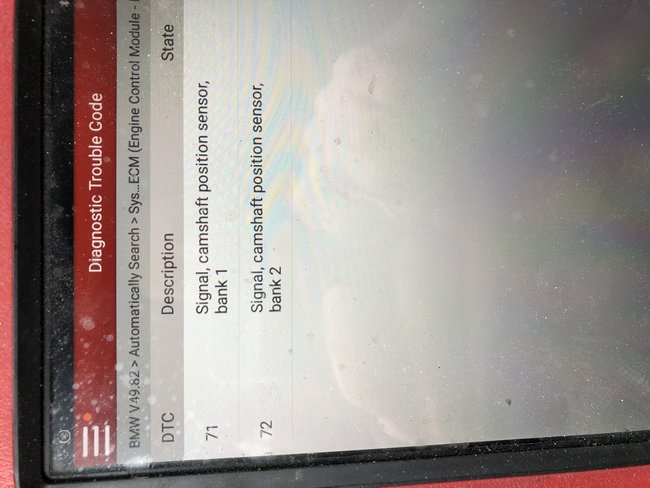

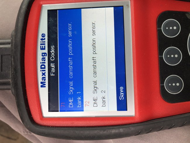

Car throwing a code in the picture attached. she will turn over but not start. Problem started all of a sudden so not sure if it is a possibility. I repossessed this car from someone and when i got it it started so i turned it off. now it just turns over and over. Tachometer needle not moving up at all as it should usually start to go up even a bit.

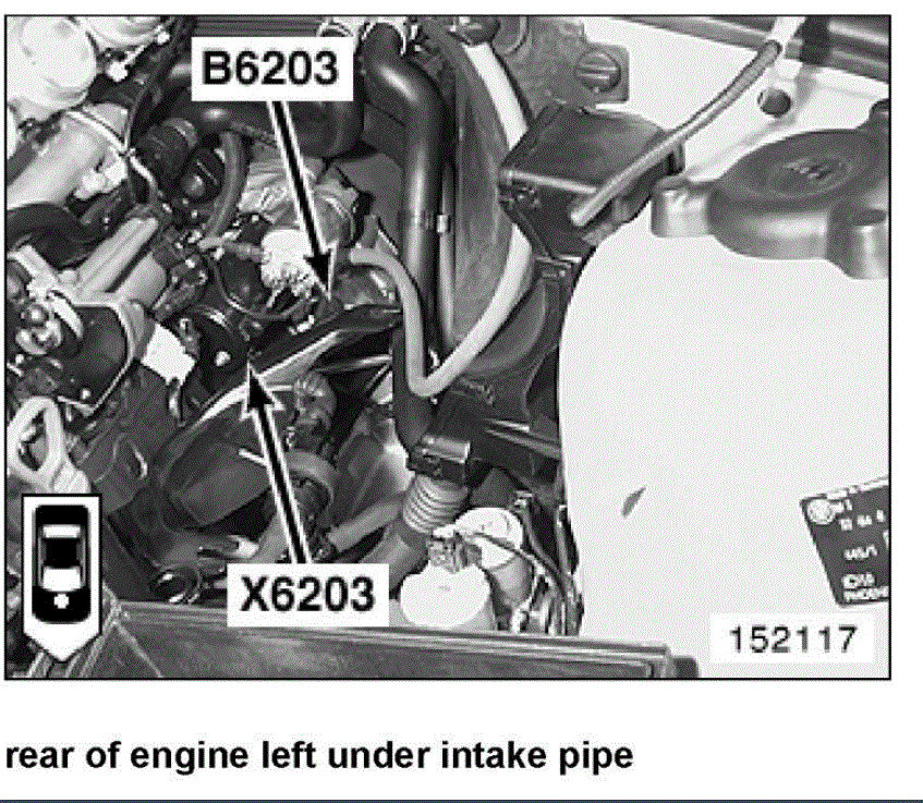

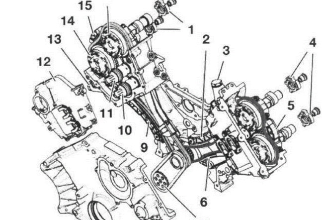

If you have no RPM signal, and based on the code, it sounds like the crankshaft position sensor is bad. I realize the codes are cam sensor codes. Check the crank sensor connection to make sure it is good and not disconnected.
See picture 1 and let me know what you find.

I see two in the picture, which one? I thought about the crankshaft sensor but didn't think it would just go out like that or it would give me a code, isn't it next to the starter or mounted to the bell housing of the transmission?

The codes are for the two cam sensors. If the RPM signal is lost, my first suspect is the crankshaft position sensor which will directly affect ignition. What I would suggest is to see if the security has it shut down and if the engine is getting ignition spark.

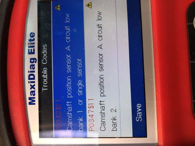

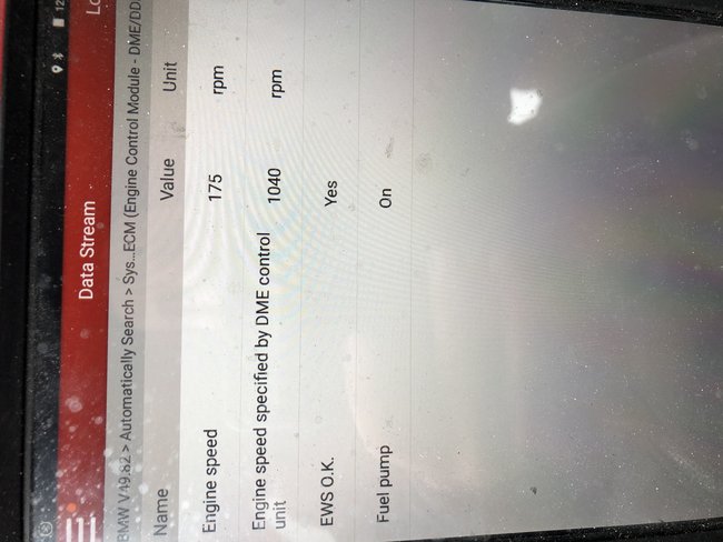

Cleared all codes and tried to start with starter fluid, nothing, still getting these camshaft codes only when starting, there is rpm based on this screen correct?

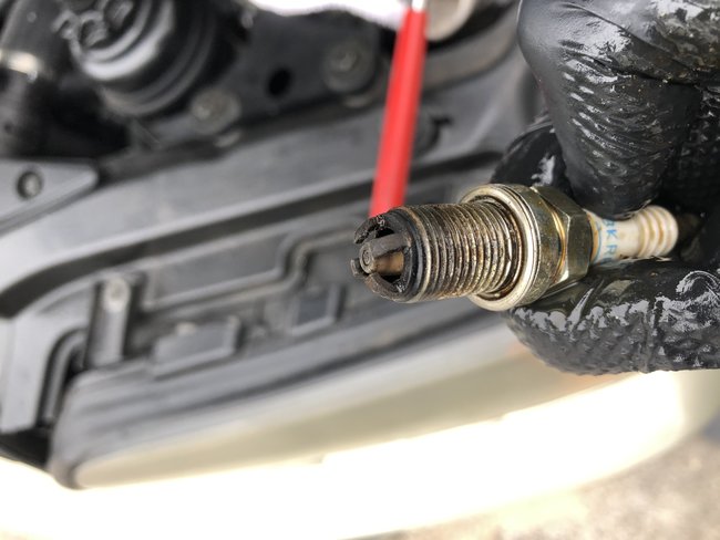

There isn't a fuse just for the spark. If it isn't starting with starting fluid it sounds like it isn't getting spark. Have you checked? Have you pulled plugs to see if they are wet?

If there is no spark, then we will need to check the crankshaft position sensor. Also, if you have a live data scanner, see if there is an RPM signal when cranking.

I already replaced the crank position sensor. also included photos of the rpm signal, they are attached above.

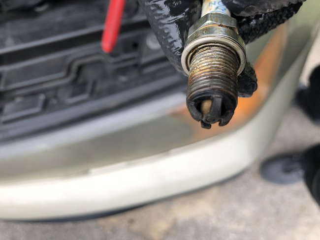

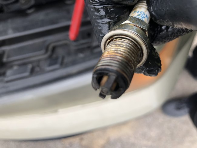

Just checked and there is spark. I don't see the spark plugs being wet, weird, i would have thought they were. I will check fuel pressure just to make sure, but am smelling fuel. I just don't hear the fuel pump running unless i jump the relay.

What about the codes for camshaft position sensor for both banks, you think that has anything to do with why it is not starting?

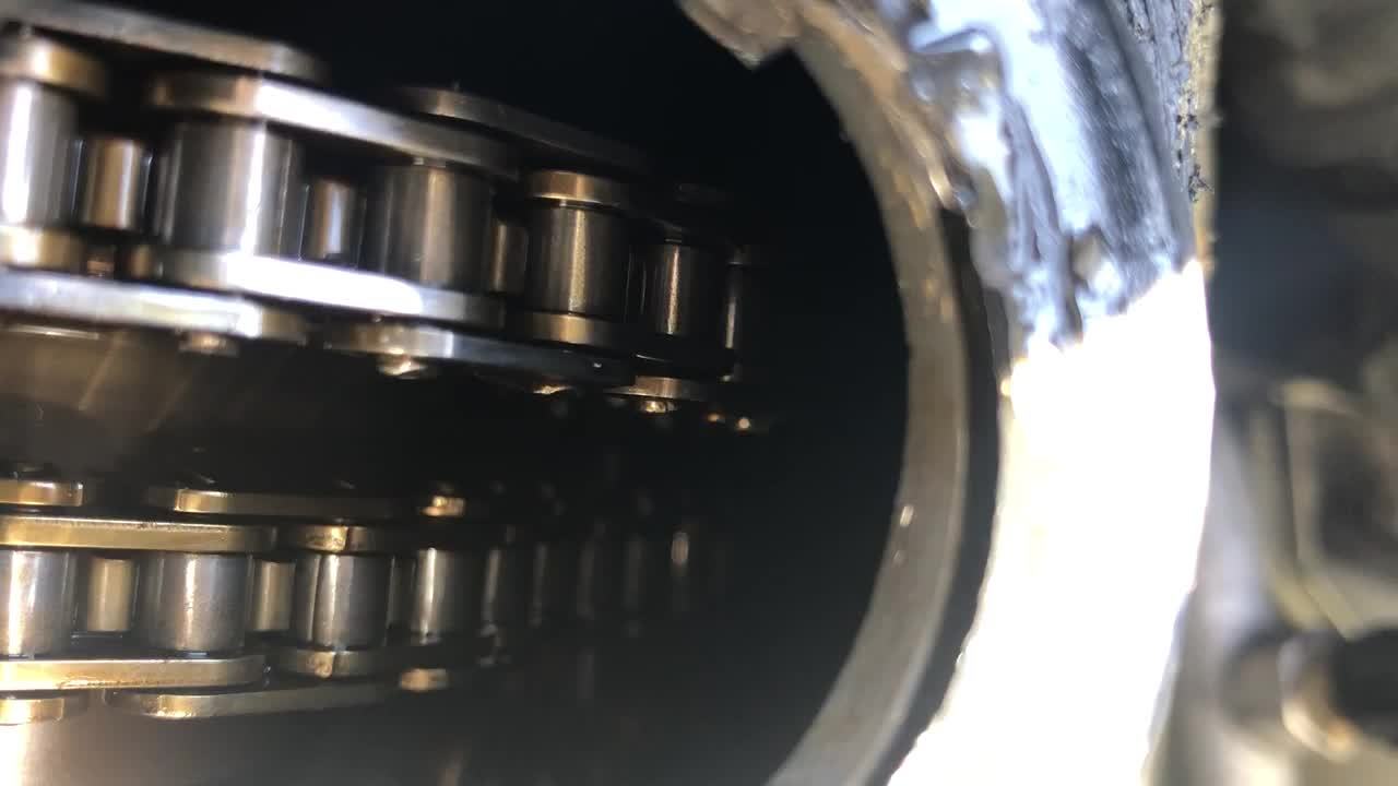

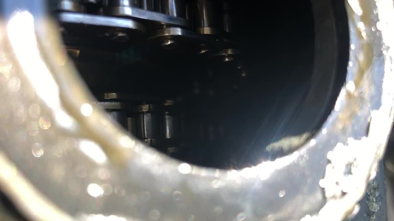

Attached.
Feb 27, 2020 at 4:02 AM
  • 110,248 POSTS
I can't tell what I am looking at in the video. Is that a converter? What should I pay attention to?
Feb 27, 2020 at 9:43 AM
NASER NASER
  • 836 POSTS
Removed the oil cap and tried to start it, nothing is moving on the inside.
Feb 27, 2020 at 9:54 AM
  • 110,248 POSTS
I attached a pic of the chains. Either the one for that side has broken or the counter chain has broken. That isn't good news and explains the cam codes. If you confirm the engine is a 4.8L, I can get you the directions for replacement.
