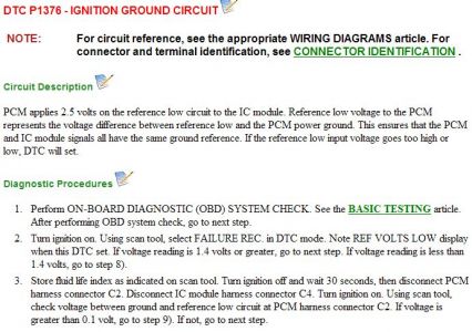

have a p1376 code-how can I fix it

Change your ignition module.
