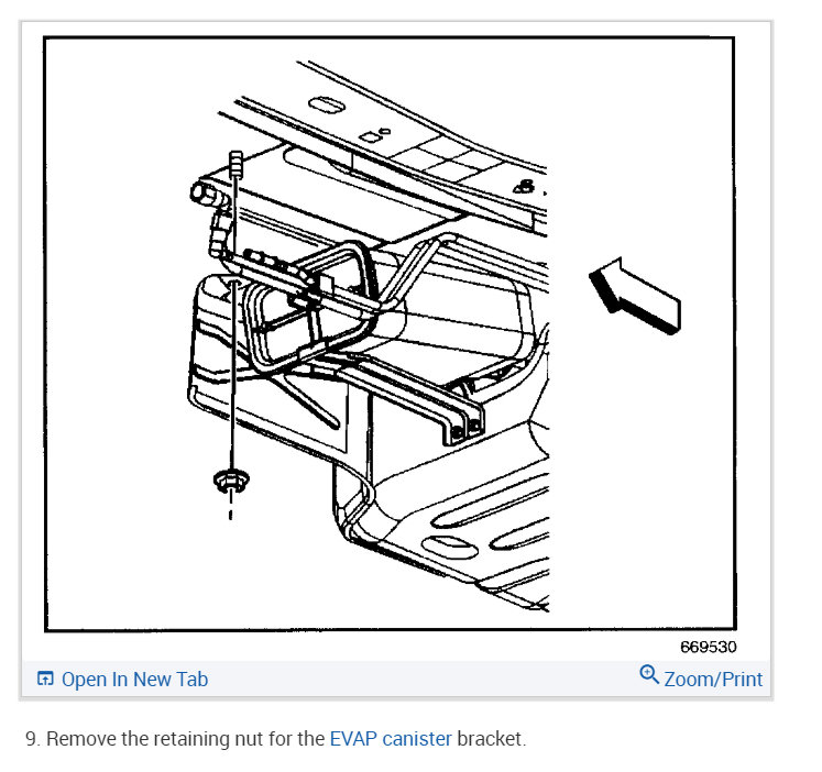

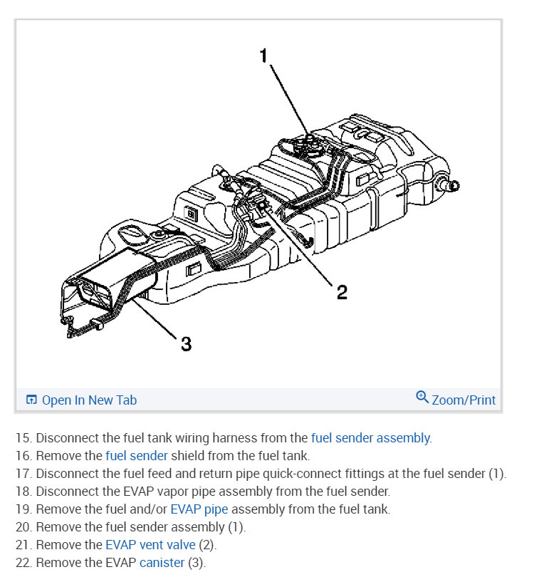

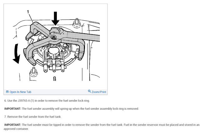

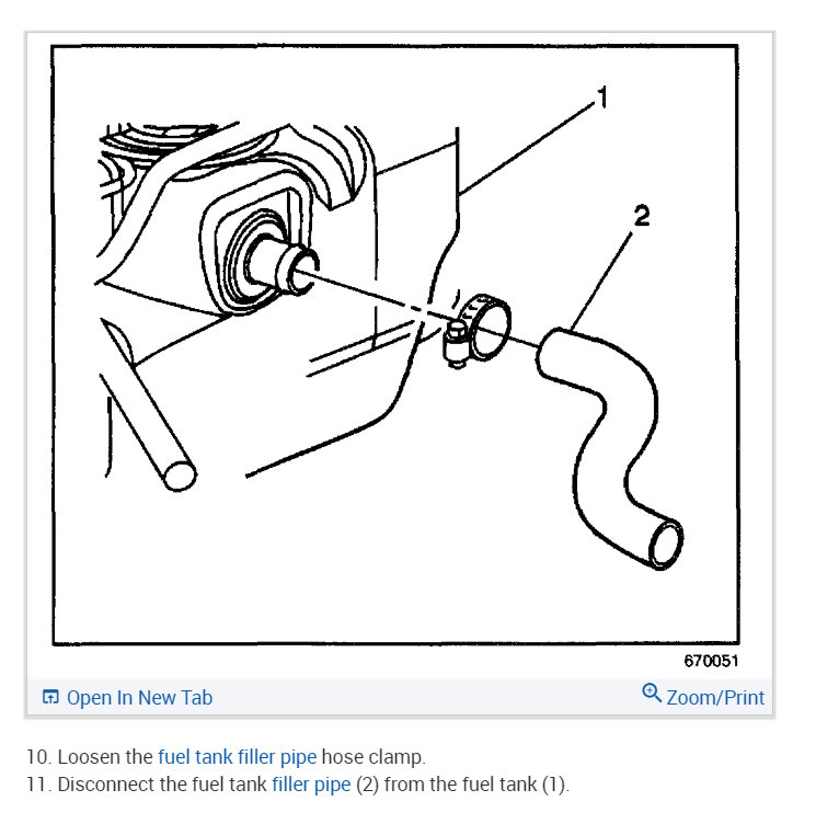

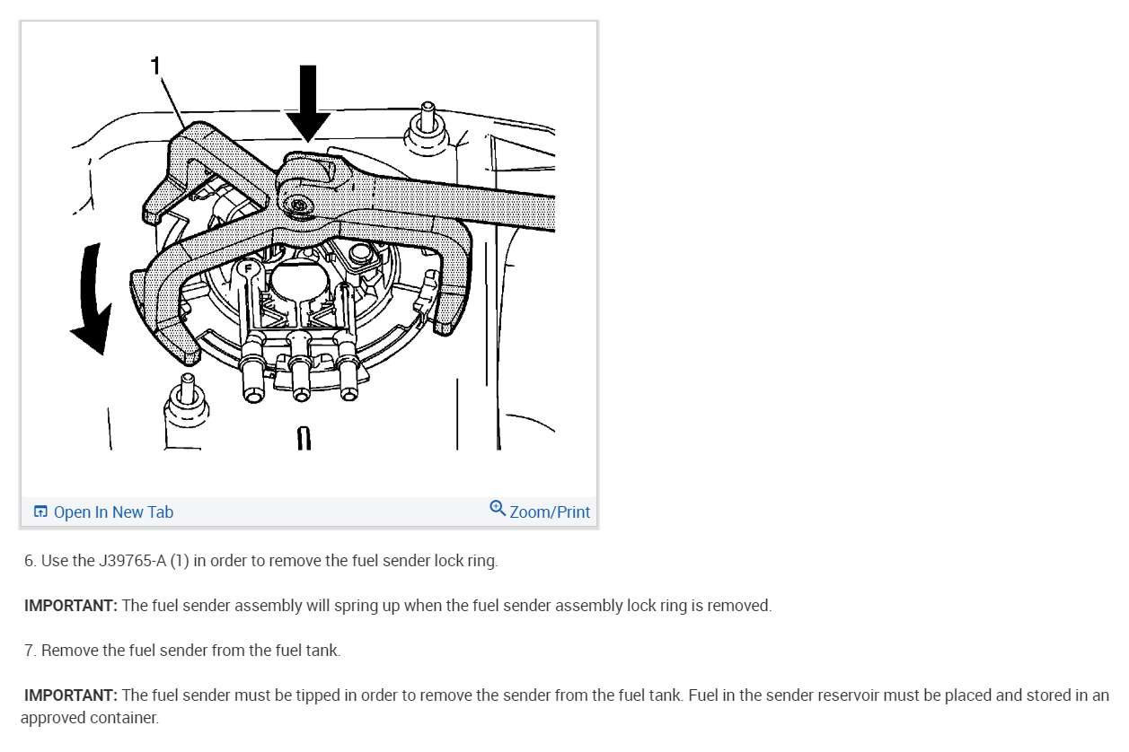

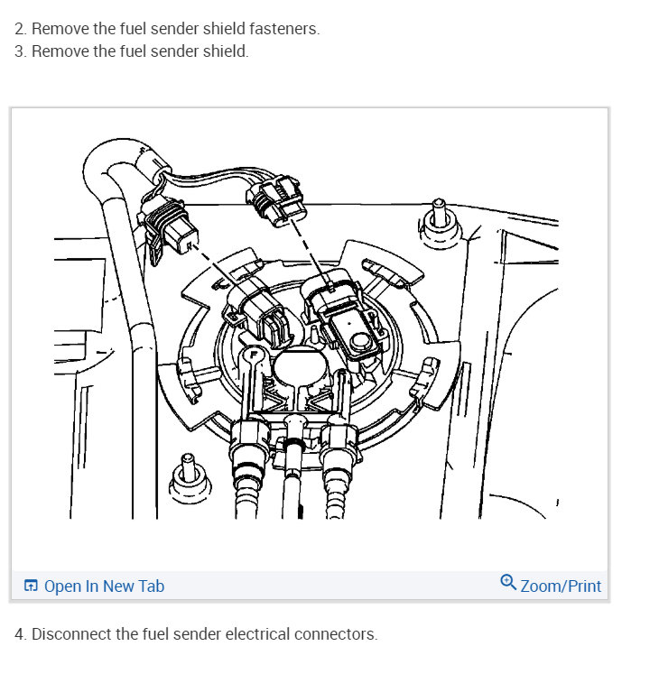

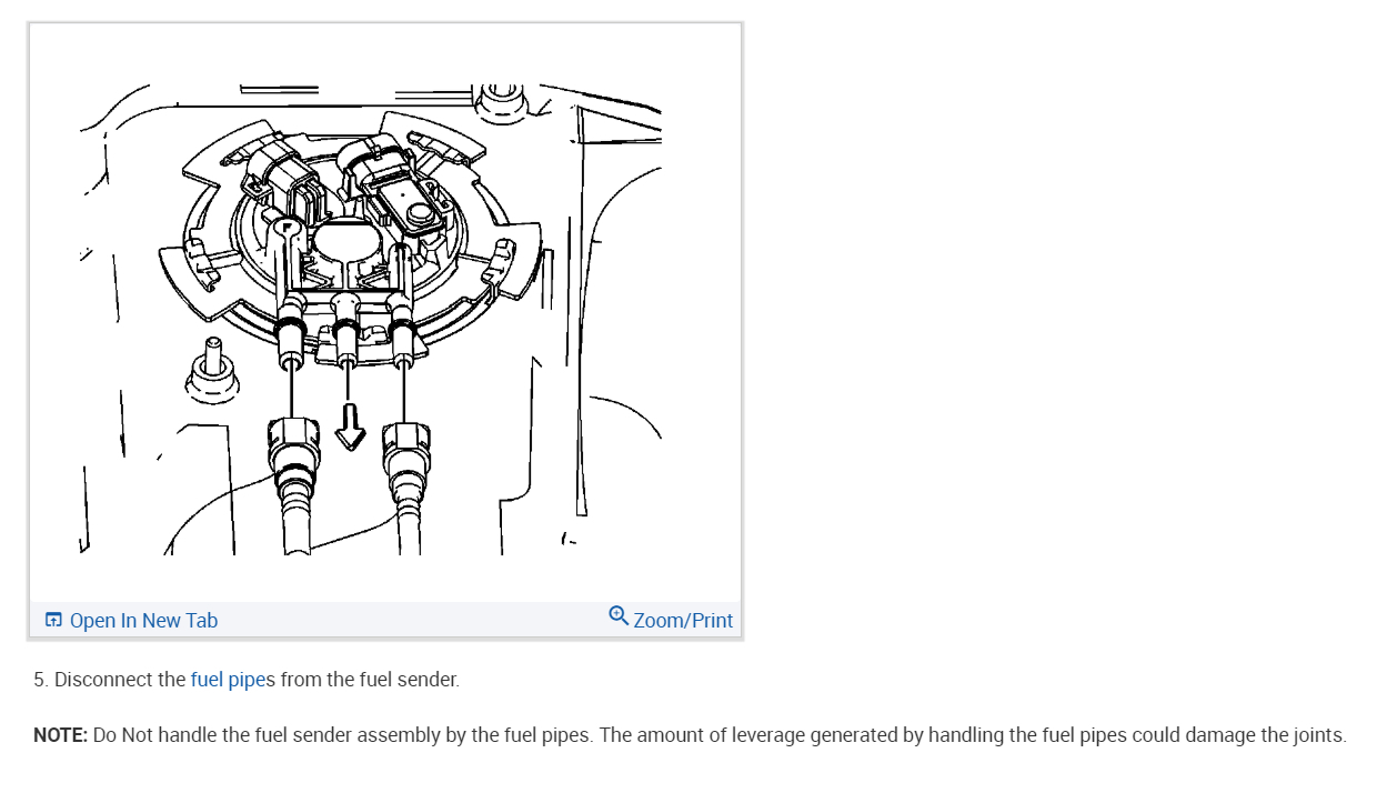

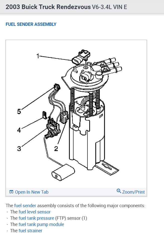

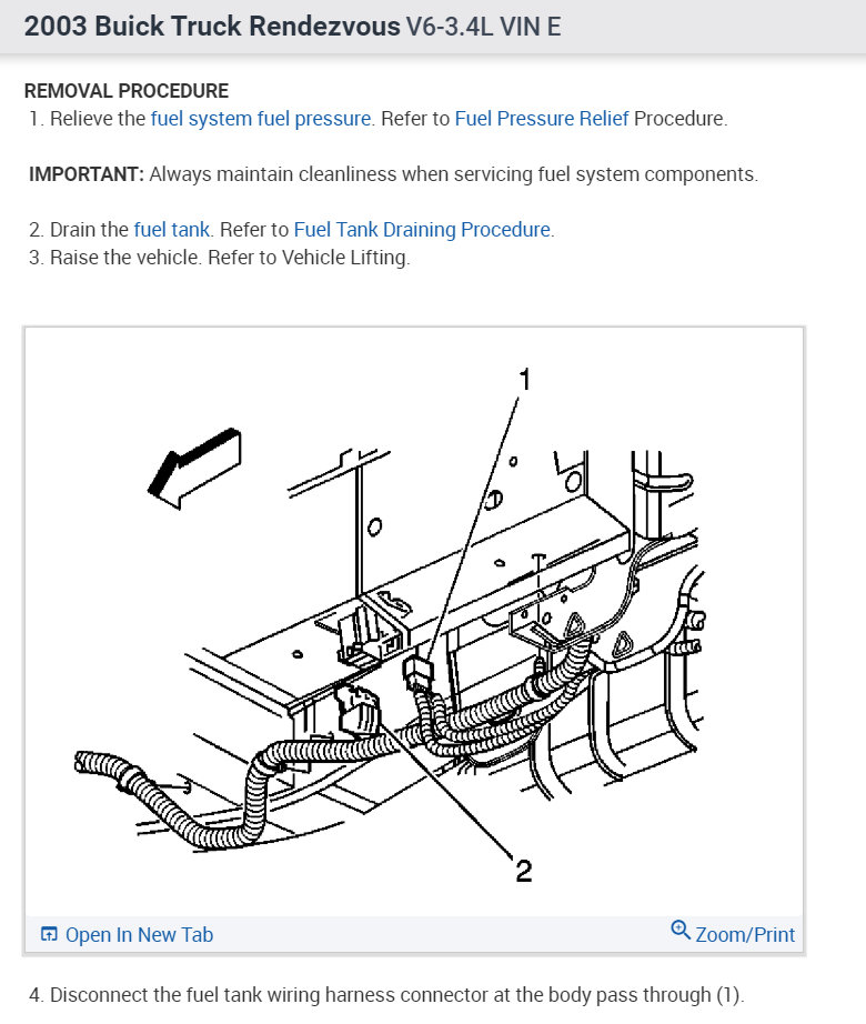

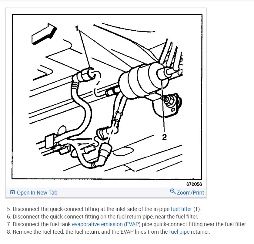

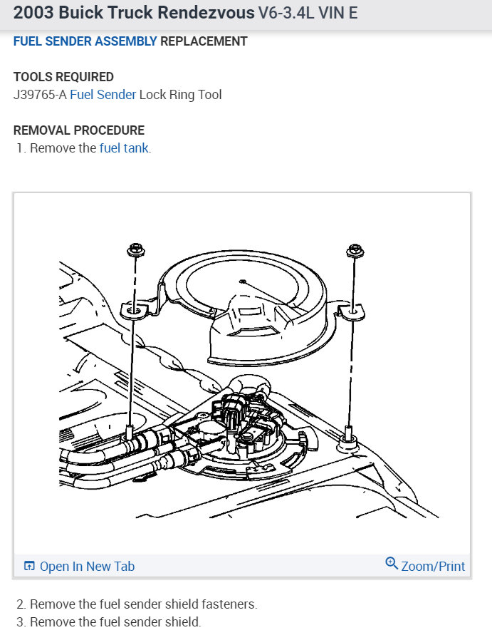

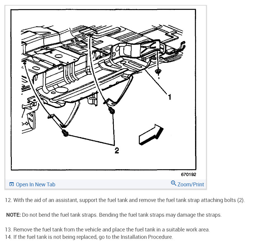

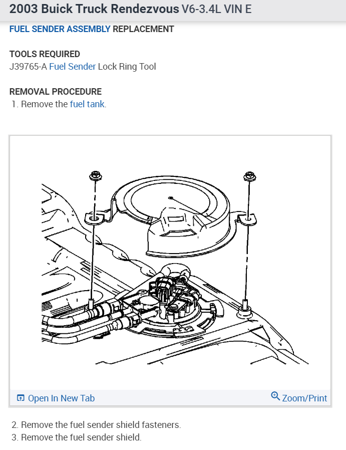

  • 55,433 POSTS
9 times out of 10 its the fuel level send on the fuel pump module. To be sure you can remove the unit and reconnect it with the key on to work the float up and down then watch the gauge. Here is how you remove the unit. Check out the diagrams (Below). Please let us know what happens.
