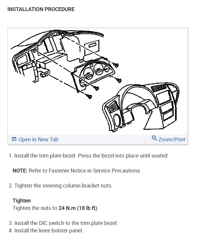

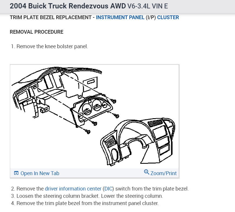

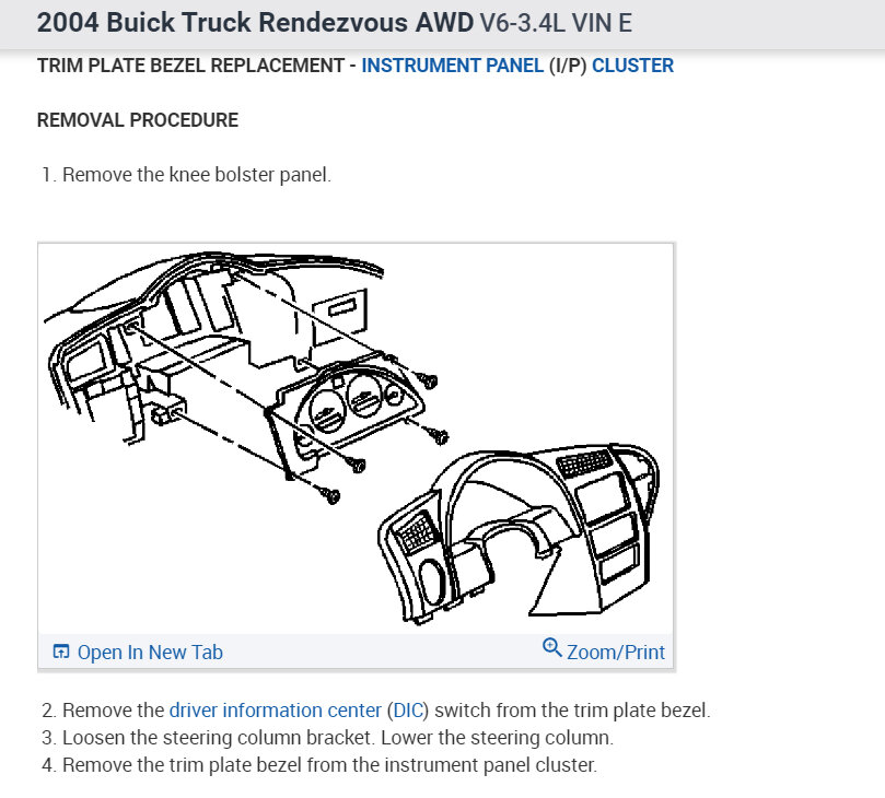

FACTORYJACK
  • 4,159 POSTS
If the needles habitually stick in place, in random locations, it sounds like a fault with the cluster, Here is a video of the job being done on a similar car with instructions below for your car, you can get a rebuilt cluster by search google or ebay. I looked for service bulletins, found none.
https://youtu.be/_HEC44xENxw
Check out the images (Below). Please let us know if you need anything else to get the problem fixed.
