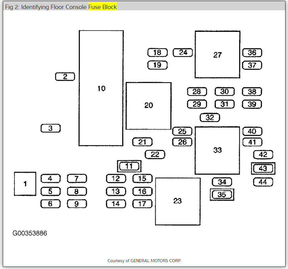

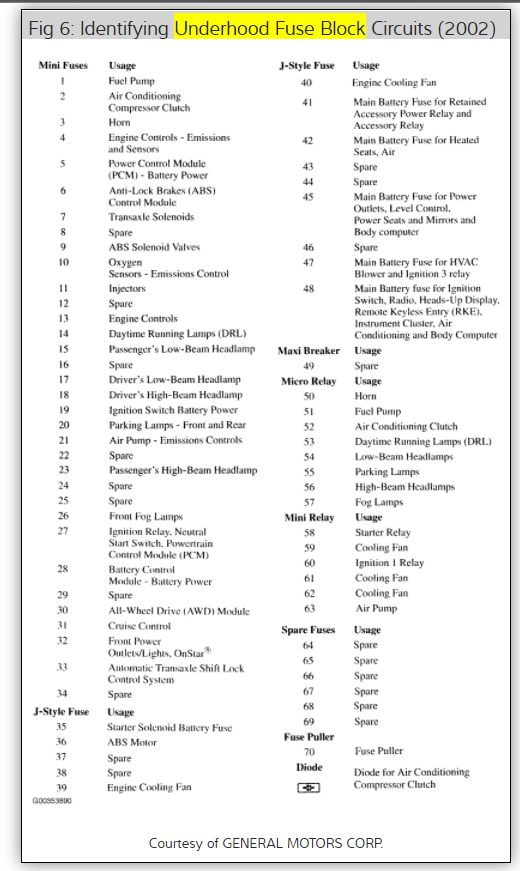

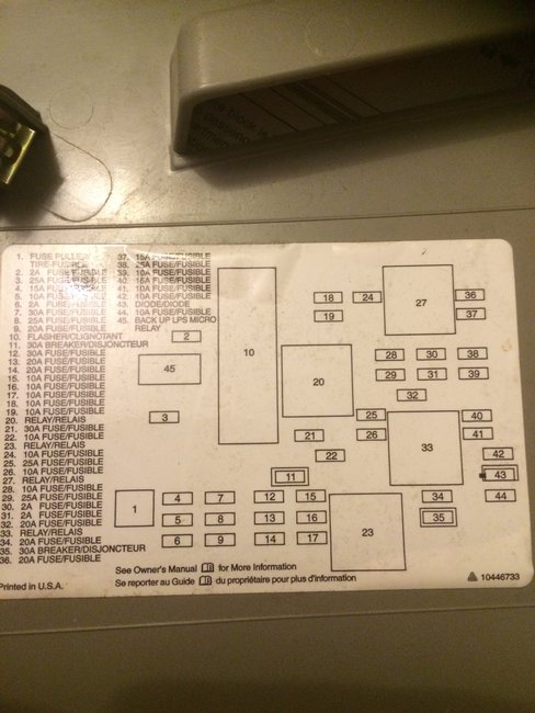

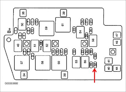

I would like to know which number fuse to replace for my cigarette lighter outlets?
Jan 16, 2010 at 5:02 AM
  • 110,244 POSTS

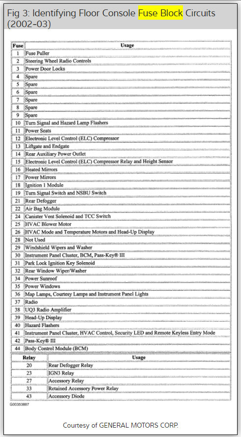

Here is a guide to help check the fuse #32 and the fuse location diagrams (BELOW)
Check out the diagrams (Below) Please let us know if you need anything else to get the problem fixed.

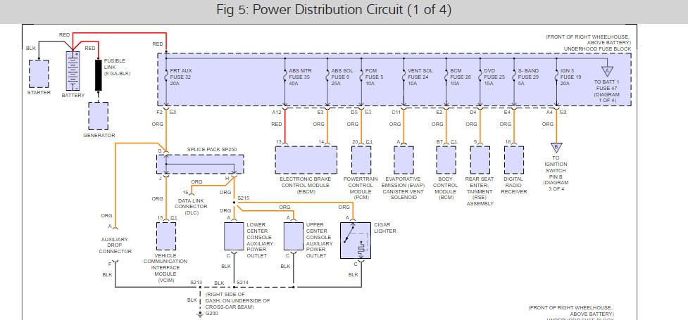

The code scanner plug has no voltage, also the cigarette lighter don't work. If a fuse is bad, which one and where is it located.

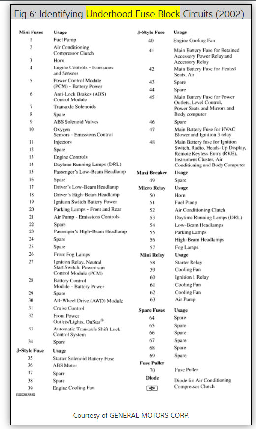

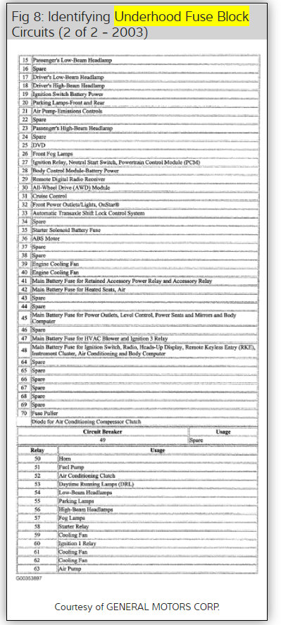

The cigarette lighter Fuse # 40 ( 20 A) in under hood fuse box. Here is a guide to help you test it.

Here is the location for the cigarette fuse #32 and a guide to help you test it when you find it in the diagram below.

Hello Thanks for the information, I show fuse #32, 20 amp, located under the hood right wheel housing.

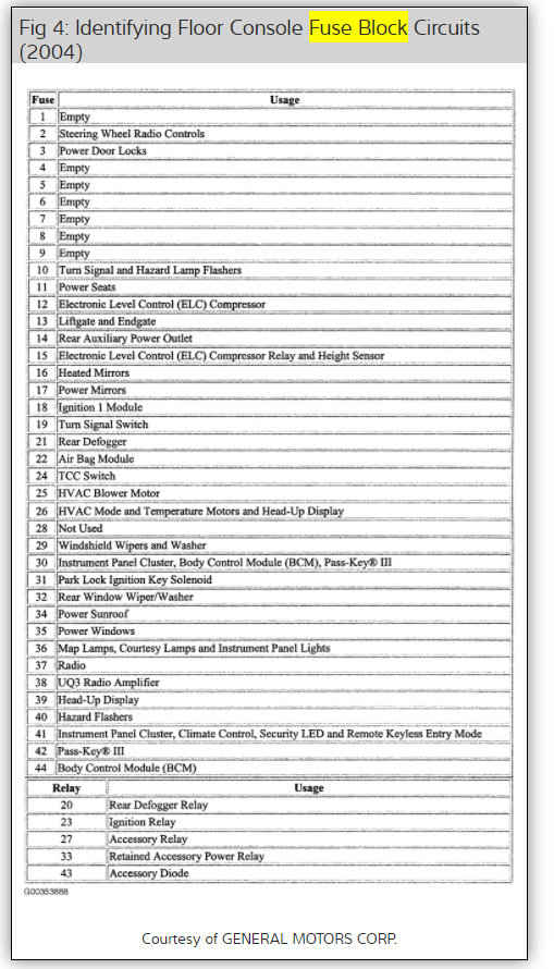

For the front - Aux. Fuse 32 (20A).

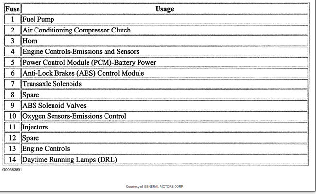

For the rear outlet - Aux. Fuse 14 (10A).

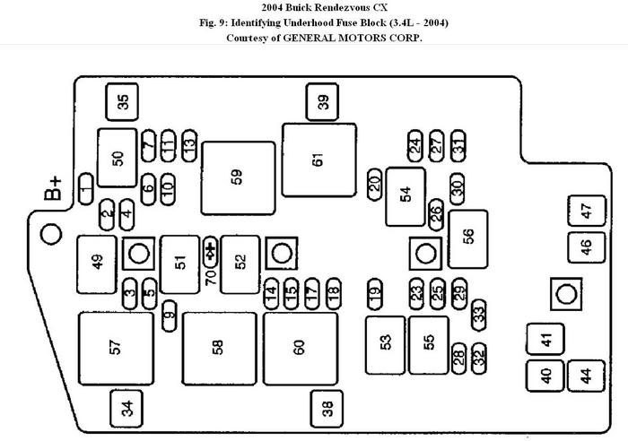

I have a 2004 buick rendezvous. I was changing the fuse for the cigarette lighter a couple of days ago, long story short, it isnt the fuse I need a new cigarette lighter. Can someone tell me how to go about doing that. Also, later the same day when I went to town I noticed my door ajar light was on. All the doors are shut. Played ring around the buick shutting them and nothing I cant figure it out. I locked it when I went in the store and the alarm kept going off. HELP! How do I fix this???

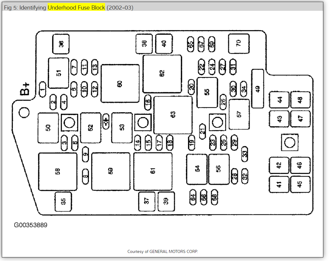

There is a fuse panel located in the right side of the center console.(down near the floor) There is another one located in the engine compartment. Here is a guide to help you check the fuses with the fuse locations and diagrams below.
