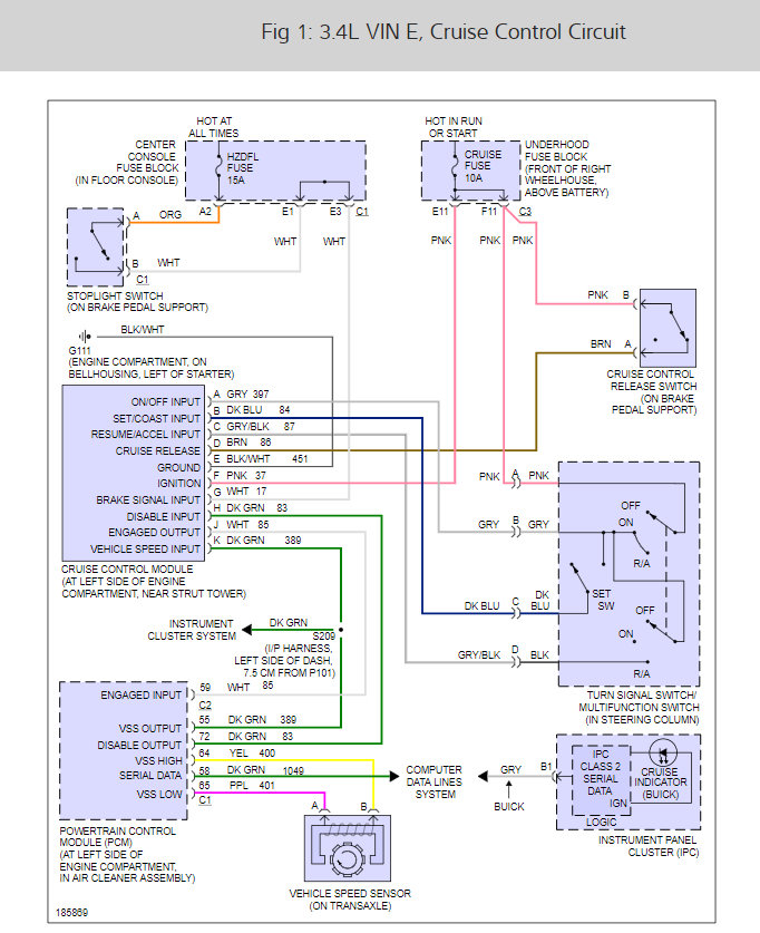

My cruise control isn't working and I've replaced the fuse. I ordered a manual for it, but really want it to work sooner than what it will take to get the book..help??

Items you can check are do the brakes lights work? stay on? and if you know how to test switches you can check the on off and set switches, but the system is PCM and EBCM controlled.
I have seen where part of the brake light switch stops working test the switches using this guide.
Here is the cruise control wiring diagram so you can see how the system works and what to test. Also the system run from two fuses make sure they are both good.

Hi, thanks for the response, the brake lights work okay and don't stay on when they shouldn't. So I checked the switches on the brake light switch and only part was working so I replaced the switch and everything started working thanks for your help on this. I love this site
