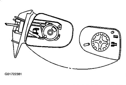

The passenger side mirror was pulled off the car (not the entire mirror, just the glass part with the plastic casing that sticks to the back of it.
We got the new glass for it, removed the old glass and now we are trying to get it back on the interior mechanism.
We thought it would just press on, however, it is not staying on.
When we use the mirror adjustment control the mirror will still move where we want it to go so there is no problem with that.

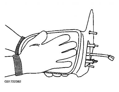

install the mirror face to the mirror motor with the palm of your hand on the center of glass, pressing in until its fully seated. it will take some pressure to do this, wear gloves to prevent damaging mirror.
