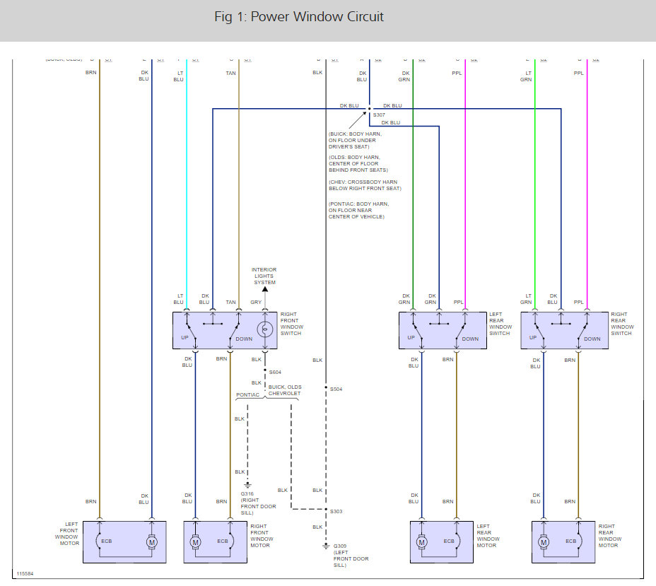

None of the windows roll down. When I press the driver side window it makes a buzzing sound. I checked the wires, there is no sign of shorting. The fuses and relays are also good. Has anyone ever heard of this happening?
I bought a hole new switch. It did the same thing with the new one.

It sounds like the primary switch (driver's door) is bad. Here is a guide that can help you check it. Is there power to the switch?
https://www.2carpros.com/articles/electric-window-repair
Please let us know what you find so it will help others.

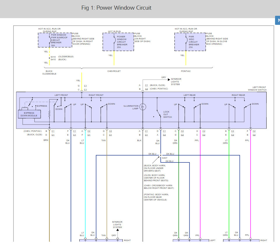

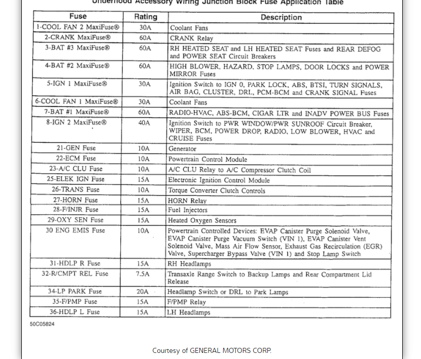

Here are the power window wiring diagrams. check for power through the circuit breakers you could have a bad one.

I did find the problem. I pulled the wiring out a pigtail at a time until I got the the main window switch on the driver's door. When I looked at the pigtail and all of the leads between the switch and the pigtail or part that connects the switch wiring to wires leading to the first fuse panel, I noticed the wire leads going into the little plastic connector had burn marks on it.
Ultimately, to put it in a nutshell if what I wrote is confusing (it was to me), the wires did have a power surge go through them and the fuse box did not catch it or blow the appropriate fuse. So, I had to replace all the wiring from the switch all the way to the engine compartment fuse box.

The pigtail is the wiring and connector coming off of the window switch itself and going through the door and into the passenger compartment. I have seen the circuit breaker lose power and cause the problem as well FYI>

Your window motors are not getting power. This is either caused by faulty / loose wiring at the switches or by faulty switches themselves. You need to check for power at the window switches and window motors. If the motor is getting power but not operating, it is faulty. If motor is NOT getting power than switch is faulty.

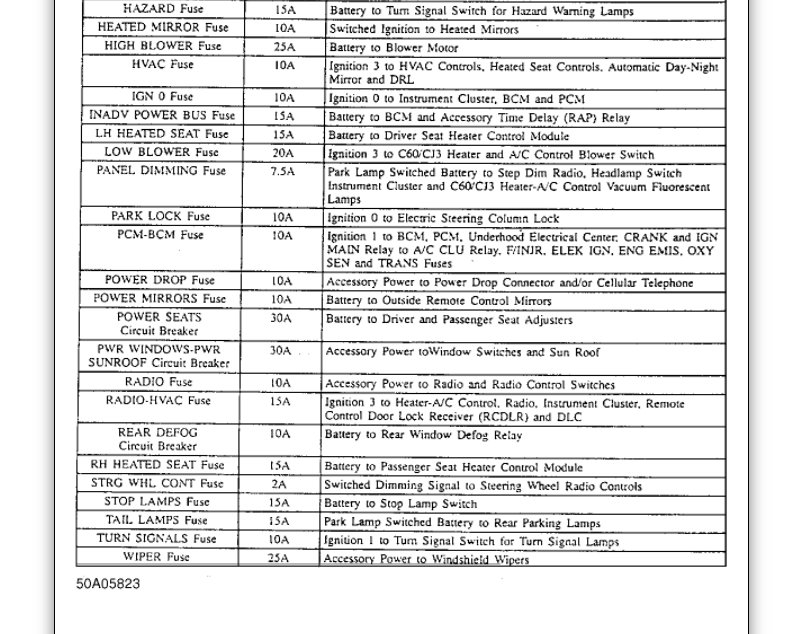

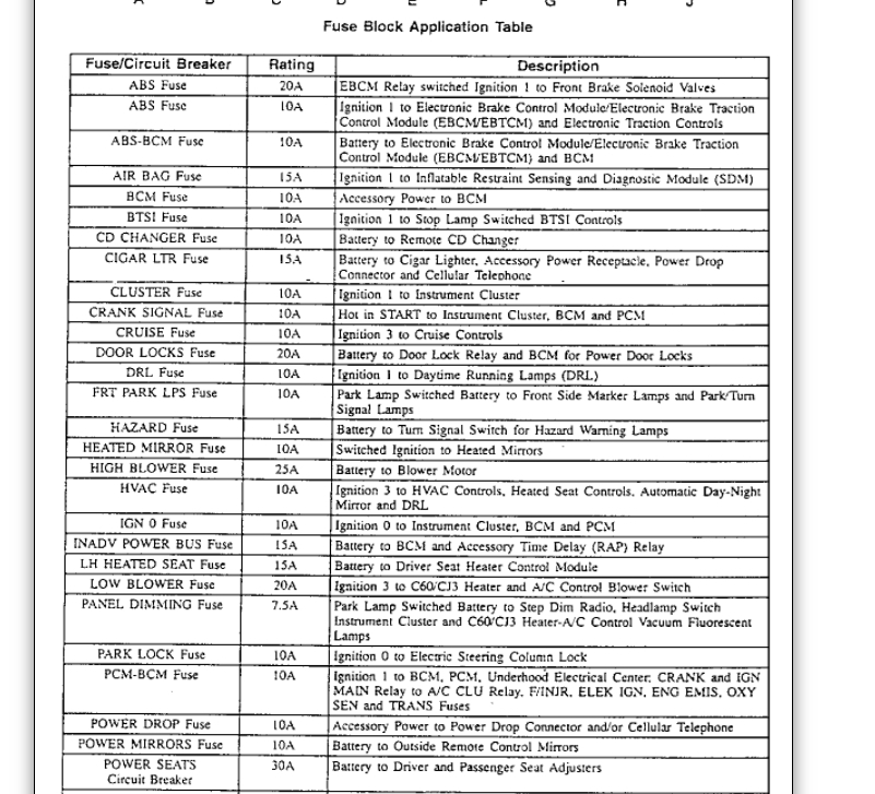

Check the power window circuit breaker, in diagram. When trying to operate the windows, is the circuit breaker hot to the touch? Also, Use voltage tester, should be hot/voltage with the key on.
Because the driver door is opened and closed so much, sometimes the wire breaks. Yellow wire is voltage, black is ground.

Hello, I'd pull the power window circuit breaker, use a testlite, check for voltage at the breaker terminal with the key on.
If you replaced the master switch, you should have checked for main B+ and ground to the master switch before replacing, maybe you did check that already?
