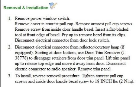

The rear passenger electric power window won’t work (lower or raise) the other three windows work fine.

remove that door panel and test for power at that window motor. if has power than window motor is shot.

Thanks for the help I'll do just that.
Now I need to figure out how to remove the panel without damage.

https://images.2carpros.com/forum/automotive_pictures/261618_Noname_2462.jpg
