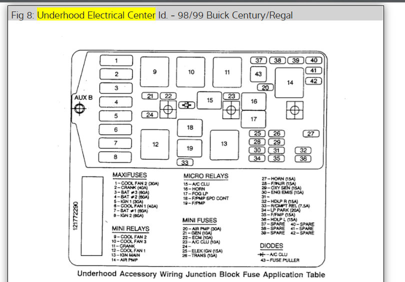

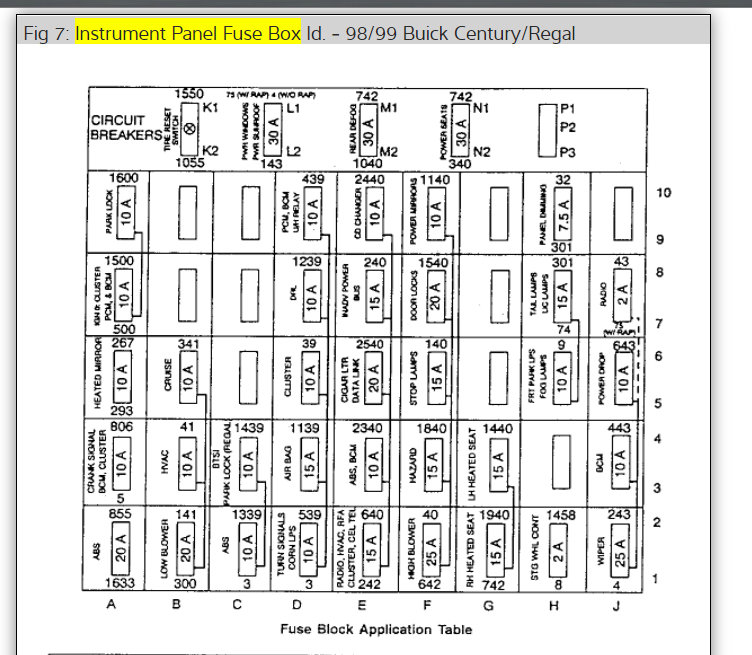

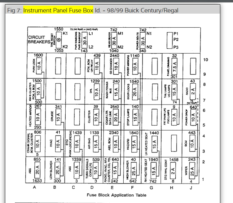

Can you tell me where the fuses that control my power windows are please?
Feb 25, 2010 at 10:33 AM
Experienced Mechanic
55,658 POSTS

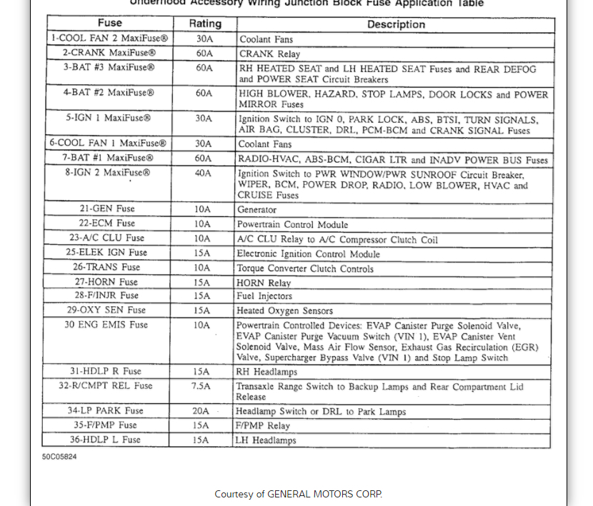

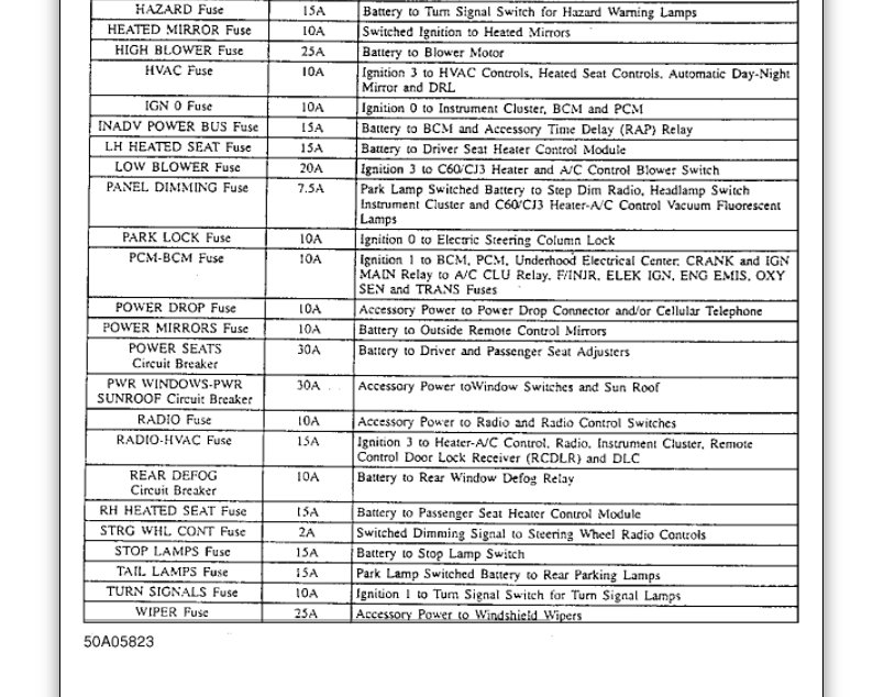

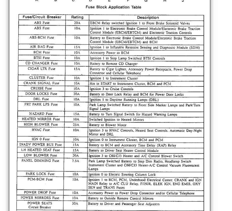

Check the fuse labeled PWR WINDOWS-(30 amp) located in instrument panel fuse block. Here is a guide to help you do some easy testing.
