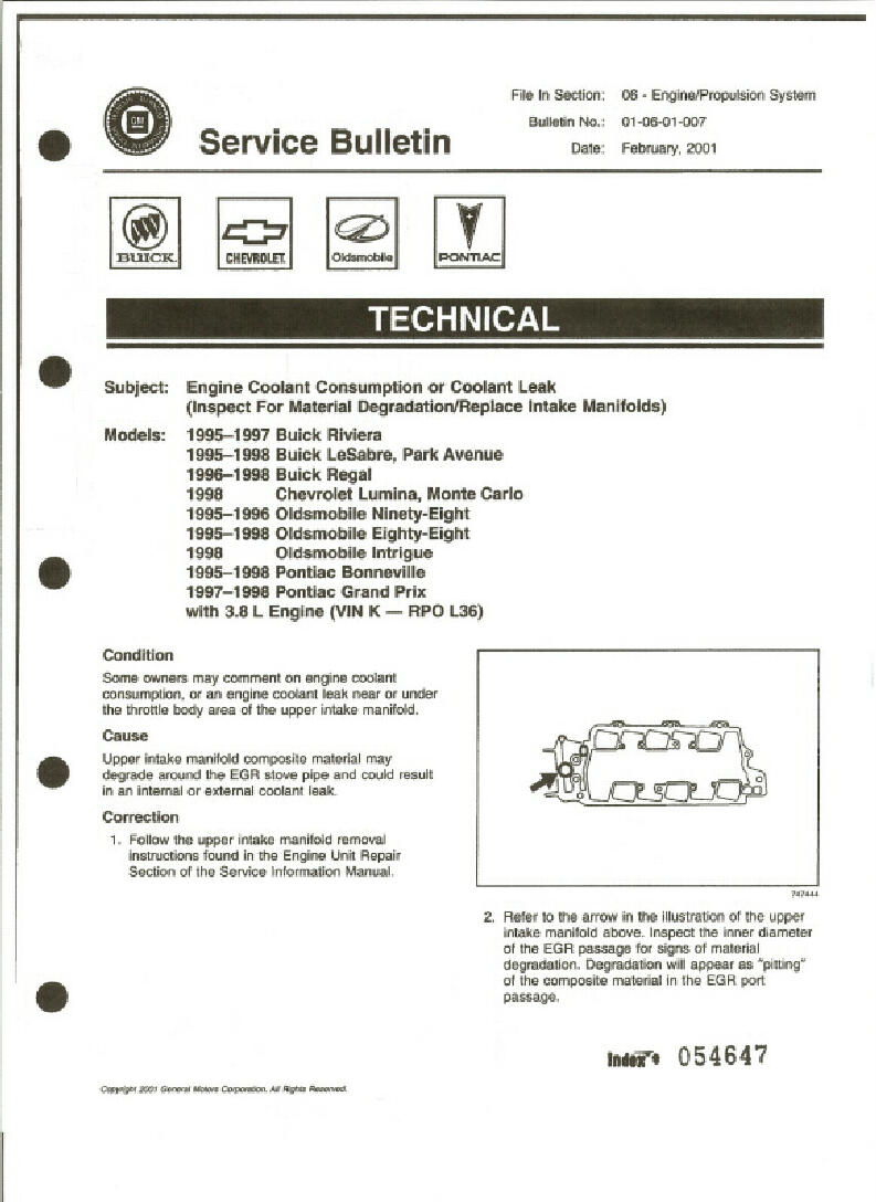

Car wouldn't start. Replaced 3 cylinder coils. Pulled spark plugs and they were "wet" with oil. Changed those and also needed to replace the cooling termostat. Car started (with a jump). Runs smooth but puts out heavy white smoke from exhaust. HELP! (The termostat had been taped for some time, I think that may have lead to the major problem. The car would periodically "cut out" when the air was going and it was on an incline but it never ran hot.
Tuesday, August 4th, 2020 AT 12:59 PM (Merged)
WRENCHTECH
  • 20,761 POSTS
White smoke means the engine in burning coolant. Usually the first suspicion would be a blown head gasket from overheating but this particular engine has a known problem with the plastic intake manifold deteriorating and leaking coolant into the valley and eventually into the intake port.
Here is a TSB on it.
KSHEA
Thank you so much for your consideration in answering my question. If this is done either intake manifold or the head gasket, do you know about what cost I am looking at? I really do like my car!
WRENCHTECH
  • 20,761 POSTS
The intake manifold job could run in the $500 range but a head gasket problem could run anywhere between $800 and $1500, depending how much damage was done.
